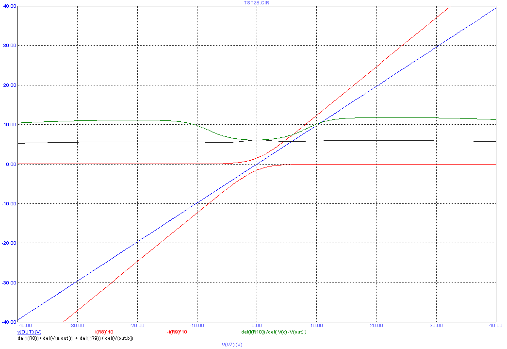

Wonderful graphs!
What did you use to create them??
I presume simulations were the source, or is this real amplifiers?

I just simulated it with MicroCap.

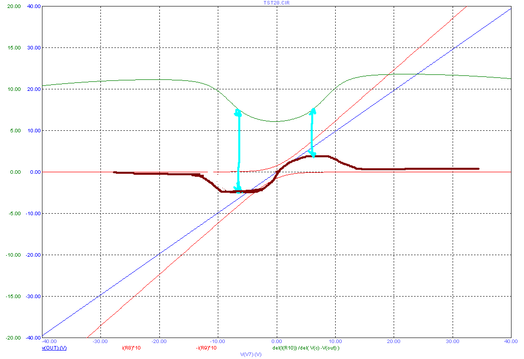

Now, let's plot this stuff and look at the black curve, which depicts the combined gm (of top and bottom tranny). Contrary to my previous post of gm, the green curve, this one doesn't show the 'doubling' at large currents. Instead, only a small increase in the crossover zone. This is because the circuit is a bit over biased (which is another story).
Despite the fact we have taken into account the effect of Vbe, RE' and RE, this kind gm does not explain the excess of distortion caused by a sliding bias.
Please tell me what I did wrong.
E.
The usual confusion between a small signal, linearized, and a large signal analysis. gm=Ic/26mV holds for small signal only. For large signal, Gm(0)=gm/2 where "0" stands for Vo=0. In fact, Gm depends strongly on the output level Vo (otherwise, for example, a bipolar oscillator would not work).
There is no simple way to calculate the large signal transconductance. The large signal analysis of an emitter follower with Re does not have any known analytical closed solution.
I wrote: gm ~=Ic/26mV and notice the tilde.
Whether this equation is correct doesn't matter, as I didn't use it for any calculation at all. My simulator did the calculations, which also takes care of large signal and other effects. And please don't start whining again about the accuracy of simulators. For the purpose at hand they are accurate enough.
The point is that the composite gm of the bipolar output trannies plus emitter resistors did not reveal the gm doubling at large currents. That means you can't use it for explaining the distortion. Perhaps you forgot it, but we are talking about the real cause of distortion: is it bias voltage modulation or is it gm modulation. According to my last plot (black curve) it is not gm modulation.
edit: the astute reader would notice that the 'green' gm curve does show gm doubling. So, wtf are we talking about?
Well, the 'green' gm has taken into account the effect of bias voltage modulation, while the 'black' gm does not.
