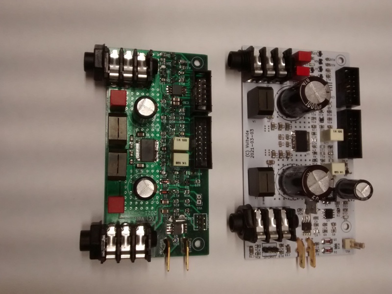

As long as you have proper local decoupling it's totally fine to use vias with powerplanes.
From the screen shot it seems that you can move all those passives over to the other side.
Or maybe even use the 3116 instead and move all higher parts over.

Agreed. I did some test with continuous max power output for several minutes without overtemp shutdown, so TPA3116 and heatsink can be omitted imho. Some slight improvement is possible using TPA3128 instead of TPA3118.
Oh yes, I haven't really looked into that one, although I just only saw a slightly lower quiescent current?

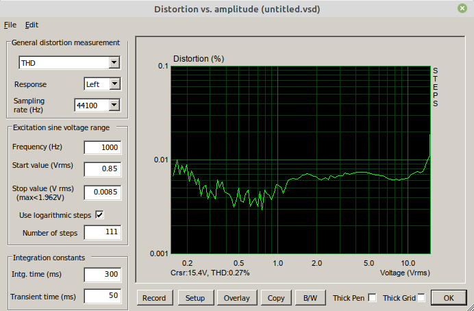

Some days ago the latest batch of PCBs arrived. So I populated my first 4-layer amp. Attached is a photograph of the previous 2-layer pcb (white) and the actual one (green). At first I measured 1khz THD at 5Ohms dummy load with 24Vdc supply.
