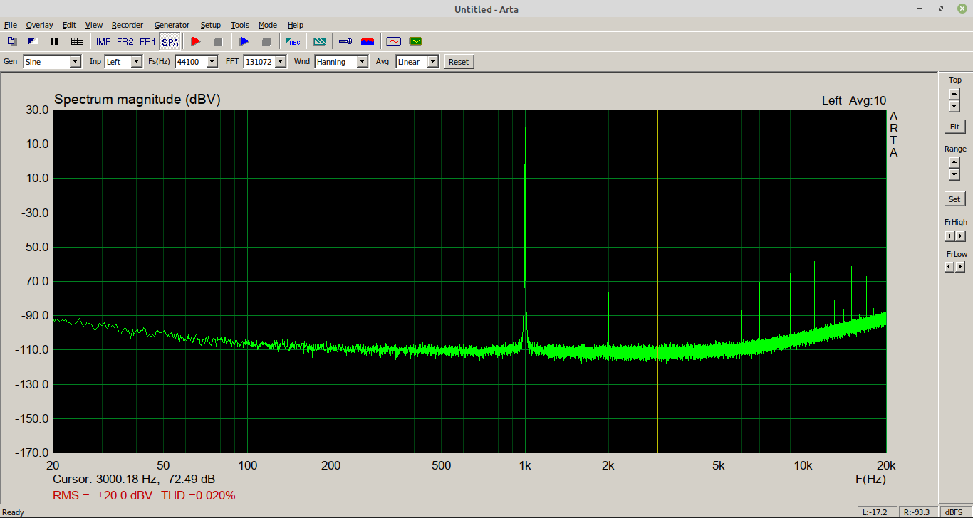

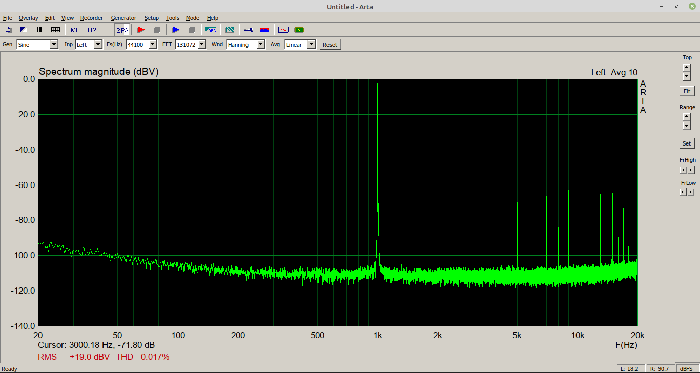

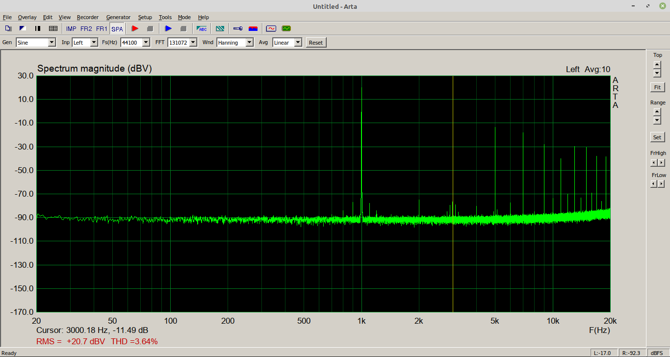

Meanwhile I did some THD-measurements with current PCB-version from 2021-03-03. My regular setup consists of an EMU-tracker soundcard, a 30dB-symmetric attenuator, 10R dummy load and a laptop. The DUT is powered by a lab power supply set to 15Vdc. The analyzing sw is ARTA running unter Linux Mint. These plots depict 1kHz THD at 10Vrms and 11Vrms output voltage reapectively.
Considering that 10Vrms correspond to more than +-14Vpeak this shows that hard clipping is very close to the supply rail voltage. I attribute this to the extra big output filter caps with 2u2. Earlier tests with TPA3255 showed that increasing output filter caps increases clipping level as well. Obviously this works with TPA3118 as well.

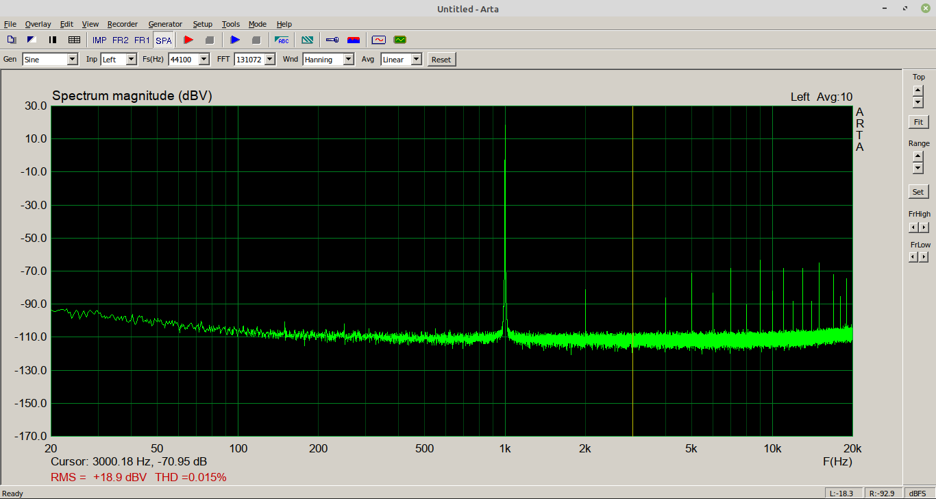

Measuring below clipping level at 9Vrms output gives these results with 5R0 / 10R dummy load respectively gives these results. Comparing
H1/H3 = 18.9dB-71dB = -89.9dB @5R0 with
H1/H3 = 19dB-71.8dB = -90.9dB @10R
shows no signifant difference with a load current changing by a factor 2.
This is indeed a surprising outcome that is contrary to common experience.
At the time I do not have any explanation for this.
As a side effect I conclude that the output filter inductors do not contribute significantly to distortion.
These are the same as in my TPA3255 boards and may be considered "oversized" for TPA3118.

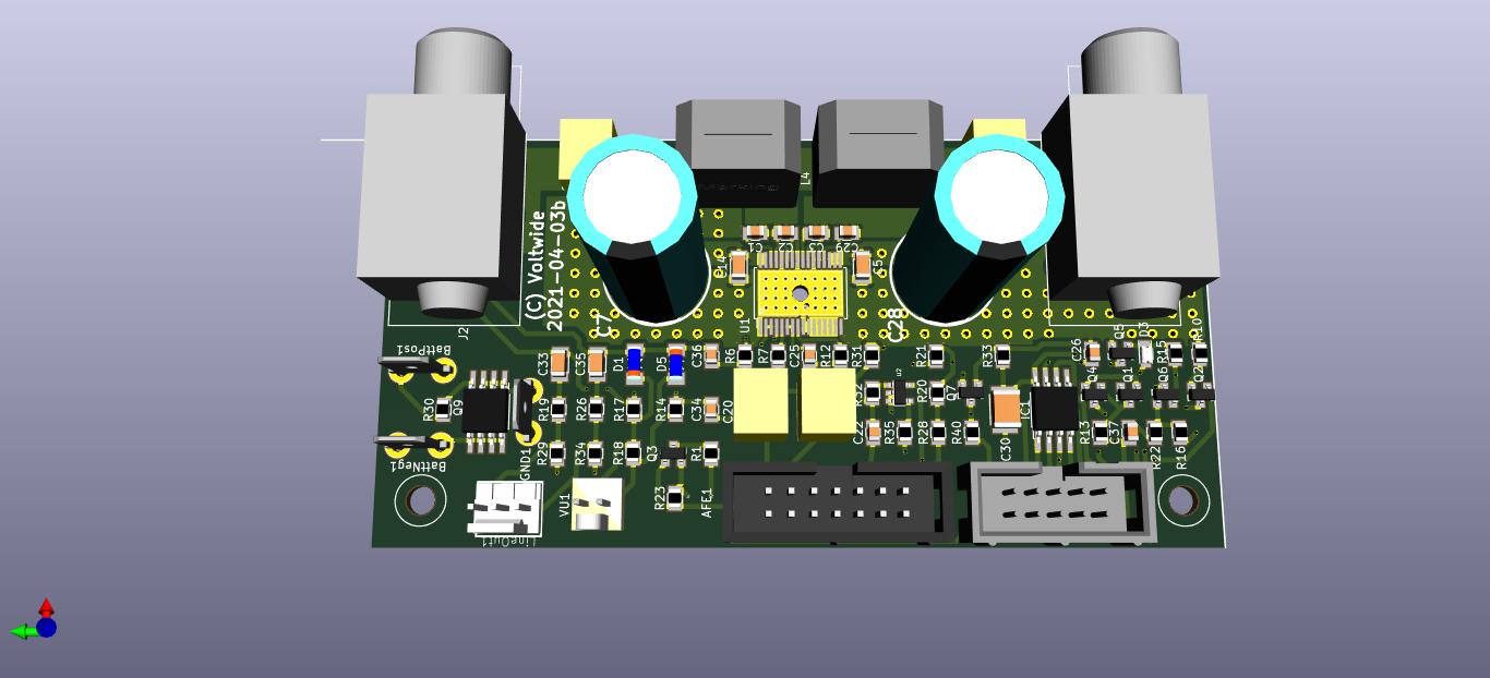

Meanwhile I revisited my current PCB design and plunged into 4-layer PCB the first time. So I can confirm this is a great step into better and easier design of such class-D modules. A batch of ten pcbs is now in production at JLCPCB. 😉
This is the kiCAD-3D preview:
Ha, great!
Looking good as well.
Since a PCB has two sides, what I personally like to do, is trying to put all SMD components on one side and all the THT or bigger parts (inductors) on the other side.
You will save a lot of space while still being able to let the board begin assembled easily.
I did this as well, but with a class-d it is essential to achieve low-inductance power planes - i.e. wide copper areas instead of tracks - which can be done better with 4 layer.
Btw - I do not expect any sensational improvement of THD to take place with the 4 layer design, maybe due to better symmetry H2,H4 drop a bit, but H3,H5 will stay. Anyway a revision was due for several reasons, one of them being reduction of size from 62x110mm to 50 x 100mm.
