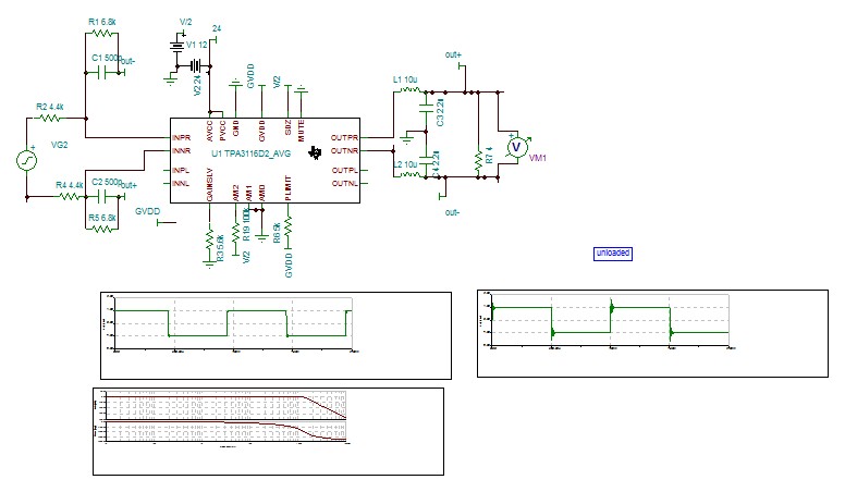

Meanwhile I scanned my archives and found my attempts of full audio range PFFB around TPA3118 in 2.0 stereo BTL configuration. This has been a trial and error procedure while playing with LTSpice and doing real world measurements. I did not find a solution working without a snubber - which was the no-go for me, so finally I dropped that idea. Anyway there certainly exists room for improvement so I upload some simulations and the power amp circuit to play with.

This is interesting. As the gain setting is minimum, there may be some more room for improvement. Be aware that you simulate with a non-inductive load. With series inductance stability tends to be more critically.
Low gain is not so much of an issue, although having a least a gain of 2x (6dB), would be nice because otherwise you're asking a lot from the previous buffer stage.

By modifying slightly your circuit, you can apply a true feedback after filter and decrease the distortion by 9 fold. I left a gain of 1.2db to have full excursion with driver opamp drop out.
Nice idea, but how is the stability?
I can imagine a bit tricky with so much feedback.
