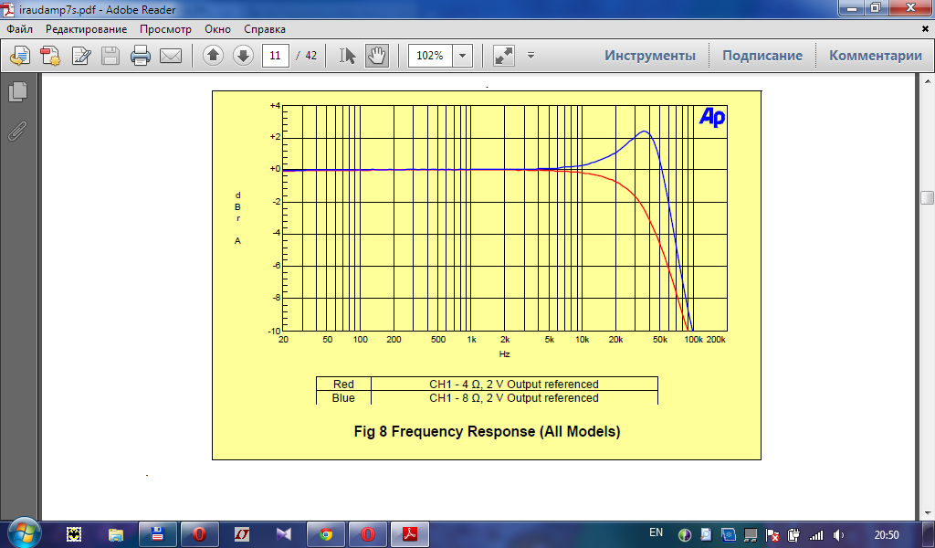

Eva is that really you ? oh my word. where have you been ? soul searching? welcome back ! 🙂
Maybe , if the inductor is included in the feedback loop. But when not the criteria is a flat frequency response , look at Iraudamp7Additionally, other interesting output filter design criteria is to move inductor value towards the inductance needed to achieve resonant switching when the amplifier is idle, this saves idle power.
