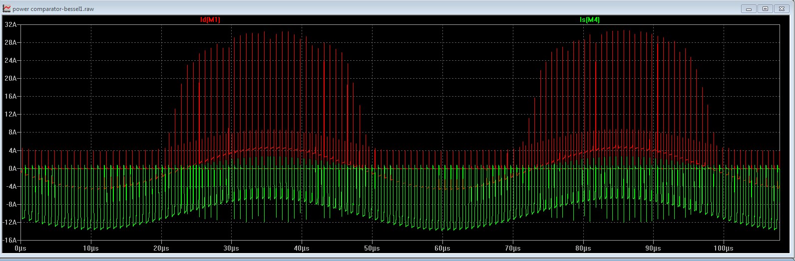

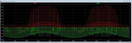

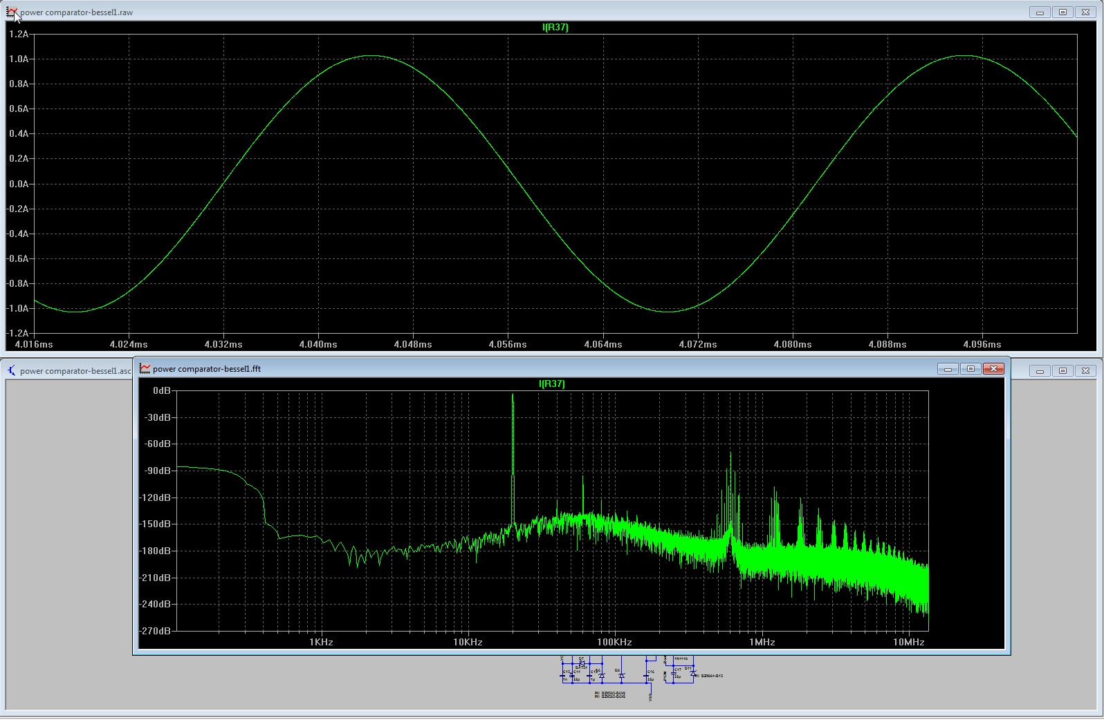

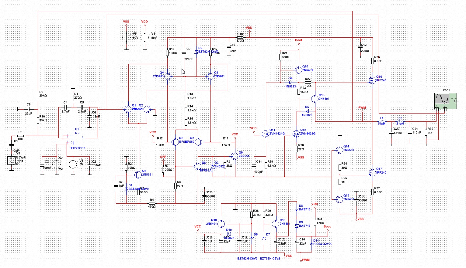

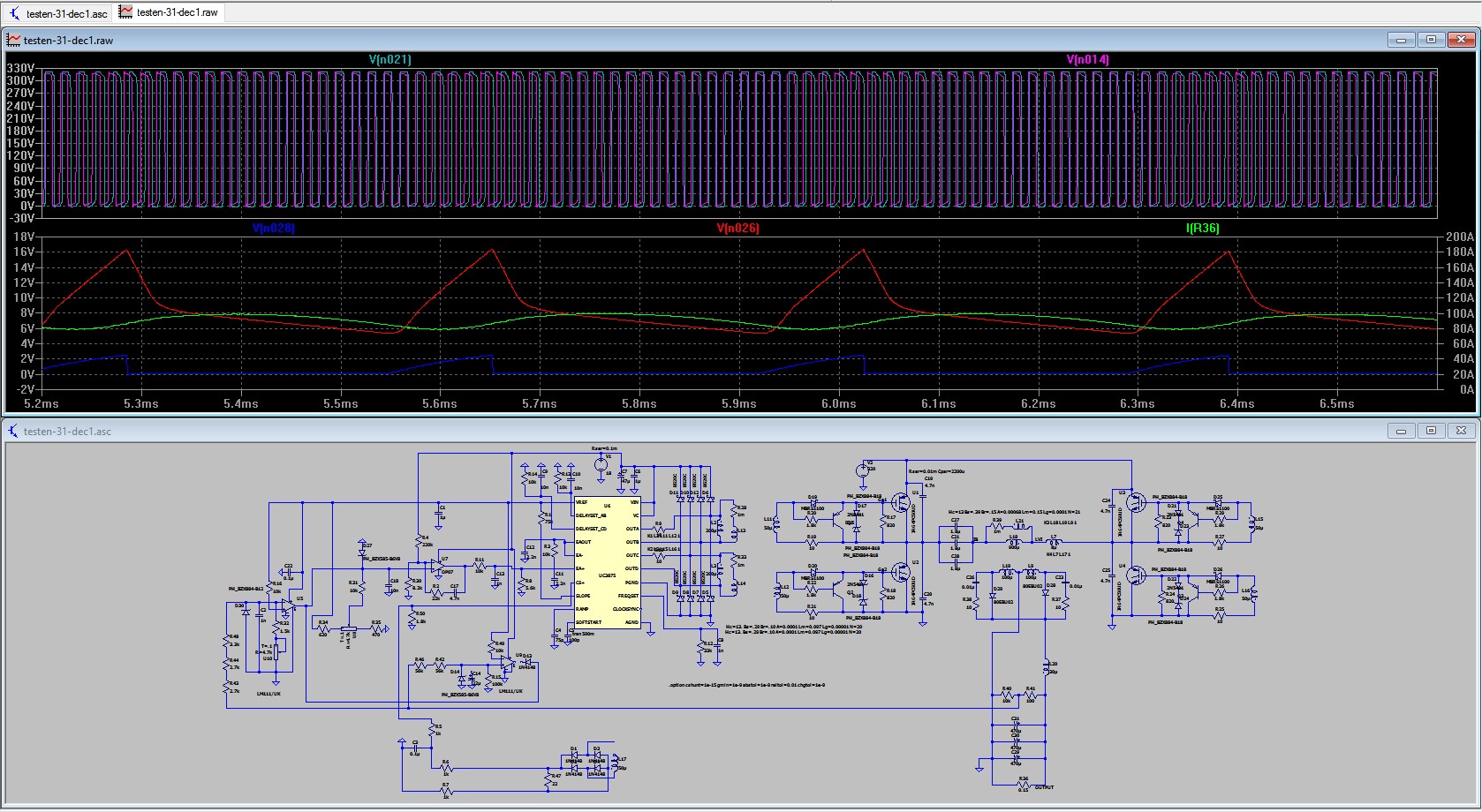

I did use the IR model from @analogspiceman, however I get uge shoot through, because in that model I do not see adjustment for death time.
Maybe someone here? has tips.

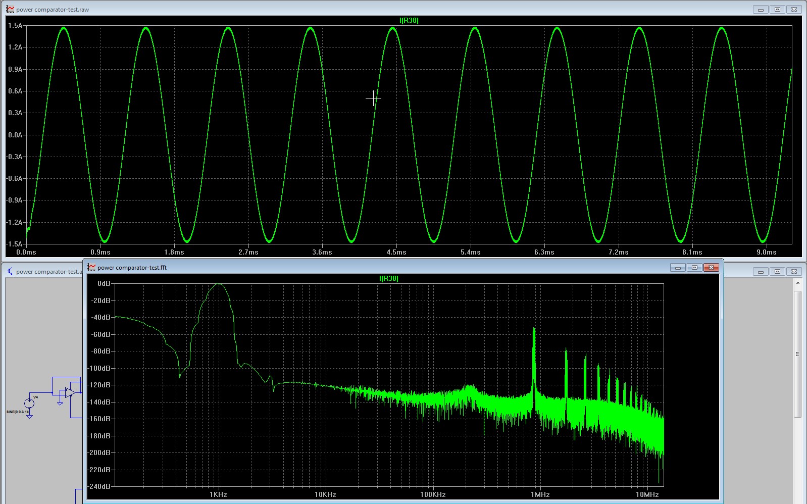

Last photo is from the discrete comparator with hd correction with a multipole lowpass opamp, it get in sim to -100dB, in real? I do not now but test someday.

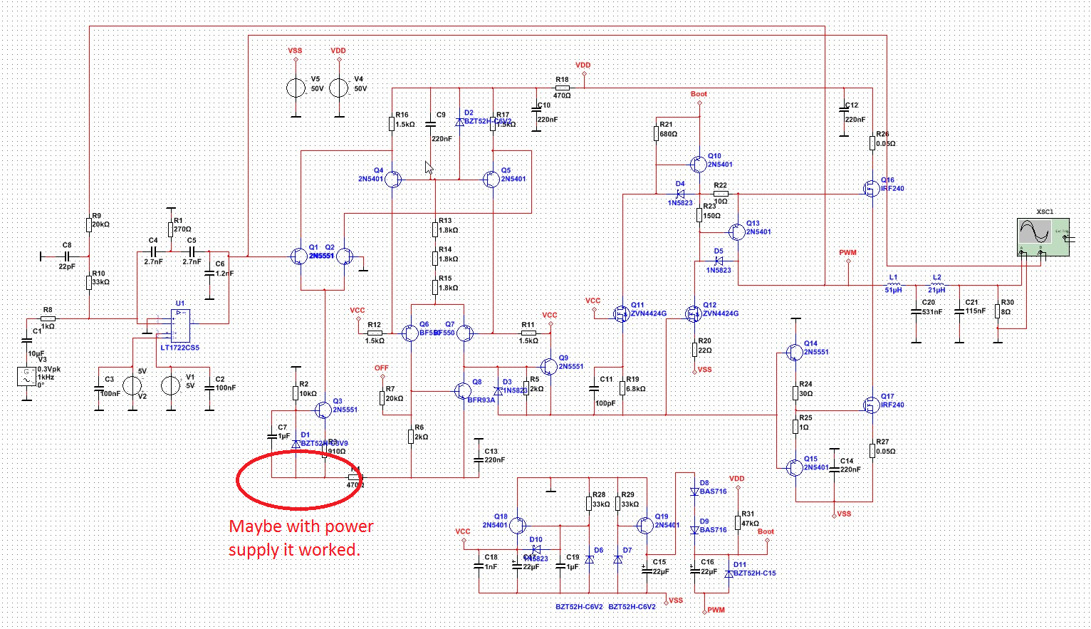

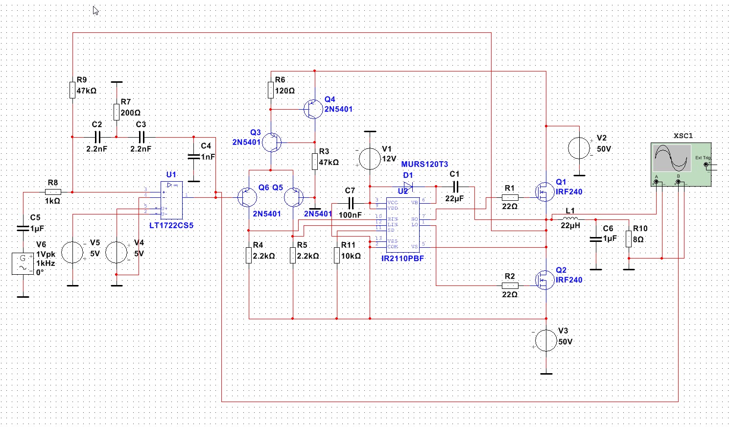

I don't suppose you've checked the datasheet for (for example) that IR2011, have you?
If you did, you would've noticed there's clearly no dead-time adjustment (and it's DEAD-time, by the way).
If you want dead-time, it needs to be created before these driver chips. A 74HC86 and a couple resistors, diodes and caps are enough.
PS: You really want some anti-parallel diodes across those gate resistors (to help turn the FETs off quicker). It will definitely help reduce cross-conduction / "shoot-through".

I have did sim with IR2010 I have peak in the datasheet and have not look better. I need a driver with dead-time. (hmm I learn english also).
Thanks for the tip.
here is a link to one.
http://omapalvelin.homedns.org/electr/pwm-deadtime-gen/
For as you people do now more about class D then me, I would like to hear why the dead-time of this comparator do act so bad, I have raise the gate resistors to 150 ohms, and current do drop, also when I put audio inpu on zero, the oscillation do stop, it starts again with audio input on 0.1 volts.
For as the chip, I do go search one who as onboard dead time setup, is so much more easy to make a pcb when things are in the chip.
On last picture it looks the comparator is quite fast even with 150 ohm gate resistors, better fall time then rise time.

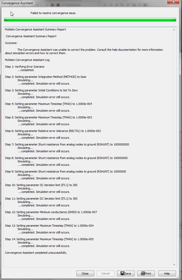

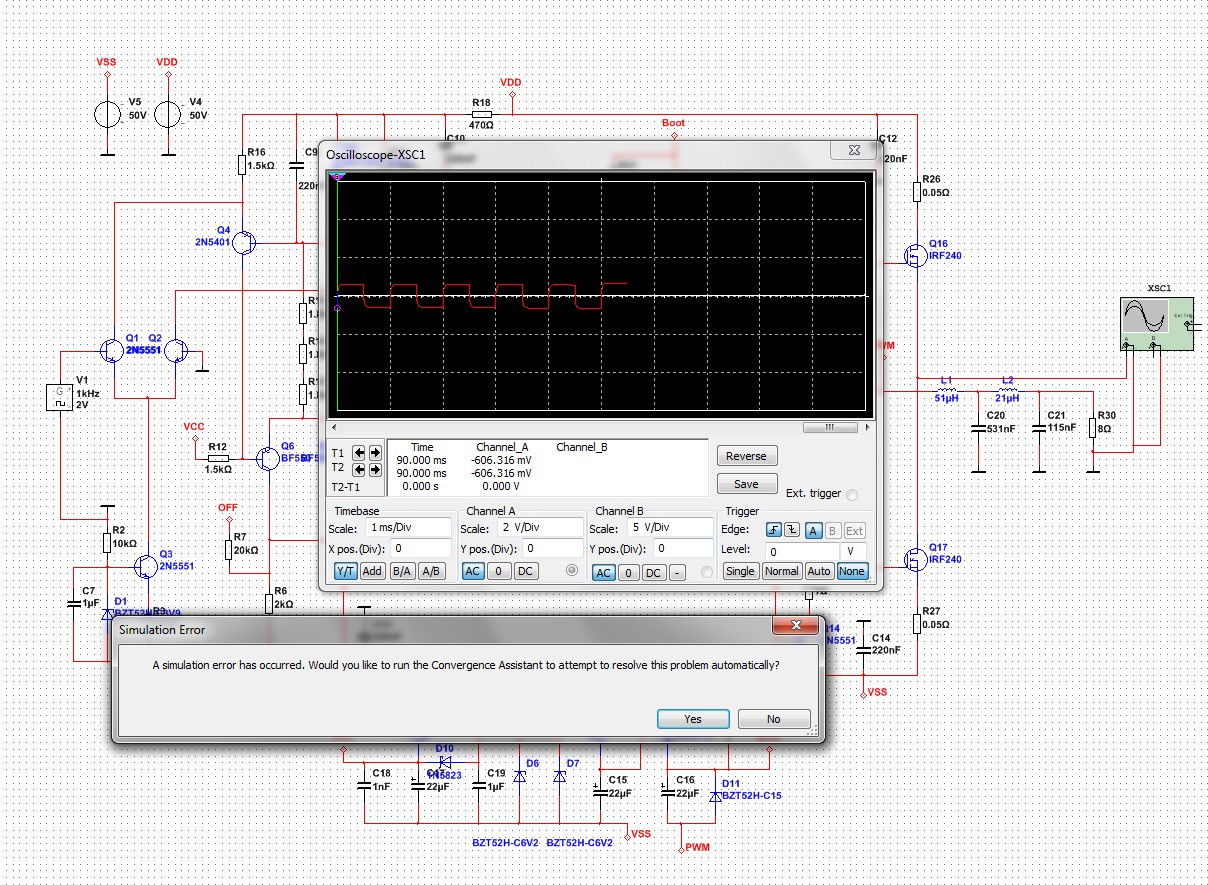

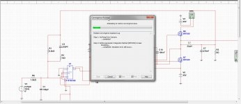

Have try some sim in multisim who has a lot of driver ic,s models, but non do work as in LT spice, what is the reason of that? only the @analogman do work.
http://www.irf.com/product-info/audio/classdtutorial606.pdf
the schematic do work in ltspice with analog model, but not in multisim and also the others in ltspice do not work.
The discrete comparators do work fine in sim, why the chips do not better i do not understand..

They are good. Read them! Can you find anything contradictional to my statement about noise of ultrafast comparators? If yes, then quote it! I bet the authors make noise measurements somewhere, some time, but where can you see it in the papers you linked?!? Where can you find noise comparisons for different speed comparators? Or any other sign that shows ultrafast comparator superiority over simply fast ones?
Did you notice that the kemp design demonstrate the usefulness of a nonlinear (predistorted) carrier??? (In contrast with the TI design, what is optimised for only a plain modulator having almost no delay, no power section and obviously no post-filter feedback, and still did not reach a quite good performance.)

No even discrete do not work, I get errors and if automaticly solved it do nothing, multisim is not good for digital simulation, is buggy also, orcad Pspice is much better, and ltspice also, Tina I have never tested.
Digital technology is and stays critical when simulate it.
The schematic is the same as I have in LTspice where it do work fine.
