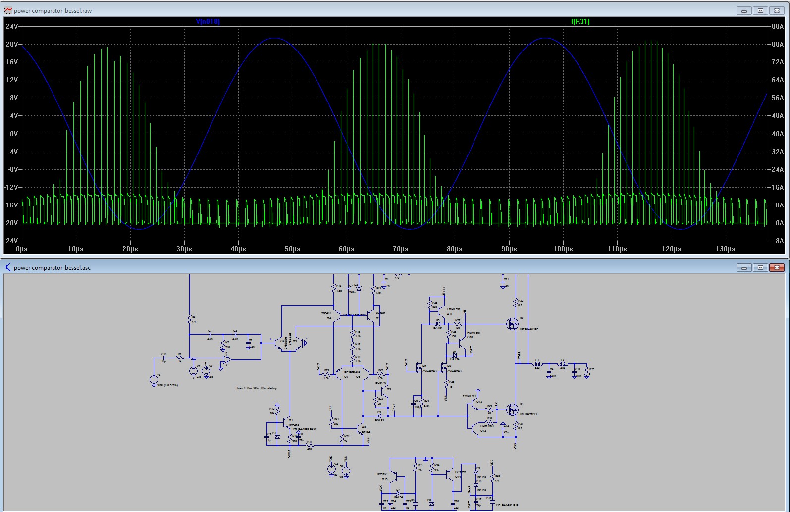

This is a fast power stage transition.
But actually fastness is much less important than precisely 0 dead time.
15 Ns is indeed very fast fall time.

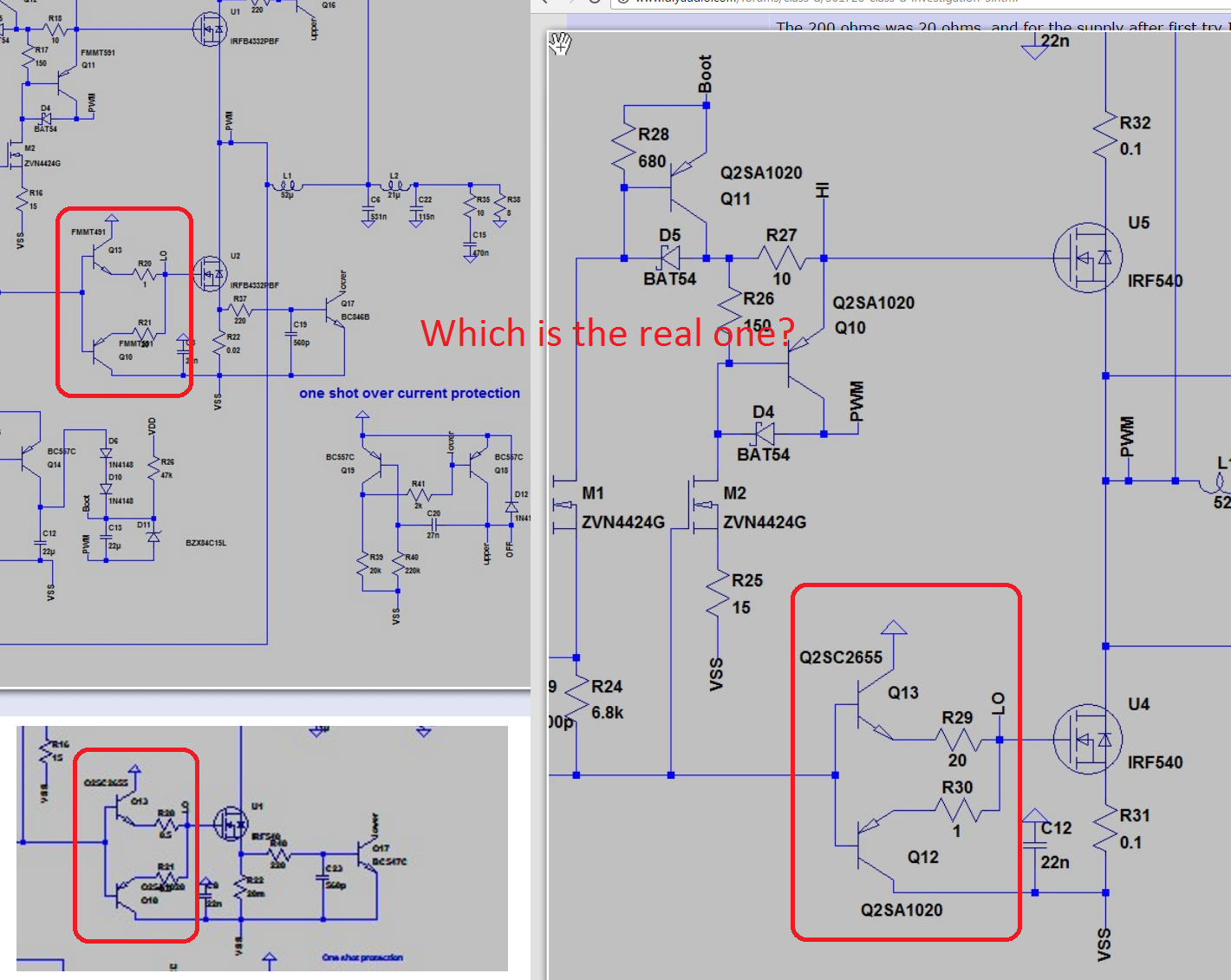

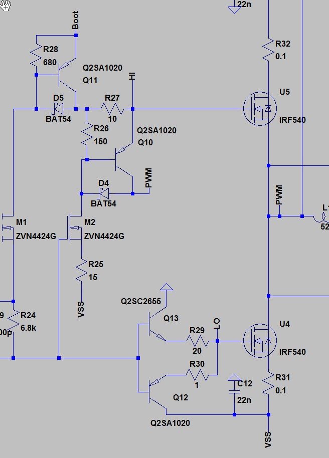

Gate resistors with invisible values on your picture. Don't you want to give chance to correct the mistakes?

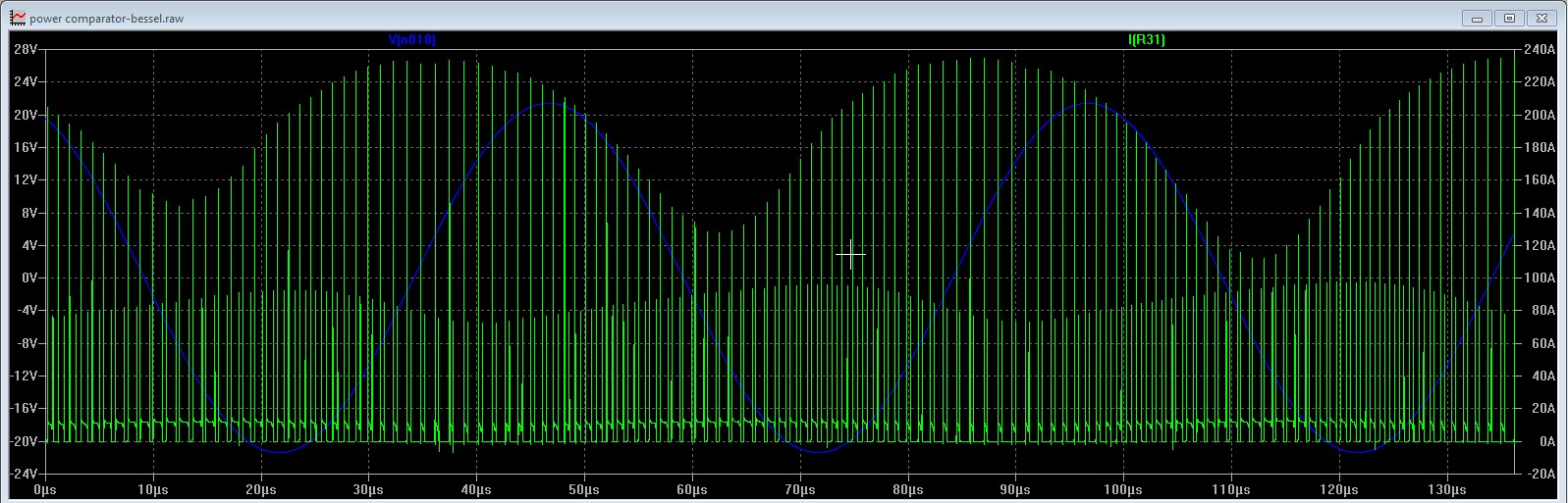

I don't think some blown parts was a problem during experimentation, but lets make some basic calculation:
Normal output current can be 40V/8ohm=5A. You must set higher current limit than this. Cross-conduction current (flowing from +40V to -40V) must be smoothed by decoupling caps, and your lab psu can limit the average value of it. So the maximal possible idle dissipation will be 80V*5A=200W. Will IRF540 survive? Maybe.

For as the article did say about death time, changing the resistors did not do much in simulation, you did mention a while back that the 200 ohm resistor has to be swapped.
200 ohm? I don't remember anything like this.
I think you should try to understand how dead time setting works. "Did not do much"? What do you mean? Did you try to change charging resistor to 50 ohm and discharging resistor to 1 ohm and cross conduction current didn't become much lower?
Lets assume this is true. So...?The power comparator has very fast rise and fall times.

Let,s do something make clear for you.
The 200 ohms was 20 ohms, and for the supply after first try I have a normal supply also 2 x 55 volts 10 amps to try, and maybe you are right the supply do not work with switching amps because it is completely different.
Has you not see the schematic? of the comparator? it is here in previous post where you mention about the gate resistor setup.
Death time is just a delay, between both mosfets as I also have in the smps supply simulation, it is however a part of the controller and easely to setup.
I know. But 200 is not 20. And you also told you've already swapped it back, and it made operation better. So this is doubly contradictional.
I don't understand anything about this.
I've seen. The original one with the swapped values. Also seen your screenshot with INVISIBLE VALUES (however it was NOT in previous post, nevermind). Why I have to write everything twice or more???
Thank you for finally showing the gate resistors, but it is different from everything you showed before, so i still have no idea what you actually simulated.
It's not time to death. Please don't die! I have no idea what do you mean "it is just a delay", and if it is easy to set, then why haven't you done it yet.
I guess you have absolutely no idea why dead time is important for ClassD. It is the most important factor for linearity and efficiency.

This is the real one, I have put part value in it where it can not be seen properly.

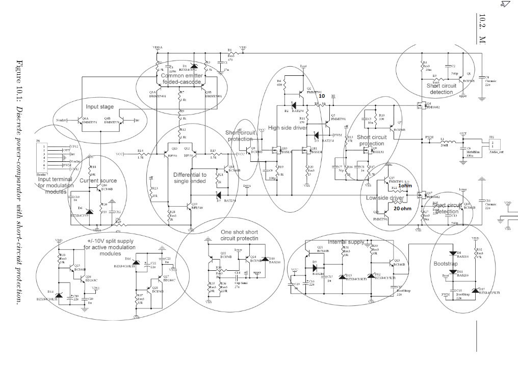

The original schematic in the article is clearly visible, no need to write on it anything. But 2 values are swapped. I write this for 4th time.
The visibility and consistency problem I wrote is about your simulated versions.

I have already swapped them as you did say, but for death time, it also slows down switching when use gate resistors for it, it forms a low pass with the mosfet, so when low gate capacitance the resistor needs bigger.

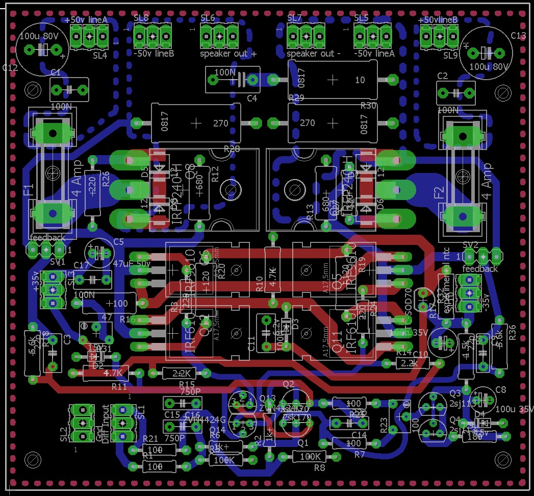

But first I go on with the circlotron one, later on I go experiment with class D because I have heard bad things, but also very good things as it sounds very sweet, the only way to get convinced is build one coming months.
I did smps builds, last was a 160 amps welder inverter, and winding the transformer was the most challencing, so when I can build smps I shure can build class D.

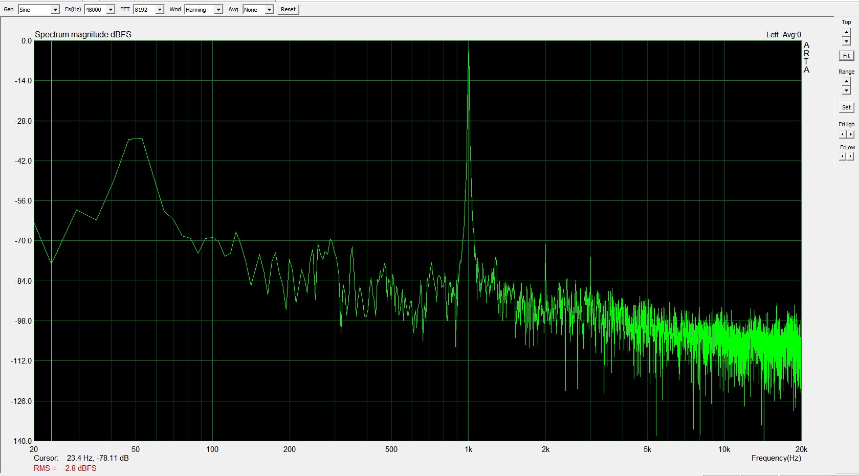

I have ordered a pcb for that, I need go from balanced to unbalanced, and a chinese board will do, with some more changes I have also a floating probe for scope, that come in handy.

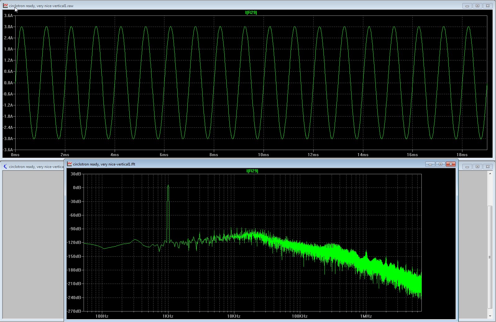

Arta with output 20 volts peak (one half of circlotron so it is 40 volts) and 8 ohm load, with capacitive load it do not change much, just some 4 dB more hd.
But need a good audio card because this is with the pc board chip.
Obviously. This is how this kind of dead time setting works. This is why I set dead time before gate driver.

Why do you think your soundcard was not good enough? Have you measured its own distortion?

The card has low distortion but one input is not oke, I have now a differiential pcb for meaqsuring the ciclotron output, single did not work, dc was the cause.

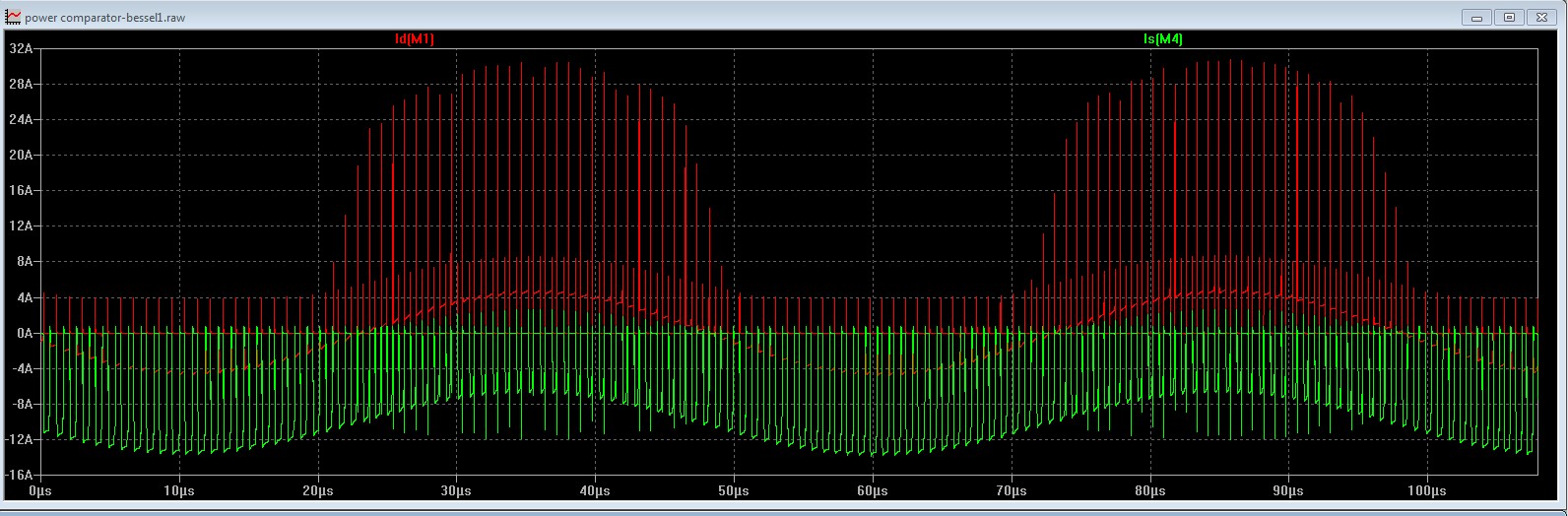

By the way I have experiment with the death time and shoot through, also I did some tryouts with a chip IR2110 with ot pcb design is quite more easy because much is in the chip itself, however I have get it not to work I think the pspice model is bad, so if you guys have one model of a fast gate driver, can I get it, thanks.
Pictures is with differend resistors, the best and lowest has a 200 ohm one, however the speed get affected who is normal when rising a gate resistor forming a speed reduction with mosfet capacitance.

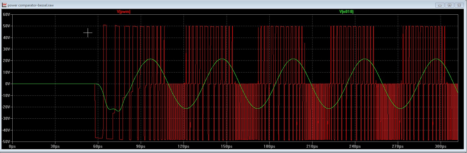

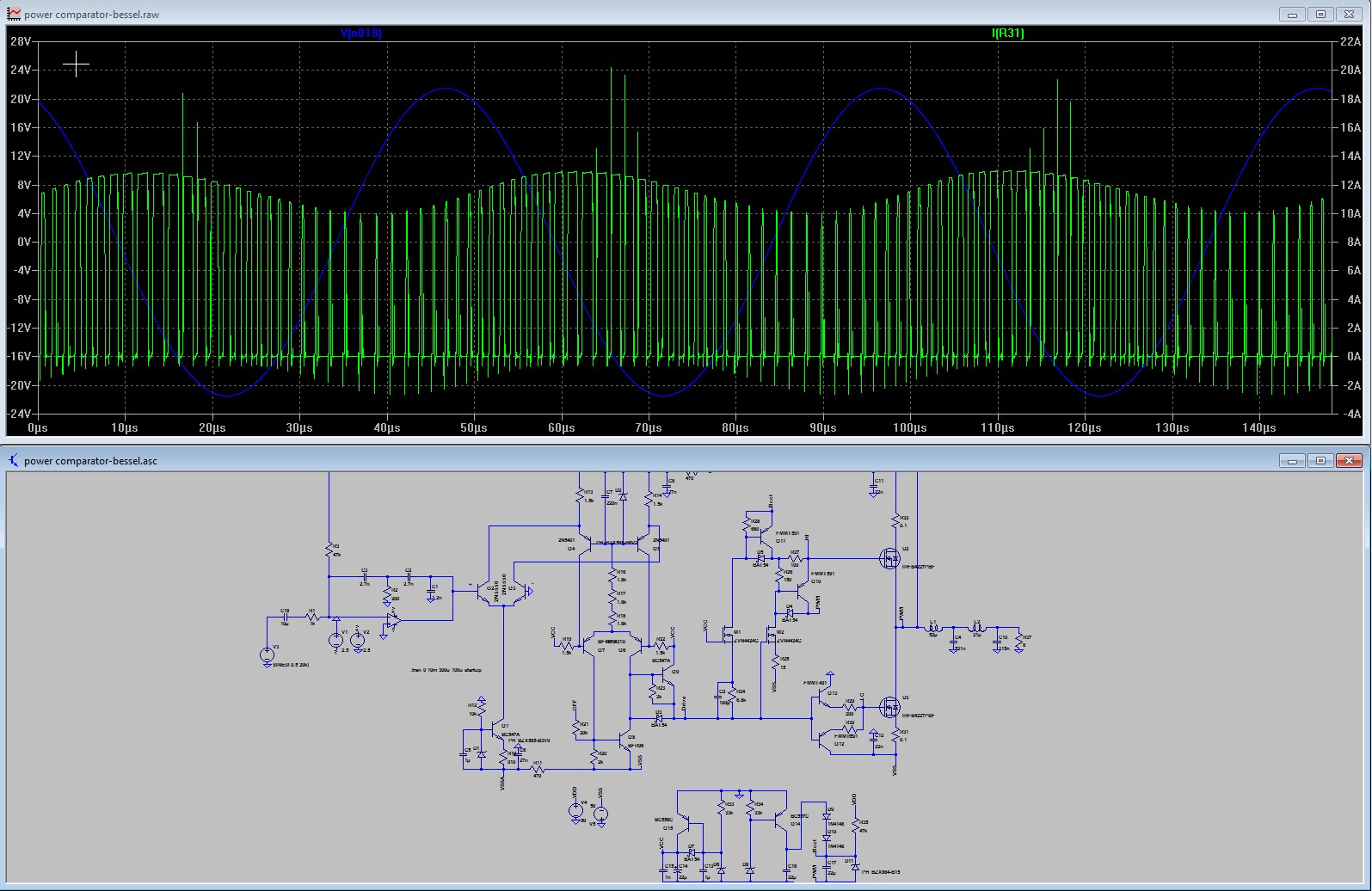

On picture I get the comparator have fast fall times but slower risetimes, this is due to the bigger gate resistors to get less shoot through, I think that also for the pcb is to use gate driver ic,s who do make it much easy to design a clean pcb.
As for your question if I did try things, no, I do read much about the technology and have not yet plans to go experiment, first I want get ready with the circlotron.

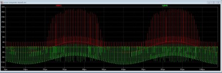

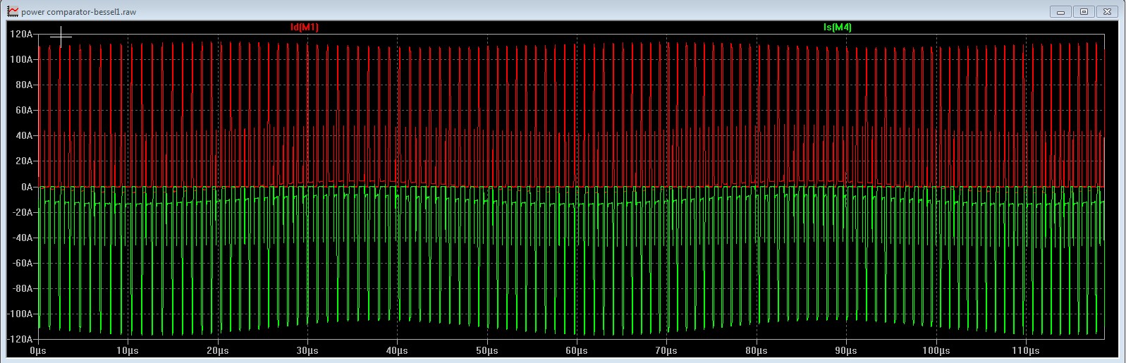

On other pictures U see shoot trough sims, however I need to make the resistor quite big and therefor it has lower risetimes, who is normal but it is quite much, I think that for this only build one is better then sim.
