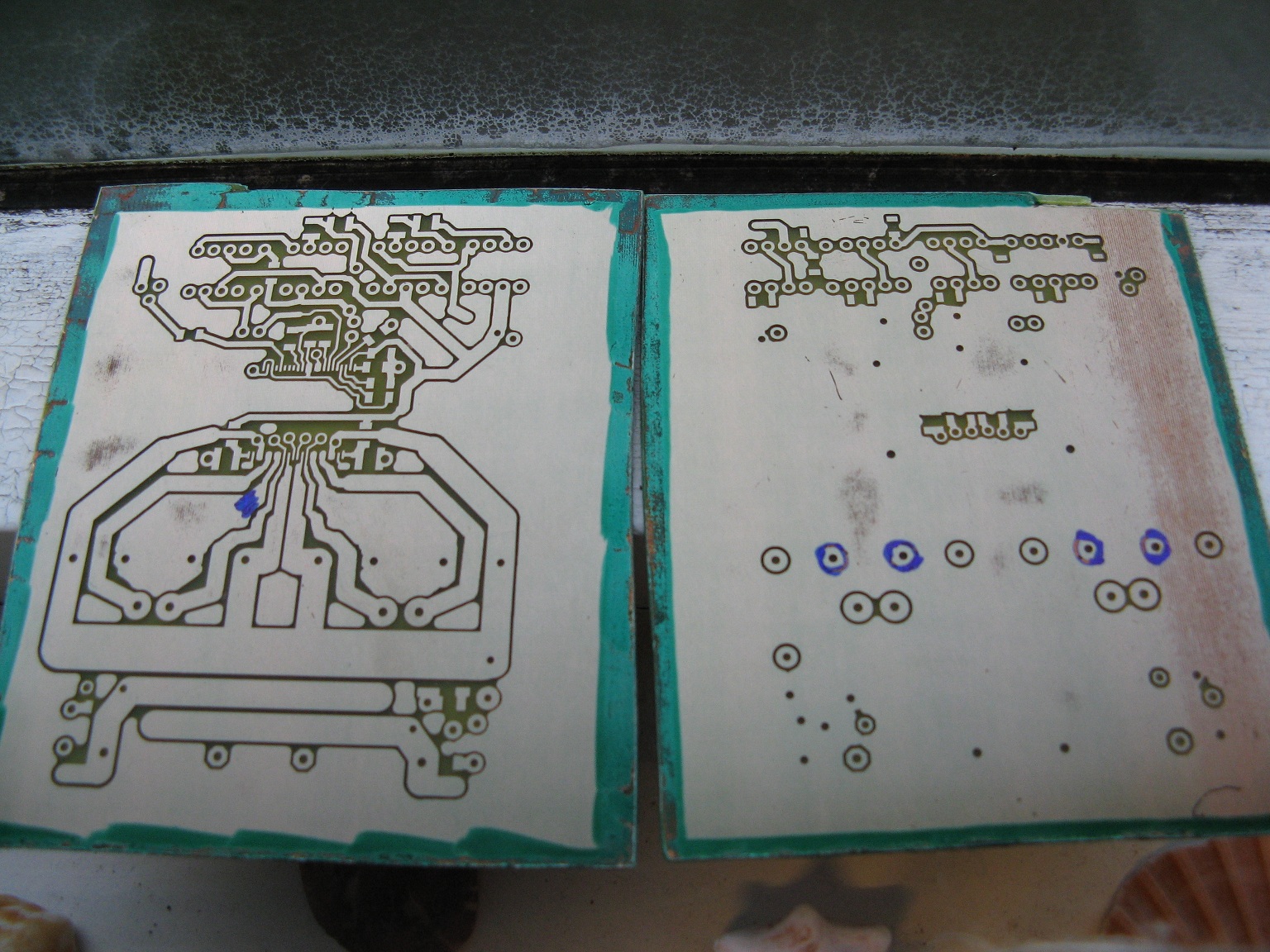

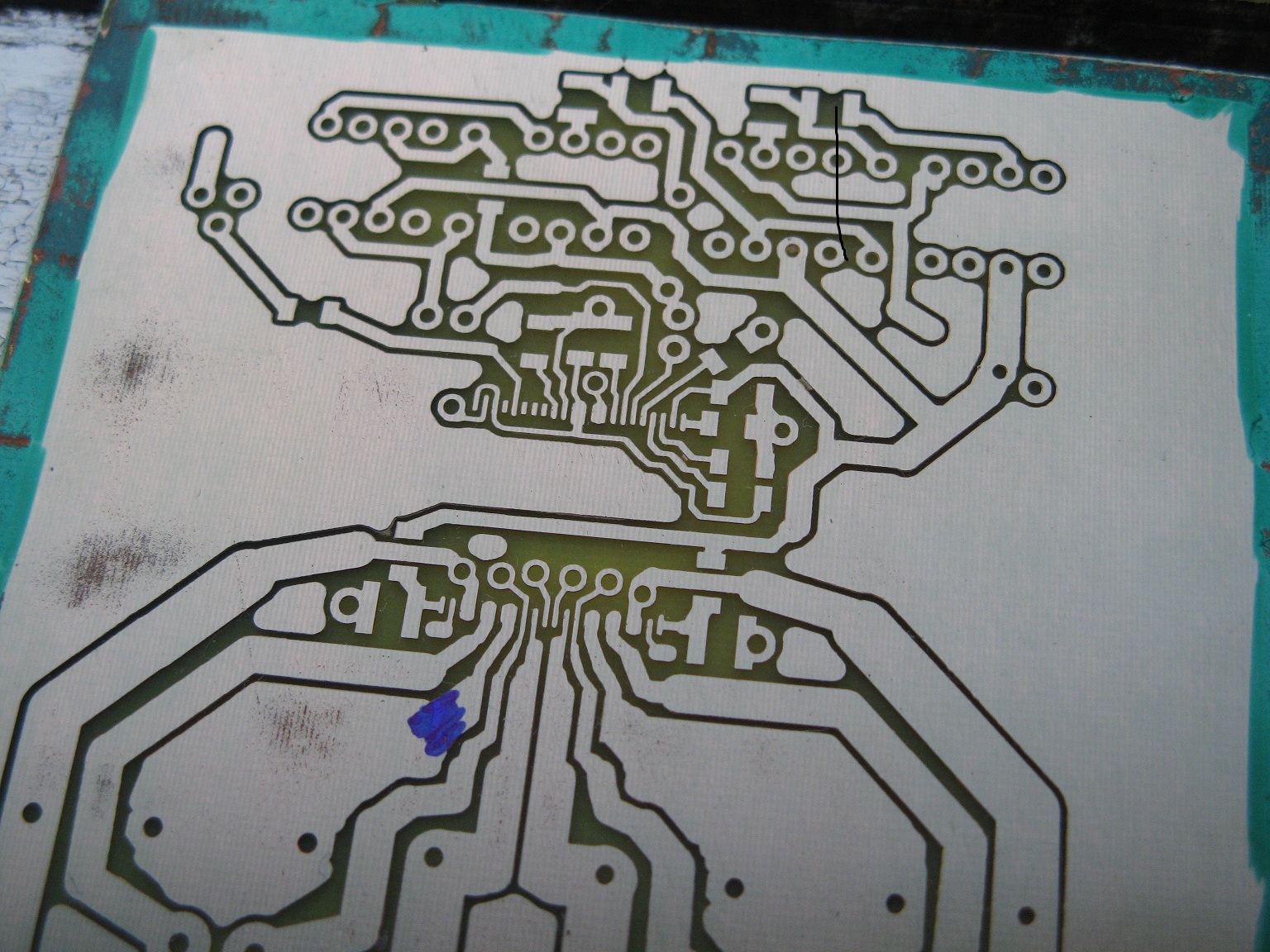

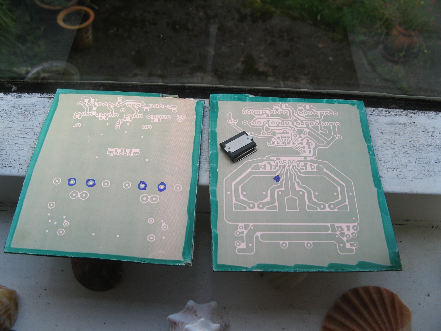

where's all the pics of these projects?
I've got some pics closely at hand, although nothing really exciting. Just the PCBs before and after etching 🙂

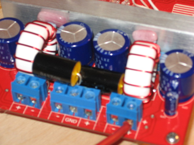

I don't made it but a forum user, Wushuliu, wrote in italian forum:
One last recommendation for this amp: I highly, highly, highly recommend replacing the 2 .47 uf .1 uf Epcos and output filter caps (the big blue caps). I have replaced mine with the well-regarded Dayton film / foil bypass caps. Cost: $ 5. I no longer need the buffer. All the issues with this amp that I believed needed to be corrected by the buffer or preamp are now gone.
Parts-Express.com: Dayton DFFC-0.47 0.47uF 400V By-Pass Capacitor | polypropylene capacitor polypropylene PAC PA low pass foil film and foil dayton capacitor caps cap ac 47uf .47uf
It makes sense as the Epcos are basic low-cost caps. I used them to replace the cheap polyester caps in the buffer. I would have used better but there was no room on the buffer PCB. They are okay, but nothing special.
Obviously an amp like this needs better than these caps for the output filter (as anyone who built tripaths w / input and output filter caps caps knows).
The amp now sounds outstanding. Near-perfect in my setup. It is a difference that would be audible to anyone. It is totally transparent and very, very clean.
Make sure to use a good iron, the PCB is thick so take your time.
I can not recommend this enough. Any decent cap will be better than the Epcos, so you can spend as much or little as you want.
I think this is it for me as far as this amp is concerned. I do not think it can sound any better (well. ..):

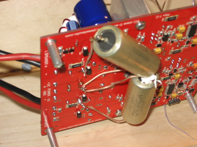

Does anyone have photos of the cap change? I found the board a little challanging to work on, how difficult was the cap swap?
I just threw my 120 wpc in a case made from some bamboo scrap flooring i had till something better materializes. I am very impressed with its huge soundstage and liquid sound. The bass seems to have improved over the last few days and is better than i hoped, and the highs are less edgy now.
QUOTE]
Swapping the caps on this board is a challenge, yes. The solder does not melt easily and you have to be careful about lifting pads. I ended up lifting a lot of the pads on the top side, but as long as you solder underneath you're fine.
Here are some links to pics I posted on another forum.
