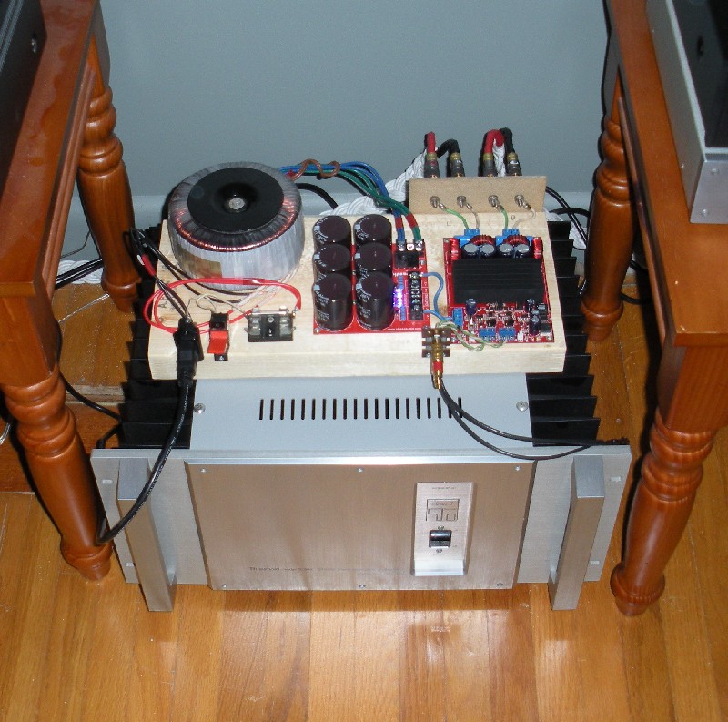

I just received my 300W x 2 kit the other day, and am putting it together now.
I should be able to test it out in the next day or 2.

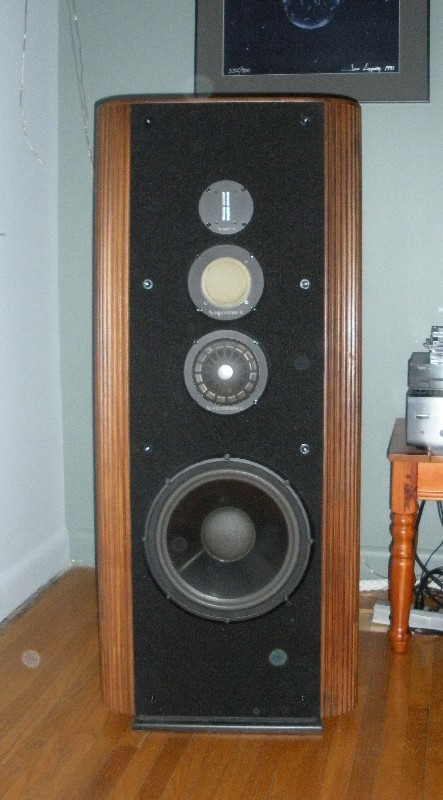

I have a pair of Infinity Kappa 8s I will try it out on, they are power hungry units and can produce impedance loads a fair bit below 4 ohms.
Should be a good test for it.

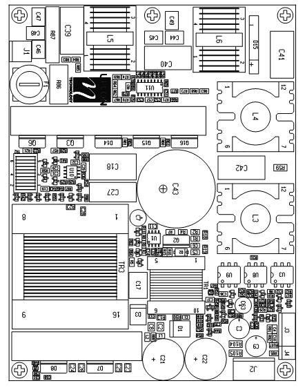

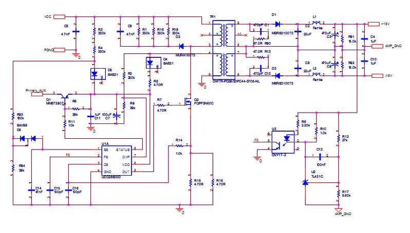

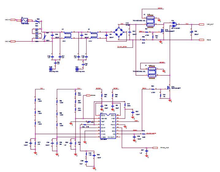

600w smps for tas5630
Ti engineer give me smps module schematic,now I make it reality,pic upload next time,i upload schematic here.
Design Name:SMPS For TAS5630
Design Engineer:by UpCotech, drawn by Kim N Madsen
Configuration:
UCC28061, UCC25600,UCC28600, INA210, TMP300,TL431
Setup:
50V max 600W, 1200W peak +/-15V 200mA

smps for tas5630
This guide documents a low-profile power supply that is suitable for AVR amplifiers or other high power amplifier applications. The power supply accepts a universal AC line-input voltage (85 VRMS to 265 VRMS), and produces an output voltage of 50VDC for loads up to 12 A (600 W).
The power supply is dedicated the Audio application and more specific the TAS5630/TAS5631 from Texas Instruments. The big difference compared to an industrial grade power supply is the typical user pattern of an audio-system. First of all, music is very dynamic with a crest factor typical in the range of 1/10 to 1/5 (Highly compressed music). Secondly, the user pattern of a normal audio system, it is running most of its time in low power mode (<5W) playing"background" music. It should also be noted, that an audio amplifier capable of delivering "x"-watts of RMS power with a reasonable audio performance (< 1% THD) is actually delivering a time varying power between 0W and 2 times the RMS power.
All this has been taken into account when designing the SMPS for the TAS5630
In the following the system features and functionalities will be explained and in the case where the normal procedures regarding power supply design has been modified to accommodate the audio-application, this will indicated.
The requirements for a modern AVR include a slim physical profile and the ability to operate from the ac-line input at close to unity power factor. Therefore a AVR application demands an power supply be of low height, and comply with the power quality requirements defined in the IEC standard, 61000-3-2. In addition, the combination of a tight physical package and the desire to meet Energy Star guidelines requires that the design also demonstrates very high efficiency. Described herein is a practical design that uses standard components. It achieves the requirements using a traditional two-stage power converter topology along with state-of-the-art power circuit control methods. The first stage is an interleaved, transition-mode, power factor correcting (PFC) boost pre-regulator. This is followed by an isolated LLC series resonant DC-DC main converter.
The design takes advantage of three integrated circuit (IC) power controllers. The PFC pre-regulator stage is controlled by the UCC28061, a dual-phase, interleaved, transition-mode PFC controller. The resonant LLC converter uses the UCC25600; a low-cost 8-pin controller. The third IC is the UCC28600. This is used to control a small 6-W flyback converter that provides a bias supply voltage.
I finally got a chance to test the amp with the Infinity Kappa 8s.
Although it is a powerful little amp, the 8s are just a little too much for it.
Heavy and low frequency bass passages can send the amp into protection mode.
That is not really surprising though, the 8s and 9s were known as amp killers back in the 90s as they can easily dip down into the 2 ohm and under impedance range. Most integrated amps and receivers back then just wouldn't cut it with these power hungry units.
The track "End Credits" for the soundtrack from Apollo 13 immediately shut down the amp several times, even at medium listen levels, but to be fair that particular track has a very wide dynamic range.
The track "Lets Groove Tonight" by Earth Wind And Fire would also shut down the amp on bass passages when played at medium/high levels.
Each time the amp did trip, switching it to standby mode and then turning back on reset it with no issues. A low frequency cutoff adjustment on the preamp would go a long way to making this amp work with speakers such as these.
I found the midrange performance to be good, but the upper end is a bit off with some slurring of s's and does become fatiguing at higher sound levels.
I have to admit though, I was impressed on how well it does sound out-of-the-box, especially considering the low cost. I know from personal experience that most equipment responds very well to tweaks such as bypass caps, power supply upgrades etc, so I consider this to be a diamond in the rough. Even after several hours of running at normal/medium listening levels, it barely gets warm. I am very happy with it, and looking forward to seeing what kind of improvements I can get out of it.
Btw, checkout the bread-board design, 2 x 8 spruce to be exact 🙂
