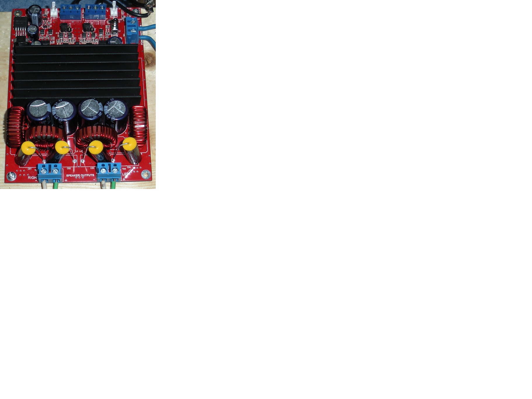

What are the details of the cap mod you preformed? Any pic's? Results?
I just switched out the output caps, nothing major.
I used the Dayton caps as suggested in previous posts and kept them as close to the board as possible. The dual layer board makes removal of the oem components tough, you really need to be careful when removing them to avoid damage to the traces/pads.
I currently do not have an unmodified unit, which makes it hard to really compare.
It is one of my favorite amps, very nice throughout the frequency range as well as being very dynamic. Really shines in the midrange, probably one of the most appealing aspects to it for me.

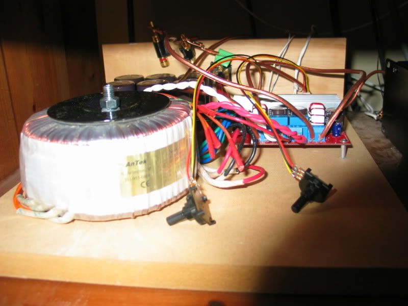

I purchased this kit:
Class D Audio 600W Class D Power Amplifier and Power Supply
It measures 50V at power supply output.
With source off and preamp turned down to zero, the hiss is very faint on the tweeters, you have to be within 2 feet to hear it.
My ears are still pretty good, but they do have 50 years on them.
Someone younger that has not wrecked their hearing may be able to detect the hiss from a farther distance.
Keep in mind that my unit has not been mounted in an enclosure yet either, but I cannot hear any hum at all.

The output caps are operating as zobels I believe and are not in the signal path (the 22uf cap underneath is however, so I may tackle that despite possible lead inductance issues) so although changing mine up cleaned the sound up some it may not be worth the risk to the board if you're unsure of your soldering skills. I found a far, far greater improvement putting a Pass B1 in front of the classdaudio amp.
Edit: msb64's amp does looks easier to swap caps than my IR 250w, which has tighter spaces.

Thank you very much for your answer! 🙂 I built my TAS5630 amp prototype and I can hear hiss from the speaker on approx the same distance 🙄 First I was thinking there is something wrong with my PCB layout/traces, but seems it is not possible to improve this parameter in simple way. Now I plan to run TAS5630 chip in slave mode and feed the OSC+/- pins from some high quality low noise XTAL oscillator. Will see, if it helps... 🙄

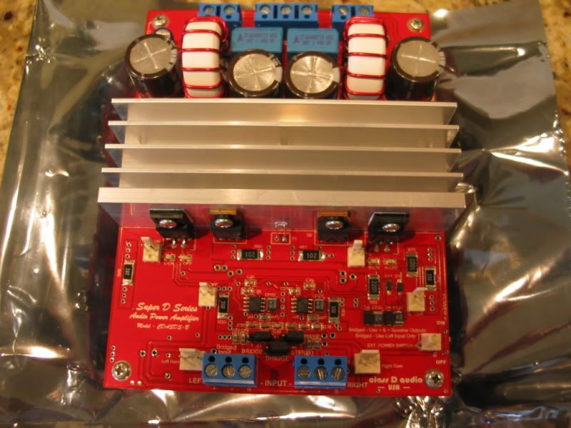

Thought i would dig up this thread as i just picked up one of their new SuperD series amps. I had the 60wpc original amp and was very impressed but the new SuperD series takes it up to another level. I picked up the 125wpc SuperD amp and are experiencing better and tighter bass and just an overall more controlled sound. They now have adjustable gain onboard and a new input section. Highly reccomend Tom's new amps. 😀

Yeah, I have looked at those new modules too, and they sure like being improved
Apparently because of more expencive components(input buffer?)
But is the new improved input buffer only better with balanced signal ?
But cost twice as much
With shipping and custom taxes they are getting closer to the big Hypex
