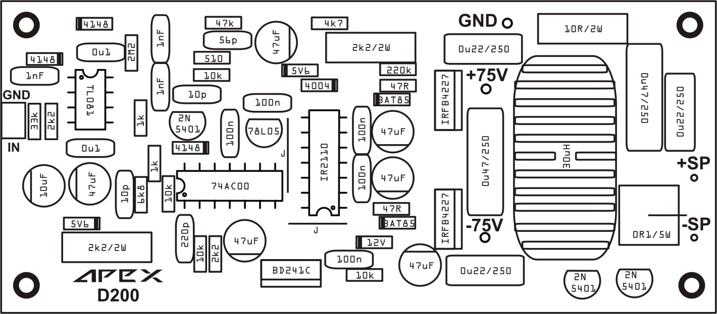

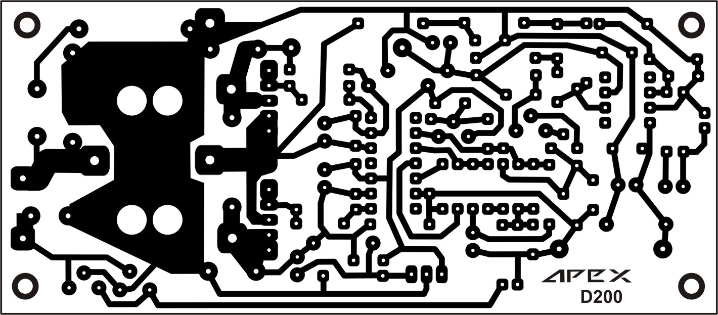

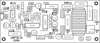

Class D Amp with LM566, LM393 and 2XIRF530
D200 pcb size 52.5x120mm, TO220 or TO247 fet can be use with this pcb.

I don't know if anybody has mentioned this already, but why not just use a IRS2092? Is basically have all built in - analogue audio preamp, pwm gen, mosfet driver, protection and more. B&W use it in their high end HT sub's.
Here is the link to the PDF: http://www.irf.com/product-info/datasheets/data/irs2092.pdf
They have a few reference designs on their website, complete with PCB files 🙂
IR2110 is easy available and not expensive. With 74AC00 power on mute and O/C protect is add. With BD241C no need for extra 12V bias suply...
