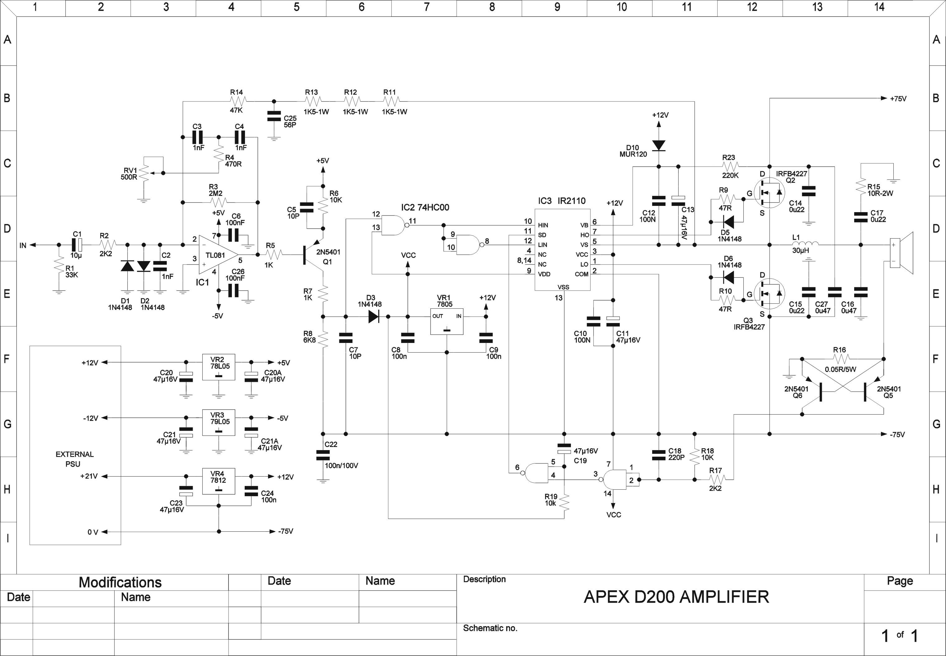

i redraw the schematic of mr apex d200 and rename the parts.. sir apex can you take a look if i miss something
Nice work, but some values is wrong 1k5/1W and 30uH...
Regards

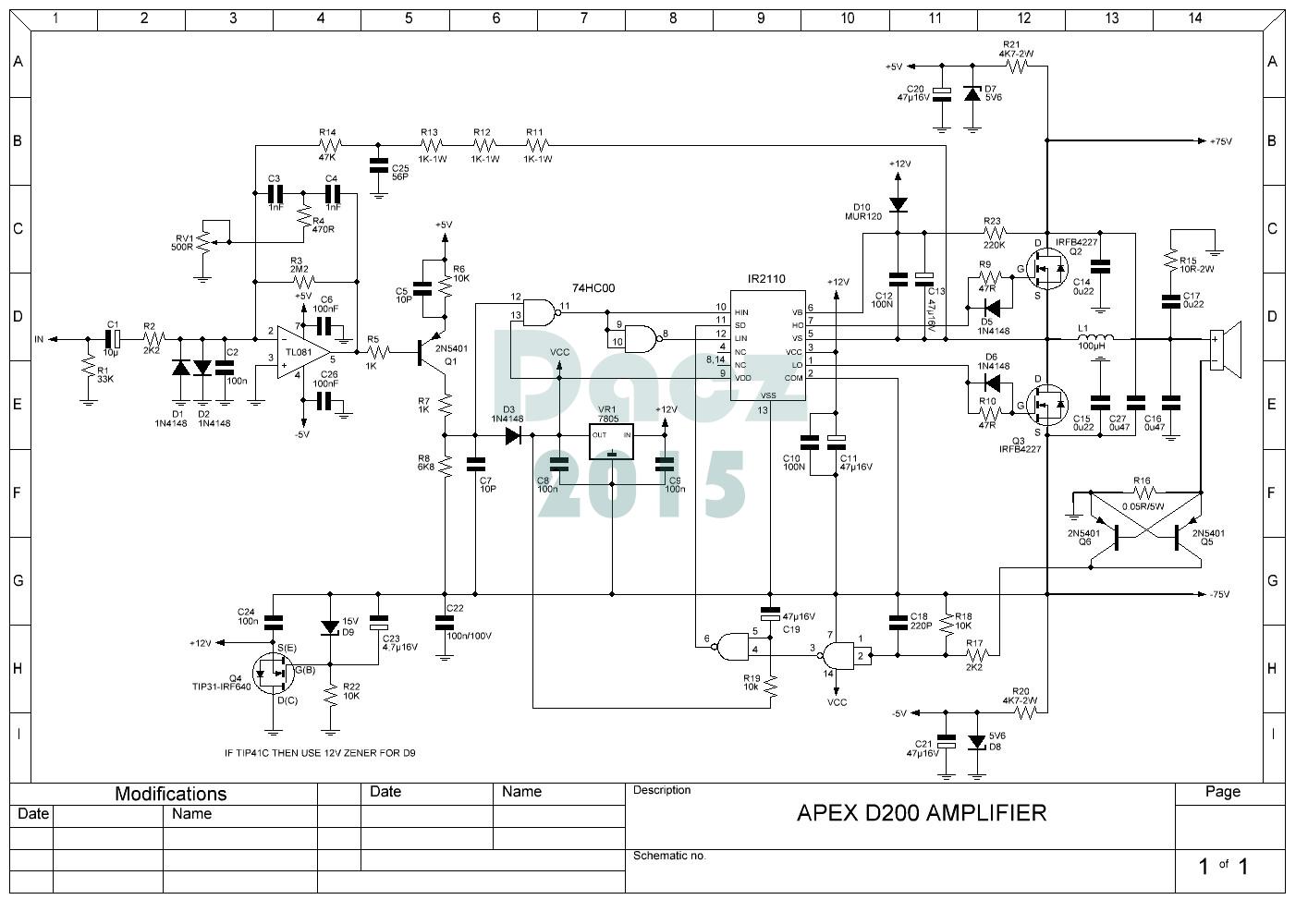

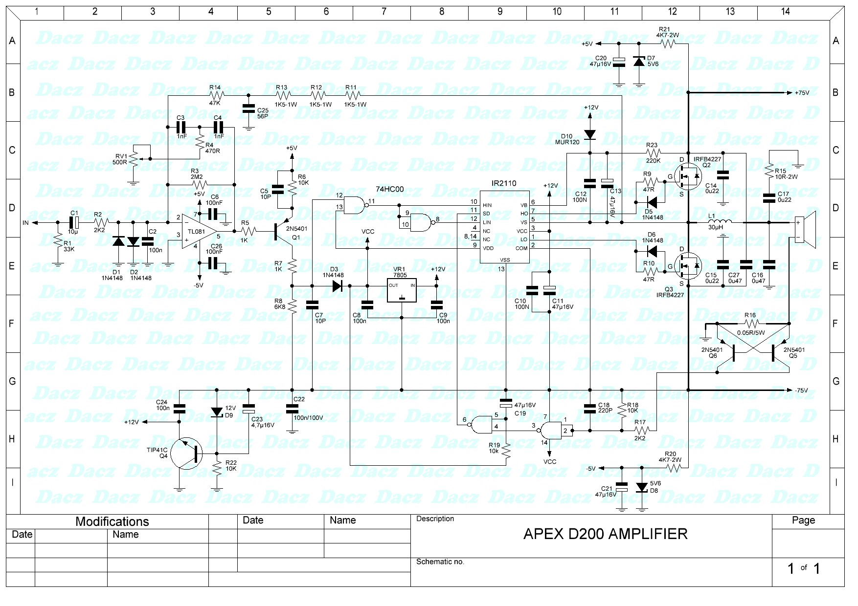

thanks apex.. here's the corrected one.
Hi Dacz,
Remove R13&R12 and R11 is 1K/2W C25 is 100pF/100V R21&R20 is 6K8/2W R14 change to 60K (Parallel 100K & 150K) and Remove C2, R2 is 1K2 remove R23 & Provide Zener 15V parallel C13 & L1 is 22uH, 0.22uF/400V use C27 Parallel & .Now the audio will good & use 330R/2W series with Q4 Collector { Now you can use IRFP250N}.
Regards
MANOJ

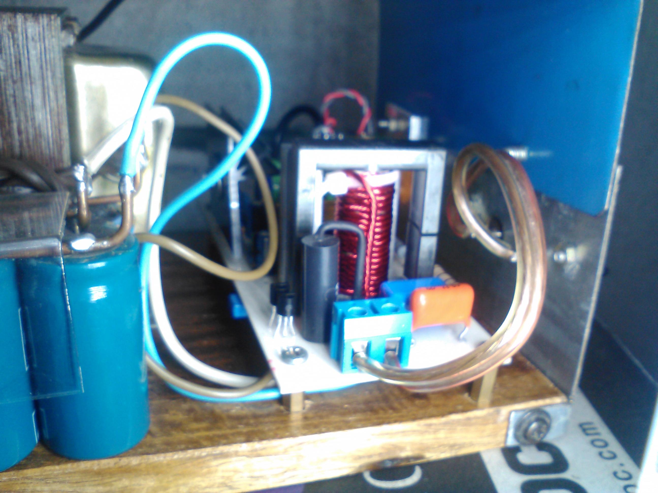

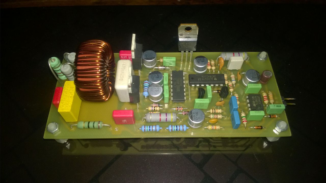

Here my Apex D200.2, working very good and hifi sound. Tested with 30vac and fets are cold, just Tip31 going warm.
Regards
Nice work, TIP31 must have heatsink.
Regards

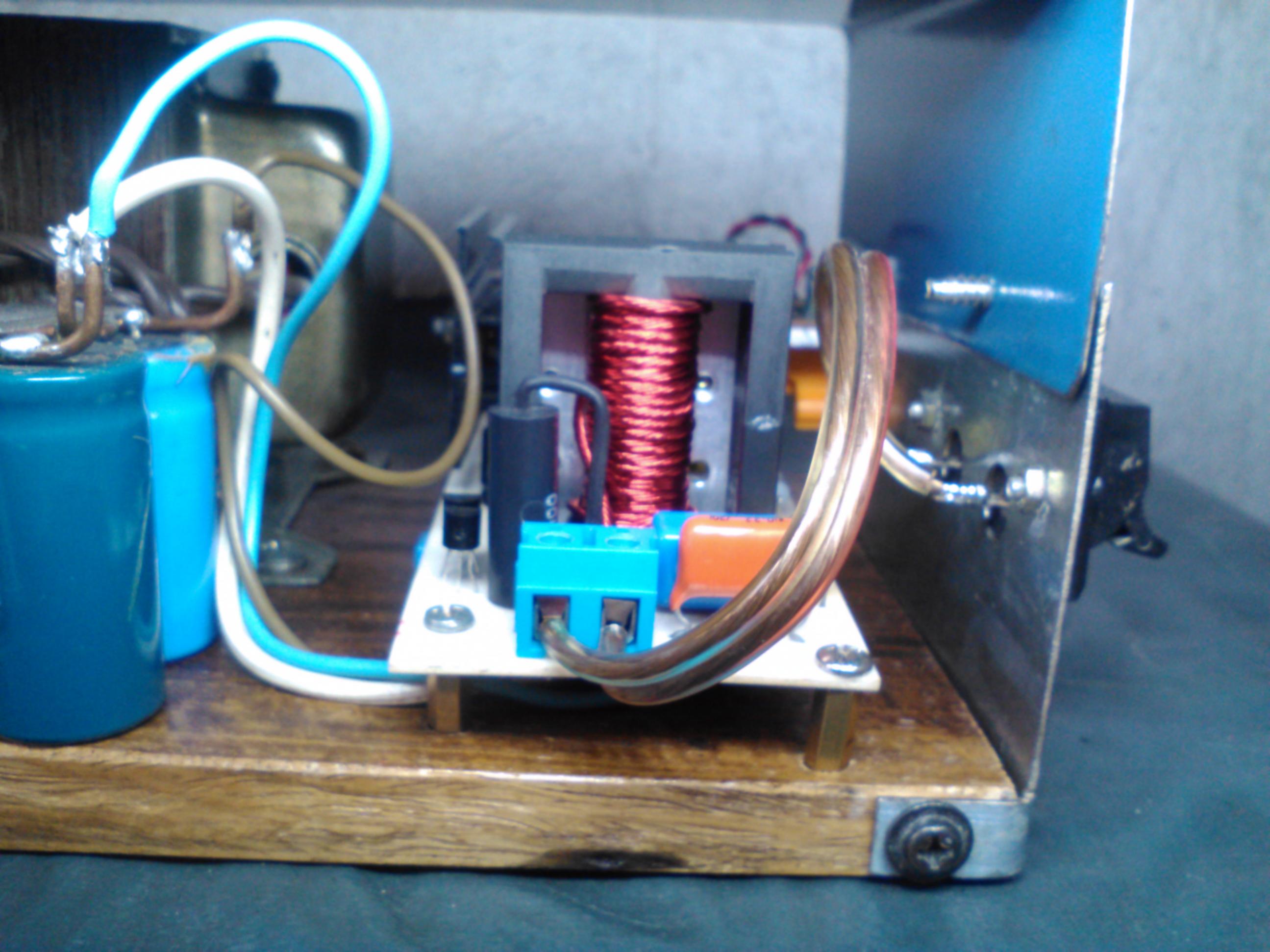

Hi Apex,
I've test my D200 this morning... I play it in 30minute the inductor is hot i used sendust core as will the 10ohms in zobel is hot.. sound very good very clear... I plan to change the inductor with T106-6, but I notice the out put power is low i think is about 40-50watt.. it is ok to change the feedback resistor into 100k to achive higher gain just like other d-amps?
Hi Apex,
No, just replace inductor.

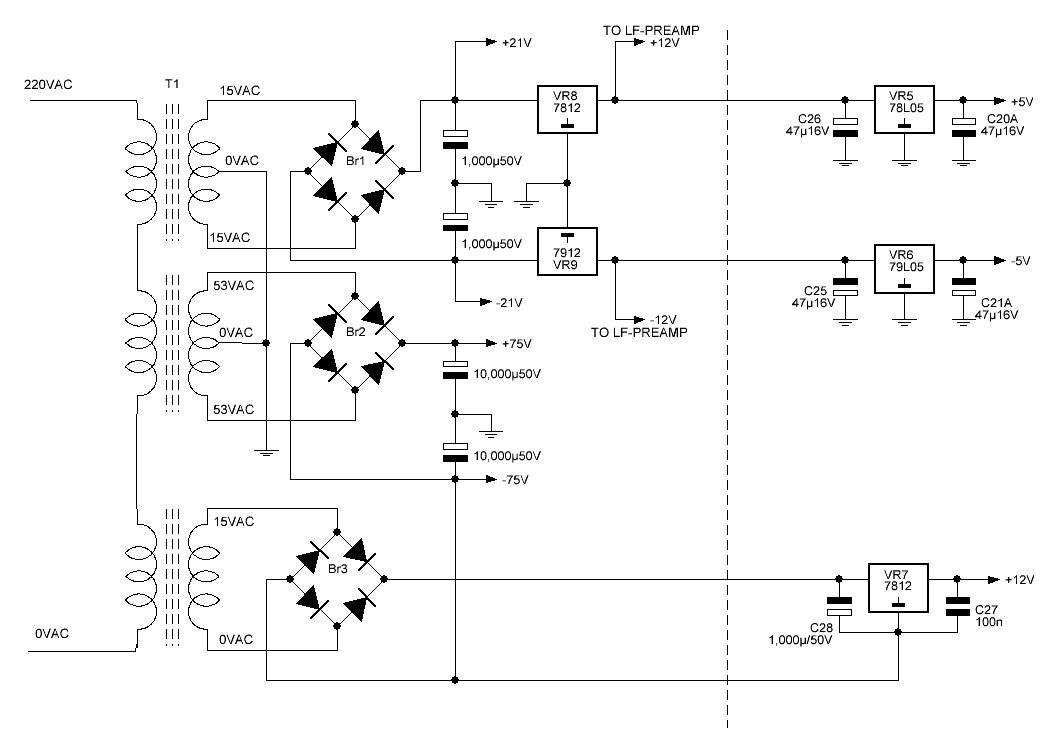

sir apex, is the schematic correct if i use external +/-5v and -21v power supply
+12V is ref to -75V not to gnd.

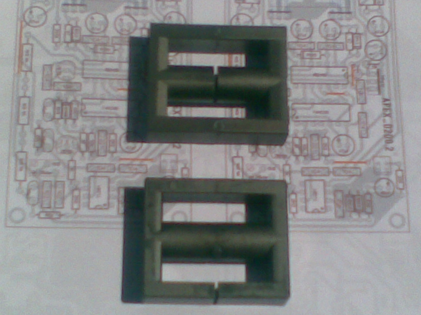

Has anyone made a comparable measurements between using gapped EE flyback traffo & iron powders as output inductors? I made some listening test and it seems, the gapped EE ferrite performs really good as well. It is definitely cold probably colder than the T106-2. I experimented another EE same size as flyback traffo but ungapped, I did however made a 1mm gap on one leg and it surprisingly performs very good as well.
