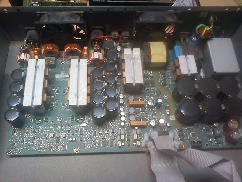

lab amps aren't class-d , their amps are based on Tracking Class-D or TD and the final stage is an AB class Amplifier.
Crown also using Micrometals -2 material but they are original core and never gets warm in low output current like you said before. for example T157-2 gets warm about 55 degree @ 10A output current and 150vPP inductor voltage i guess.

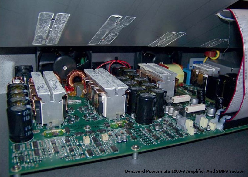

Dynacord is new in Class-D , i saw their using torodial core in PM-3 but can't guess the type of material because it's not visible clearly. maybe -2 material. you got a picture from inside ?
what is HONAMIC then !? any picture form inside ?

dear IRsound
u absolutely right
in PM-3 they used 4 stage filter back to back, that core induction decrease in each stage and make the output signal clear and linear just like an AB-class amp output
2 of this cores are clear-red micrometal and 2 other (last stages) are regular white core and dark gray.

Thanks for pictures , did you repair it ? if you have any other info (like part numbers of fets ,etc) please share with us.
using higher order filters isn't very easy , it should design carefully to obtain a good result.

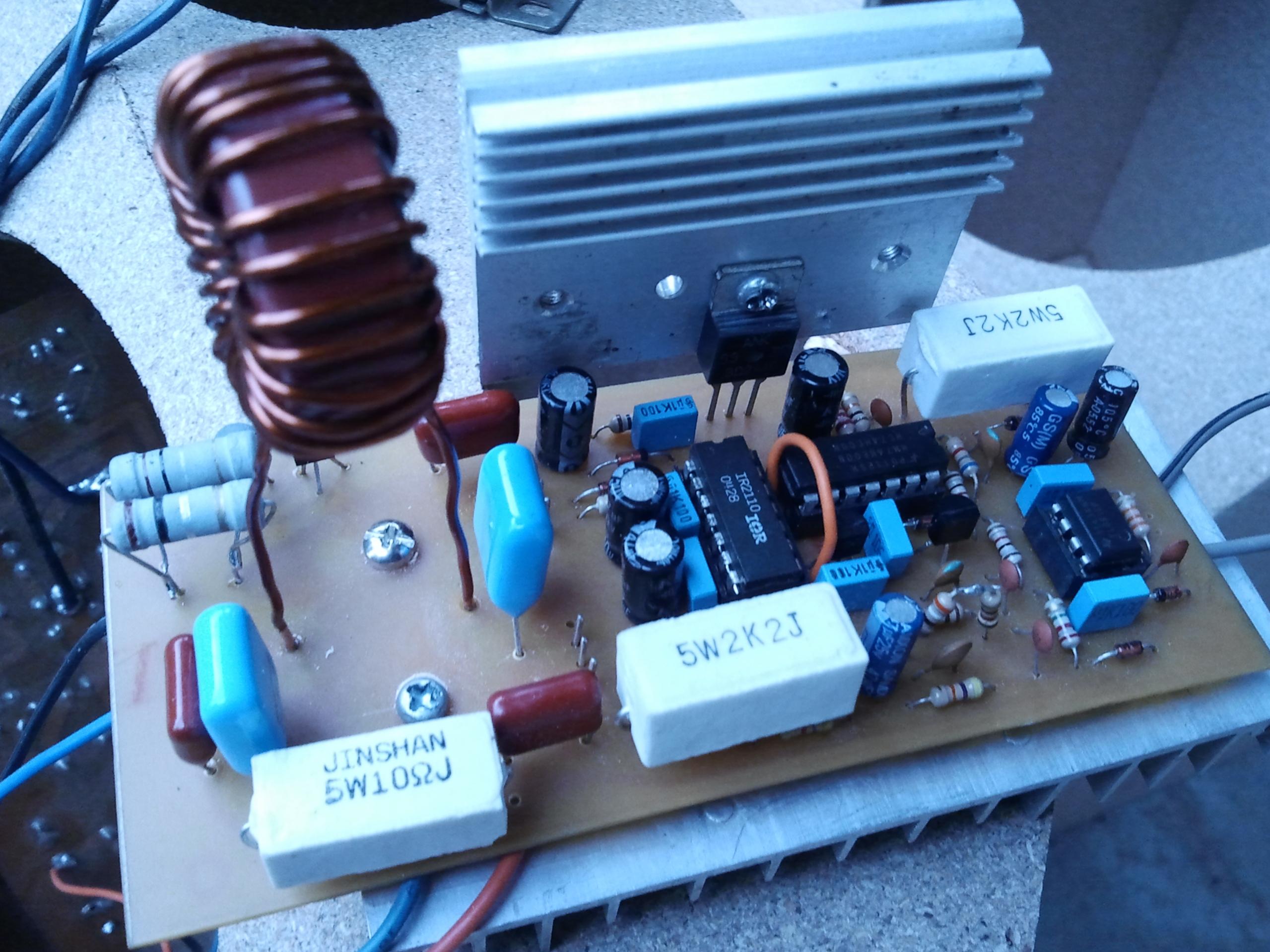

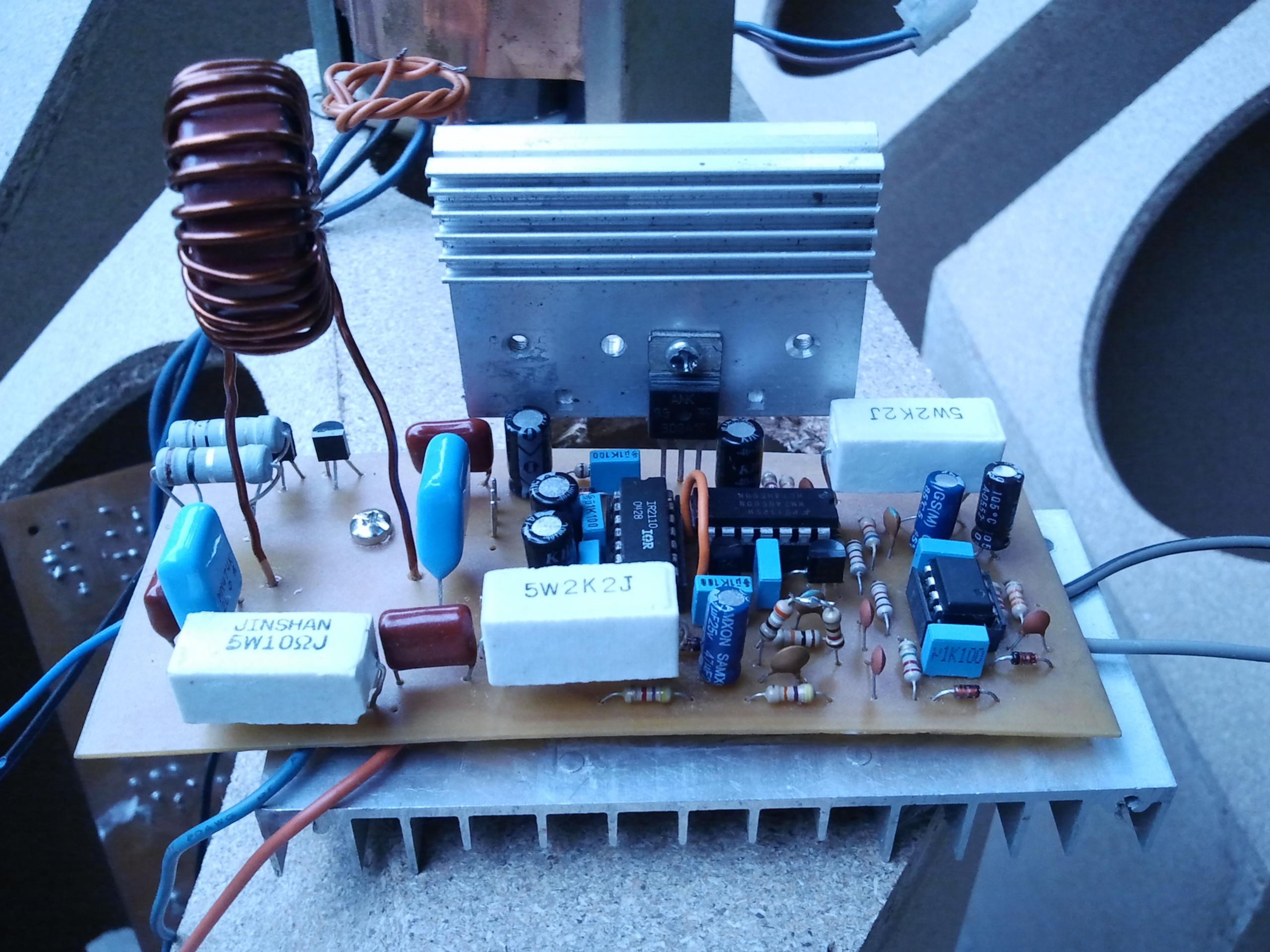

Test after mounting heatsink

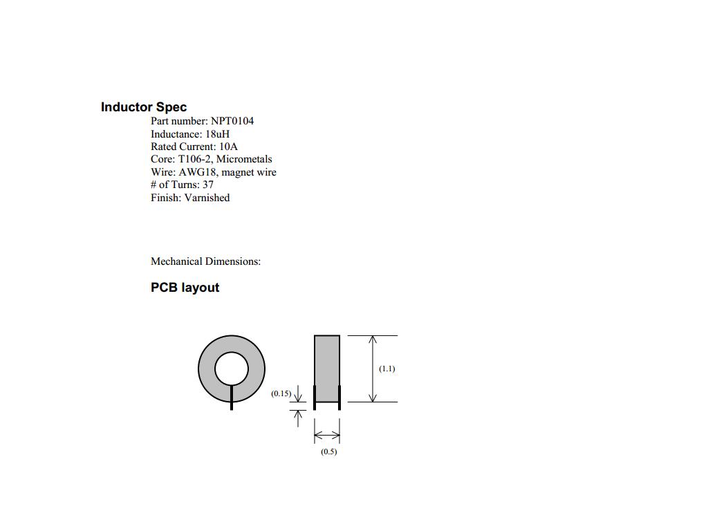

I reduced the number of turns on the inductor. Now it has 26 turns. I think I made a mistake. According to this: T106-2 It must have 47 turns.

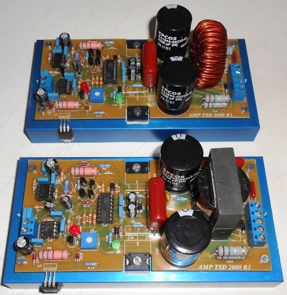

10R/5W resistor heated up too much. I could even smell it. Could hear some noise. FETs also heated up like a class AB amp. Small heatsink is not enough. Are these all because of reducing the turns or something else?
need some help!
need some help!

Use 65 turns on T106-2 for 30uH
65 turn will have inductance around 57uH. with 49 Trun of 0.8mm wire , will get 33uH.
- with 26 turn , will have 9uH which is very low and have higher Cut-off frequency more than 75KHz , it have bad effect on output HF.

Apex and IRsound,
Thanks for the help!
After winding about 45 turns, it gave me a good result. I had to increase the value of 510R to 2K2 to reduce the noises. Now everything is good. I will wind more turns and test it again later then i wouldn't need to increase 510R.
So far I couldn't reduce the heat emission of outputs in each case. May be IRF640 is not good. Unfortunately I can't find IRFB numbers here.
Amp is stable and overall good. What do you suggest me to increase the output power. Bridging 2 of these or increasing the voltage and outputs?

Amp must work good with IRF640N, I suggest bridging 2 of D200 to increase output power.

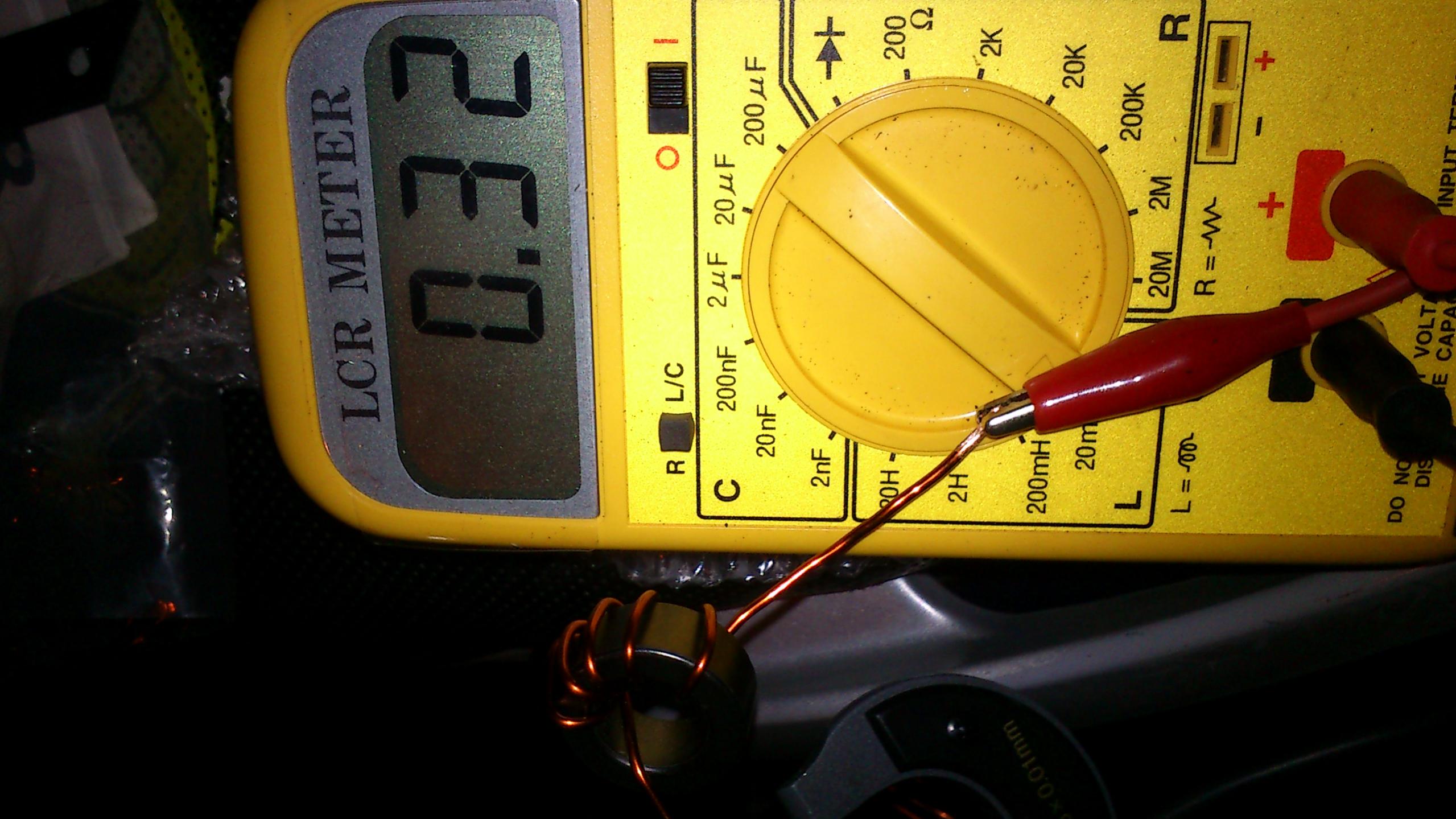

0.32mH 😕 using 1.6mm with 250mm core, is this ok ?😕
No. Ferrite cores are not good as the output inductor here. It will heat up like a burning coal. Just try it and have fun 😀
T106-2, T157-2 or any -2 iron powder cores are ideal.
