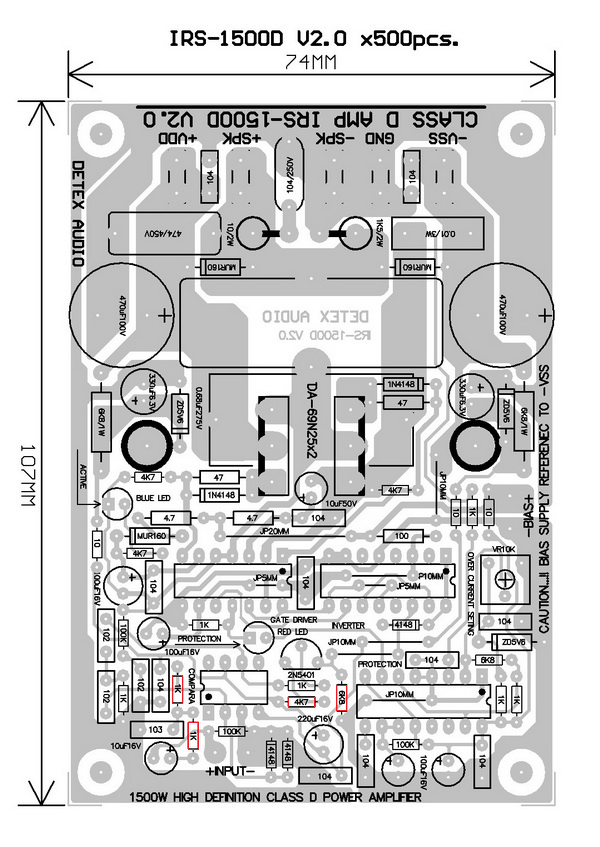

I test both D200 and IRS-1500D. in my tests , IRS have some problem before starting oscillation. when we apply voltages to the amp , IRS doesn't start oscillation and active LED is off. just like your amp (check on scope) , also your amp doesn't start oscillation before apply input signal.
but the first problem with lowest level input is a little noise can be hear form IRS. i uploaded a video on my channel @ youtube about that.
after applying input to the amp , your amp start oscillation and there is no problem but 4227s get warm maybe due to their high Ciss or low gate charging current. so as i mentioned before , temp rising was my problem.
but in IRS , like the video , when i increase the source volume up to 5% it wasn't oscillate in correct way. i couldn't understand why and no ones tell me about that ! 🙁
but after 8% volume , active LED bright constantly and amp start to oscillate @ 250KHz and everything will be ok after that. i don't know it's my problem or another people have same problems.
- I think the IRS problem is CD4049(VCC) and IR2110(VDD) supply. in your amp they're connected to a +5v line via 78L05. but in IRS they're connected to +12v bias via 100 Ohm resistor.

your problem was in level shifter point(5401). adjust the resistor value for the inverter input.
for IRS900 change 4k7 to 1k5 and 6k8 to 10k
change signal input resistor 1k to 2k(pin-2 of TLO71)
regards

Hi Manoj,
Thanks for your guides , you always learn me important things. thanks about that.
so , the problem is level shifter. also the output noise before oscillation ?
I'm working on irs1500 , it have 2K resistor at input of comparator.
look at attached image. i should change those 4K7 and 6K8 ? how do you find those values ?
why detex didn't solve this problem before ?!

I change those resistor with 10K and 1.5K. but the noise changed to another form.
then I add a 68K resistor between VDD and VS (before filter) , problems solved. everything seems ok , what you think Manoj ? is it ok to put this resistor ?
Regards
sorry ,
the problem is still available. that resistor i think make some problem for high side section..high side mosfet gets warm..also bootstrap diode and capacitor. so i remove them..
but with 1.5K and 10K amp not oscillate. it makes some noise before applying more input level to amp. so i just don't know what should i do !! 🙁
Hi IR,
level shifter changes for CD4049 only not for 74HC series and use more stage inverter buffer to get good square wave shape. use good output filter(T106-2)
or use 74HC14 series
amp will oscillate only your level shifter is good, oscillate only after input signal then your level shifter near to the good point.
Regards
MANOJ
Hi Manoj,
i'm using 4049 , i change 6K8 with 10K and 4K7 with 1K5.
now , when i apply power to amp , a noise appear at the output just like before but with another form. something like amp is near to oscillate. when i apply input with higher input , problem solved.
how about changing that 1K5 resistor with lower values ?
