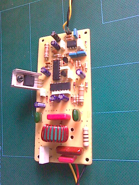

sir mile
what is the problme in my D200 board ?
I can't tell you without tests and measurement, but try it without O/C protect if you can't find 0,05R/5W resistor.

hiI can't tell you without tests and measurement, but try it without O/C protect if you can't find 0,05R/5W resistor.
i am using 0.1 ohm now for test but nothing change

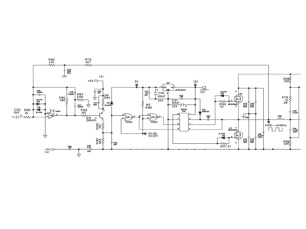

i found some amps on Russian language forums , with LM311 instead of TL081 and some difference in design , did you see them ?

I use IRF640N for test with 8 ohms speaker, sound is hi-fi quality and mosfets is just warm without heatsink (work at over 100W ).

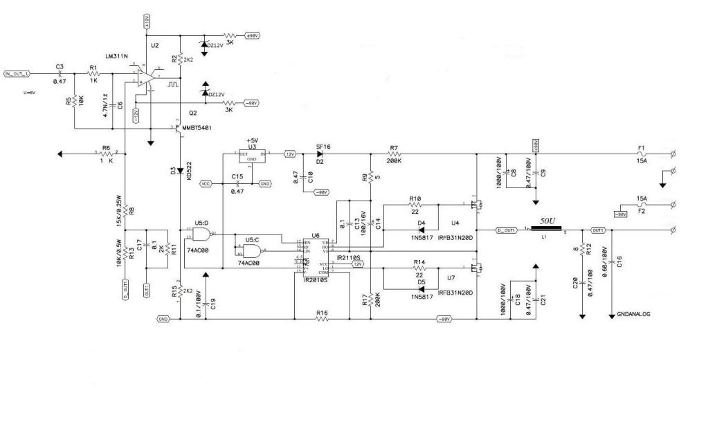

Russian amp is UCD topology and D200 is IRAUDAMP1 topology.
Thanks Mile ,Russian amp is UCD topology and D200 is IRAUDAMP1 topology.
where can i find difference between this two topologies ? I really want to understand how they work...but i cant find a short and good article about this..if you don't mind , please give me some lessons.

Irsound could share these russian page links? thanks.=
Hi Exflaco , i found that picture in google image search. i don't remember which forum was it. 🙁
but i think mile upload their schematic before. LM311+74AC00+IR2110
he changed modulator section with mackie. i upload those schematics for you.

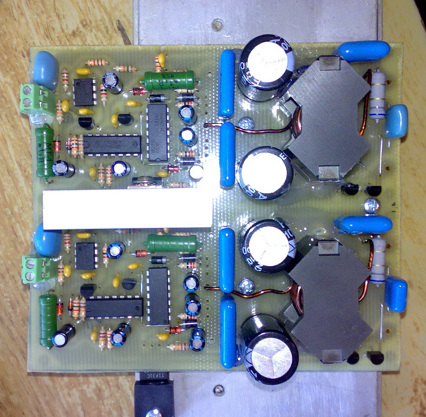

Hi sir mile
Hi
please share a very good quality picture from your amp
i want chek your amp parts and my amp too
maybe i have problem in filter zone. right ?

With my PCB design no need for large electrolyt capacitor behind fets on pcb just in PSU, and I use 470nF and 2X 220nF on pcb.
