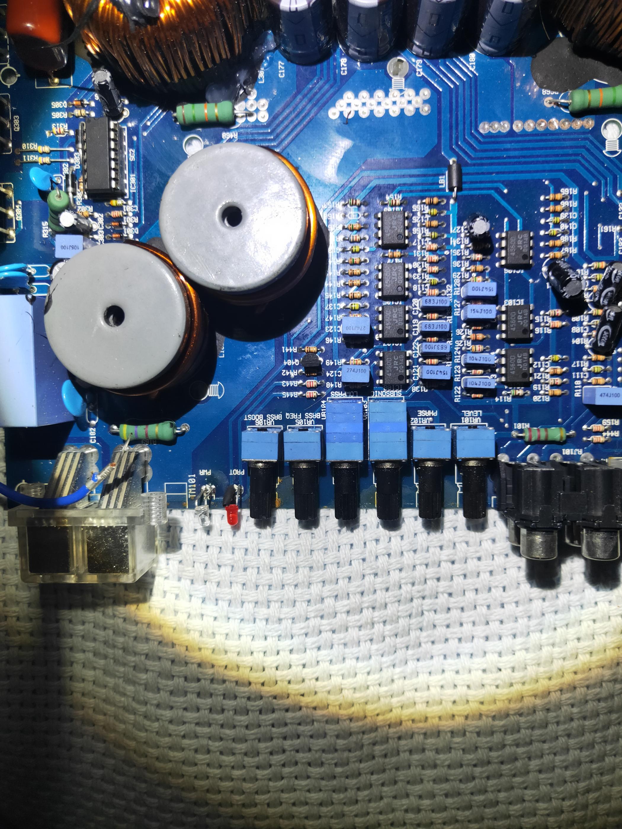

It's a ferrite bead. It's a piece of wire through a ceramic ferrite cylinder. 0 ohms is right.
OK cool just thought I'd check. Seems the bass boost has some relation to it.
No audio with no pot has me a bit worried.
The pot was cracked on the underside though so it was definitely faulty.
It may have taken more components out when in failed. Hence no audio 🙄
New pots will be about 2 weeks away
You won't have sound with that out. It is an integral part of the pre-amp circuit.
OH OK like I said I don't know much about the pre amp section.
Well that gives me a little hope that the new pot may fix the problem. Fingers crossed.
The Amp still goes into protect when u cycle between Master and slave and a loud pop through the speaker. This may be normal I'm not sure. But when it was in slave mode turning the bass boost would not cause protect so its definitely a problem in the pre amp section
So it's not normal to go into protect when u cycle between Master and slave. Just tried it on the other amp and no pop or protect on that one

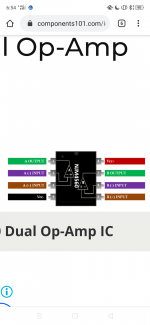

Does anyone know a way to test these 4560d chips in circuit? Is there a specific voltage that should be on pins?
I notice there should be input voltage on pins 4 and 8.

That's doesn't seem right. Was the black probe on ground?
Yes was on the ground pin of the chip
The IC has no ground pin.
Vcc-?
For most all audio circuits, the op-amps are operated from a ±15v supply. The negative supply terminals are connected to the negative 15v supply. Not to ground.
OK so where should I put the black probe if not on the vcc-pin?
Oh sorry I think I understand now. Connect black probe to ground?

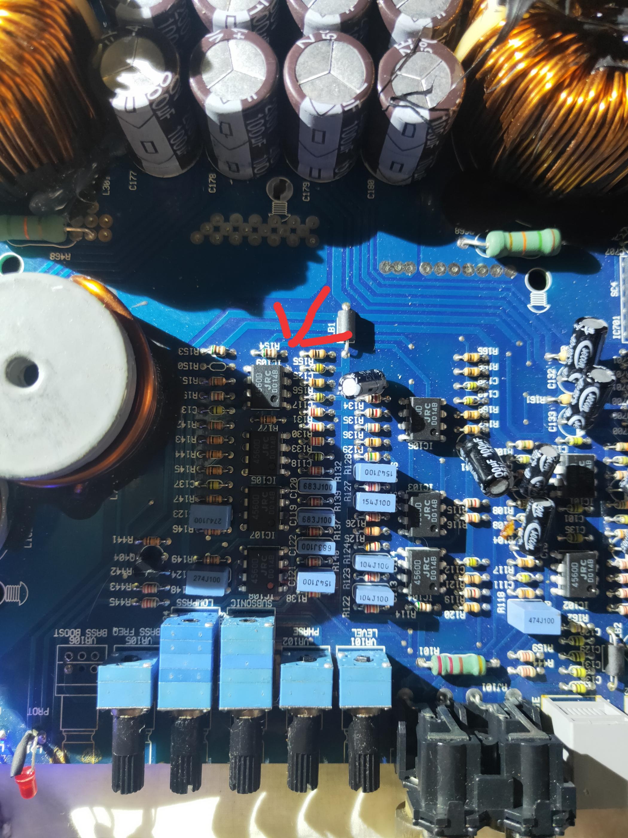

10.7vDC is what I get. But most the IC chips are not putting out anything.
I got 10.7v on both a and b of the top chip I posted a photo of earlier
The one below that is 6v and nothing.
Below that 10.7v and nothing
Below 10.7 and nothing
1.3v on b output and nothing on a to the one to the right.
Then from there. Nothing
With the black on the ground terminal, what's the DC voltage on the RCA shields?
2mV
None of the op-amps should have any more than about 25mv. There's no exact number but a volt or more for any op-amp in use (sometimes only half of the op-amp is used) is likely indicative or a problem. To know if an op-amp is defective, you have to look at the voltage on the op-amp input terminals and see if the output is what it should be for the two input voltages.
