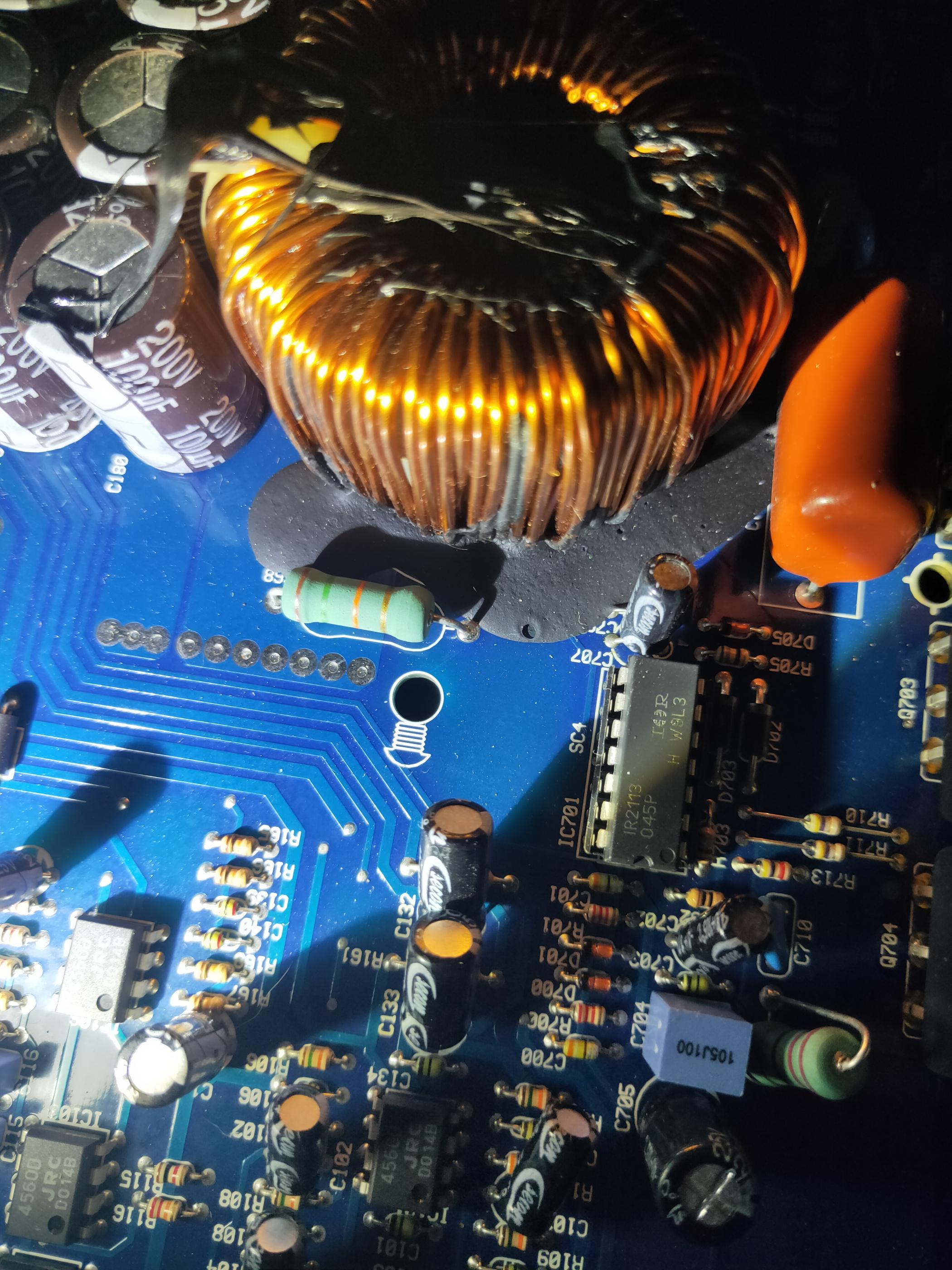

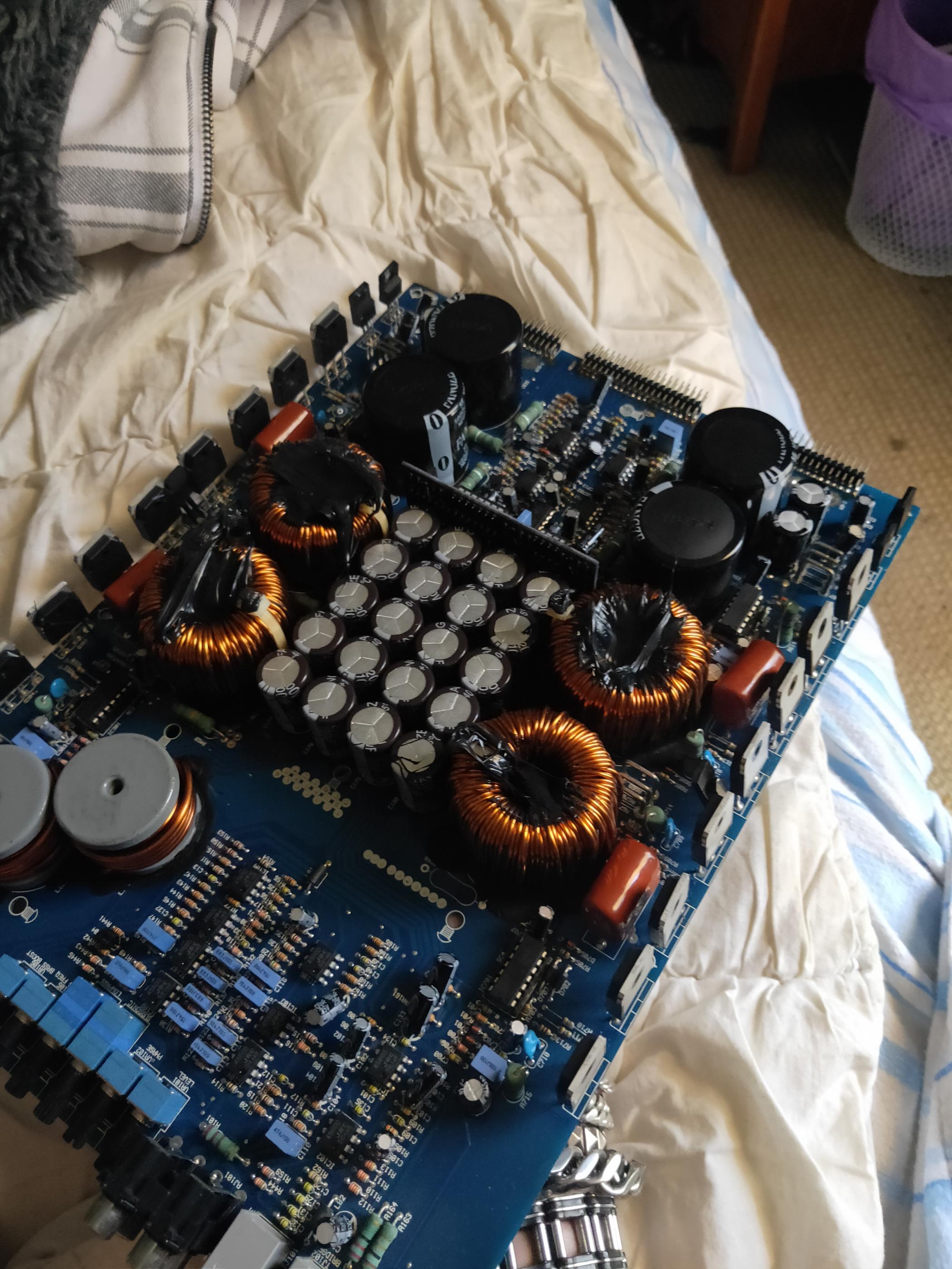

Class d amp repair help.
None of the op-amps should have any more than about 25mv. There's no exact number but a volt or more for any op-amp in use (sometimes only half of the op-amp is used) is likely indicative or a problem. To know if an op-amp is defective, you have to look at the voltage on the op-amp input terminals and see if the output is what it should be for the two input voltages.

My results are as follows for ic109. (all DC)
Pin1- 10.8v
Pin2- 10.8v
Pin3- 10.8v
Pin4- -11.6v
Pin 5- 0.9v
Pin6- 1.9v
Pin7- 10.8v
Pin8- 11.6v.
The reason I'm stopping here as when I had the negitive probe on the RCA shield. And I touched positive to pin #5 the Amp went into protect. I kept the probe there then when it came out I read 0.9vDC.

HI yes r101 reads 220ohm in circut.
I also notice if I touch pin 5 of ic109 with my finger amp goes into protect.
I may also add there is no bass boost pot installed on the board. It should arrive tomorrow hopefully.
Ic109 seems to be part of the bass boost circut.

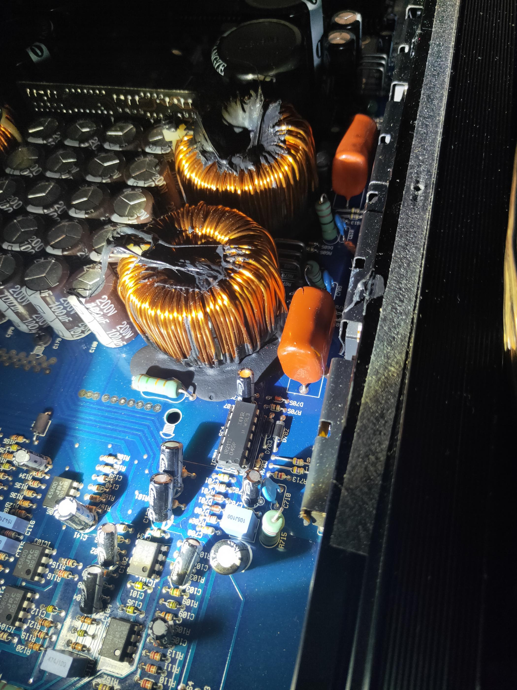

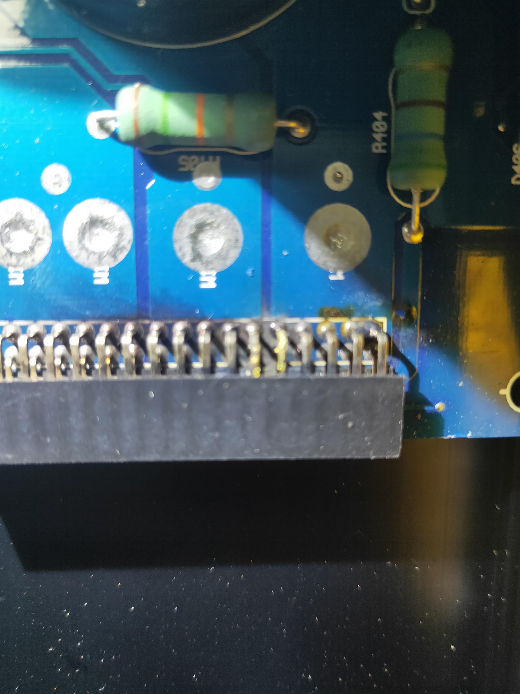

So just an update.
I replaced the b20k pot however it's still going into protect.
I had a bit more of a dig around and found the right input for the RCA has a broken rca shield off the board. This would explain the lack of power.
I have just organized to get it shipped out for repair as it will need a new rca input block. Something the company won't sell me.
As far as the protect. Well I don't have any idea. Hopefully the repair company will find the issue.

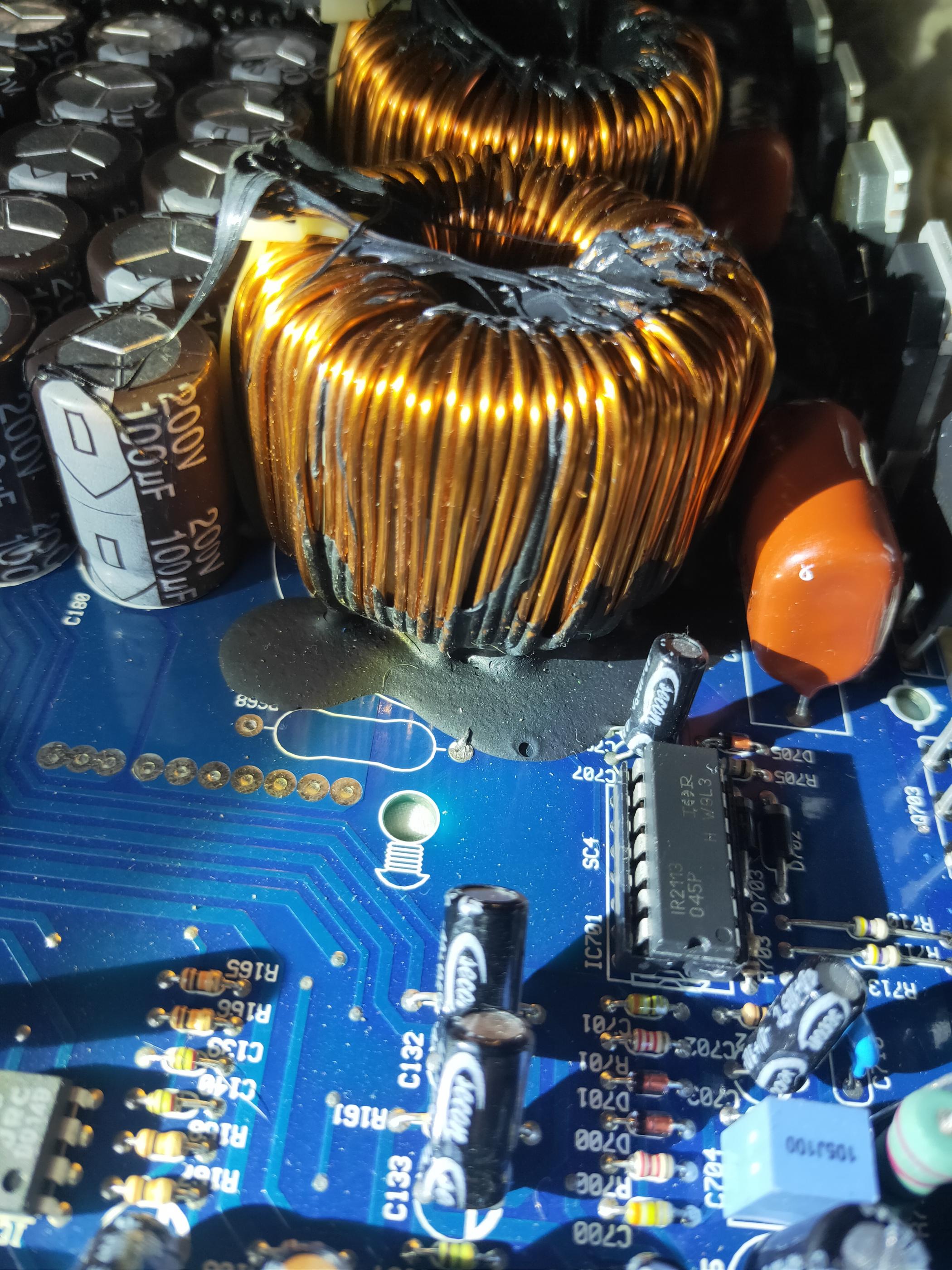

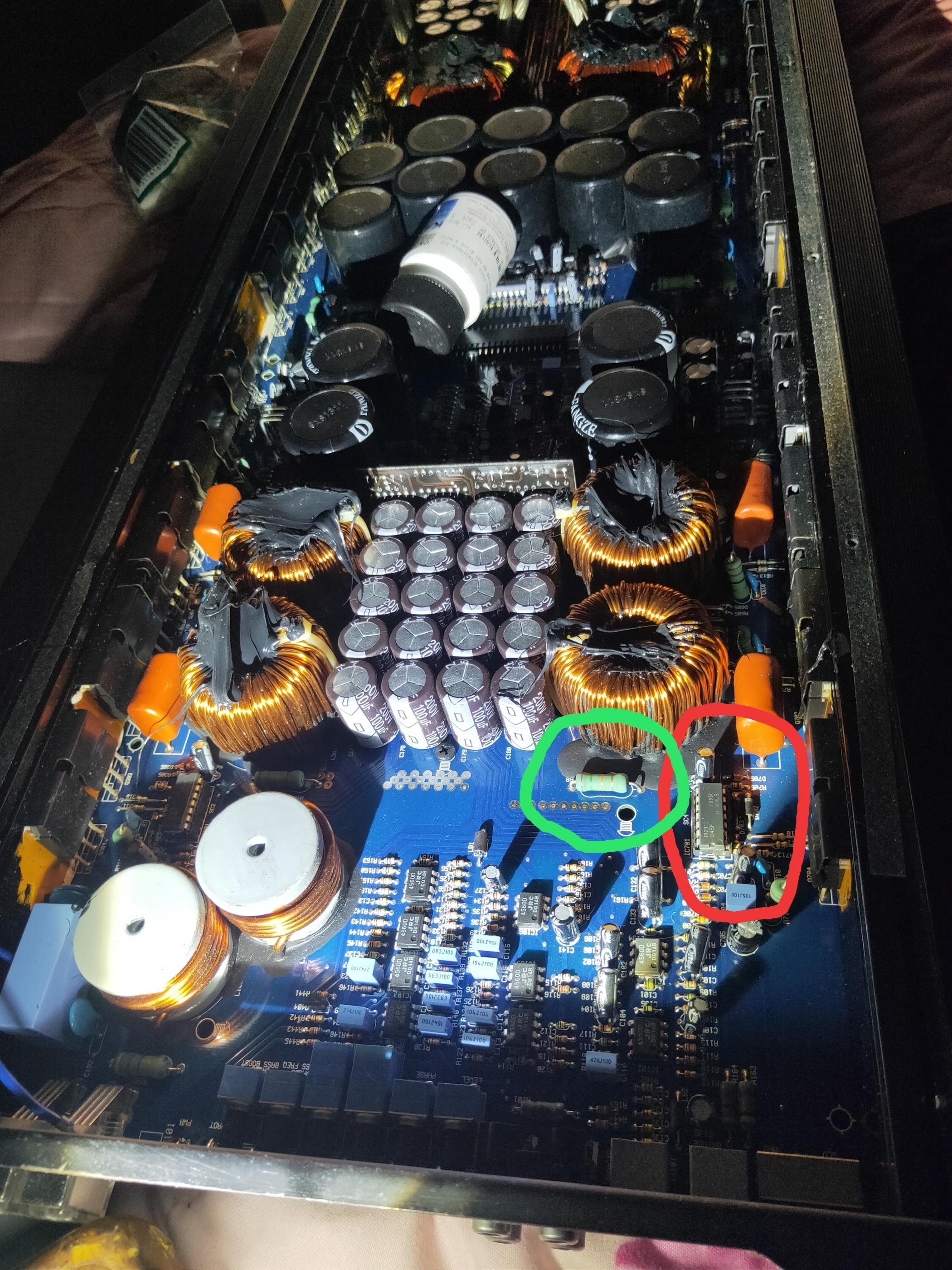

This was the results of the repair.
I knew ic109 was faulty!!!!!
Had no idea the diode was gone however.
They also replaced the rca terminal block as the ground shield was broken off the board they just forgot to put it on the invoice.
$116 for the repair. Plus an extra $90 shipping it to them coz it's so damn big and heavy!!
