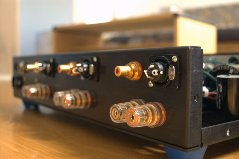

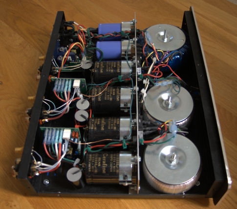

Been very happy with these over the past four years. Two chassis with 3-channels of Hypex modules - UcD180 x2 + UcD400 x1.
Mac, that is a beautiful amp. What kind of toroidal and rectifiers did you use?
Reason I ask is because I am building an amp with a target of 27 VDC and the toroidal secondary is 25 VAC--I know there is a voltage drop at the rectifier and a gain with the filtering caps, so I don't want to stray too much. Very well done BTW.
Looks like a Par-Metal chassis. Not the best quality in the world, but it's one of our few "local" options.
I was pleased with the chassis. Unless you want a show piece, which I admit, sometimes I do, then this is more than adequate. Inexpensive compared to some alternatives, easy to work on, fits together nicely, looks good, the company was easy to deal with and shipped quickly. This suited my needs perfectly and had vents already cut.
