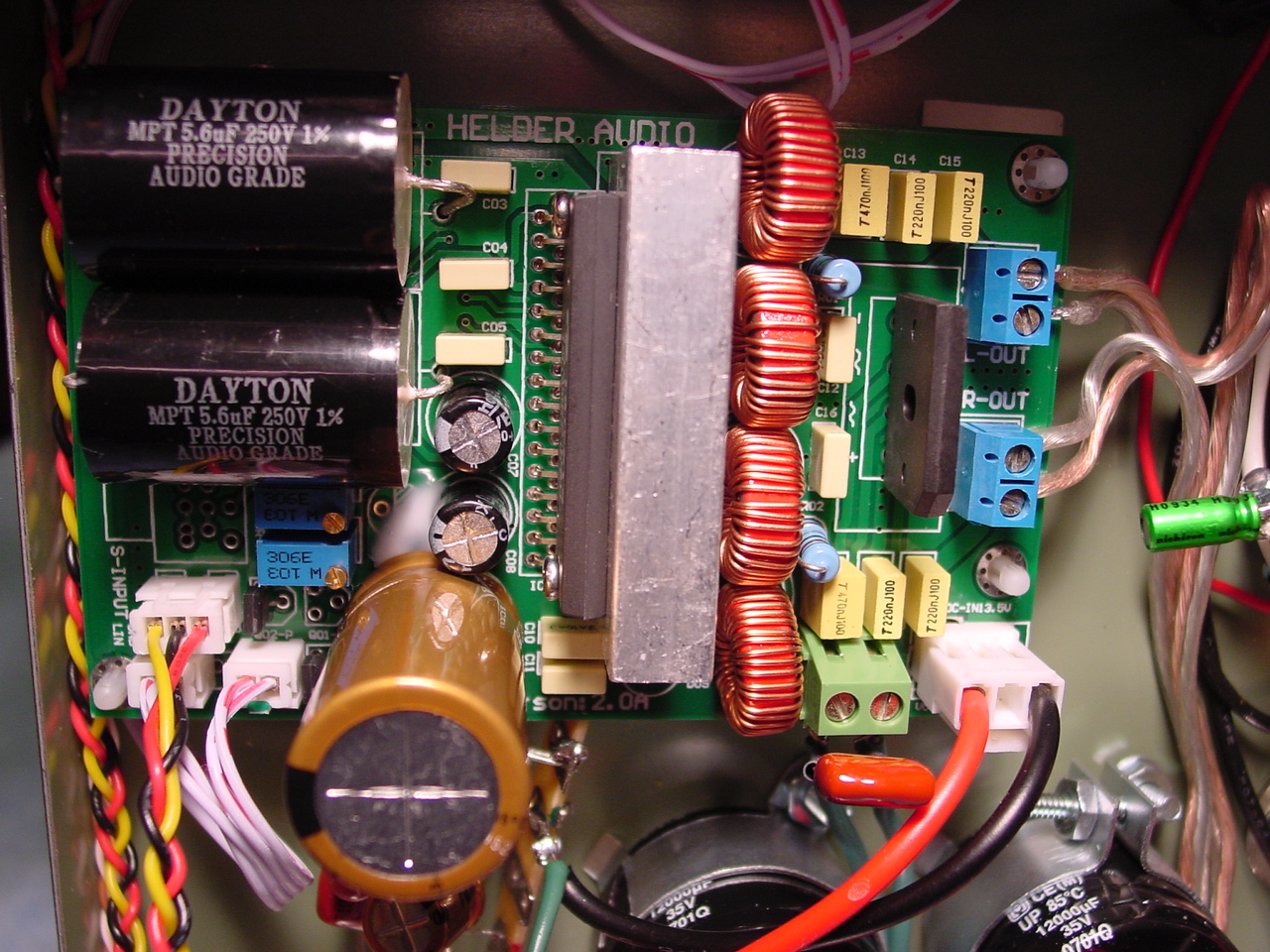

Some Helder TA2020 MKIII mods, input caps and buffer cap. These are great already, but this provides my ears a little more fidelity:

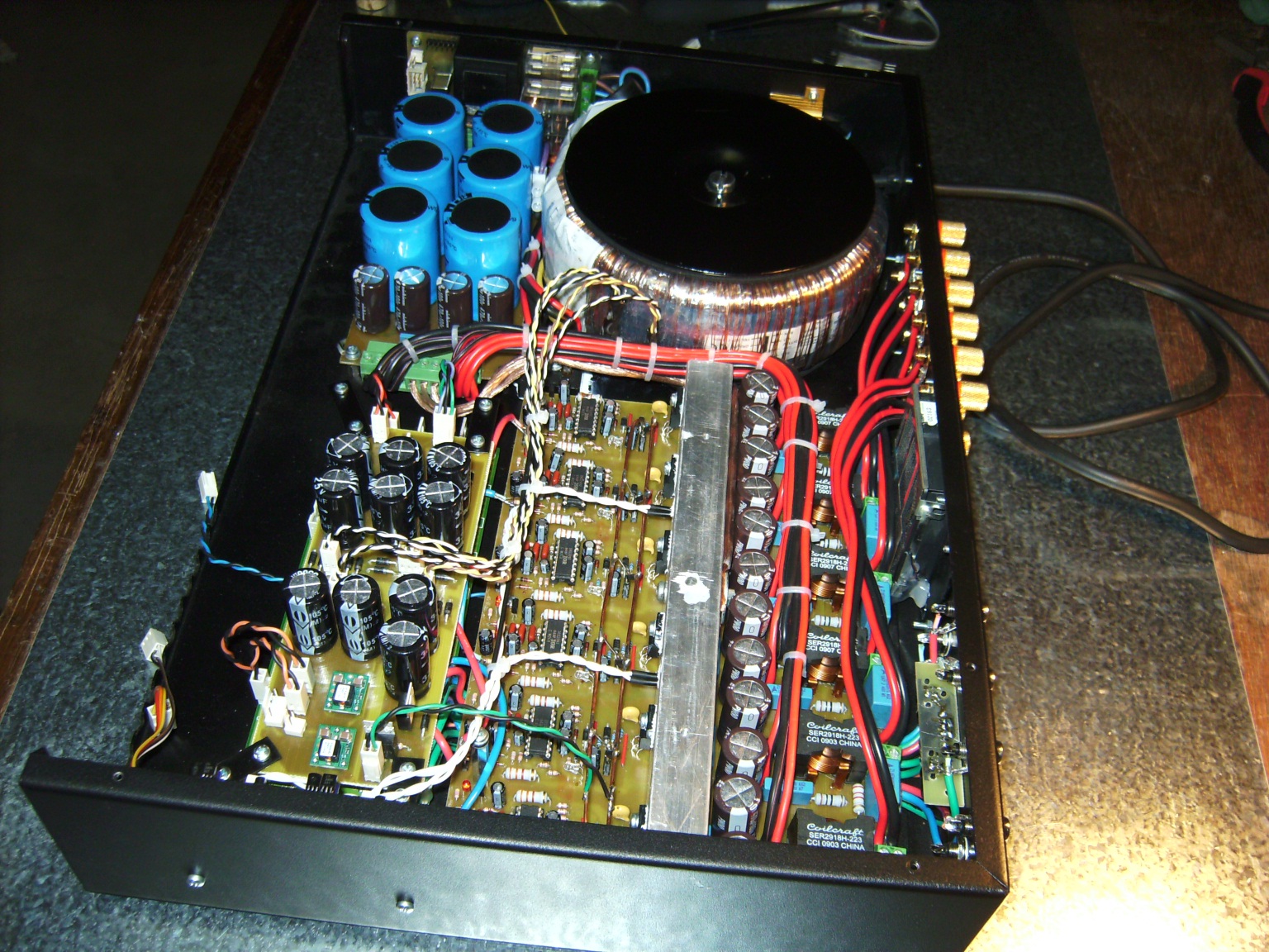

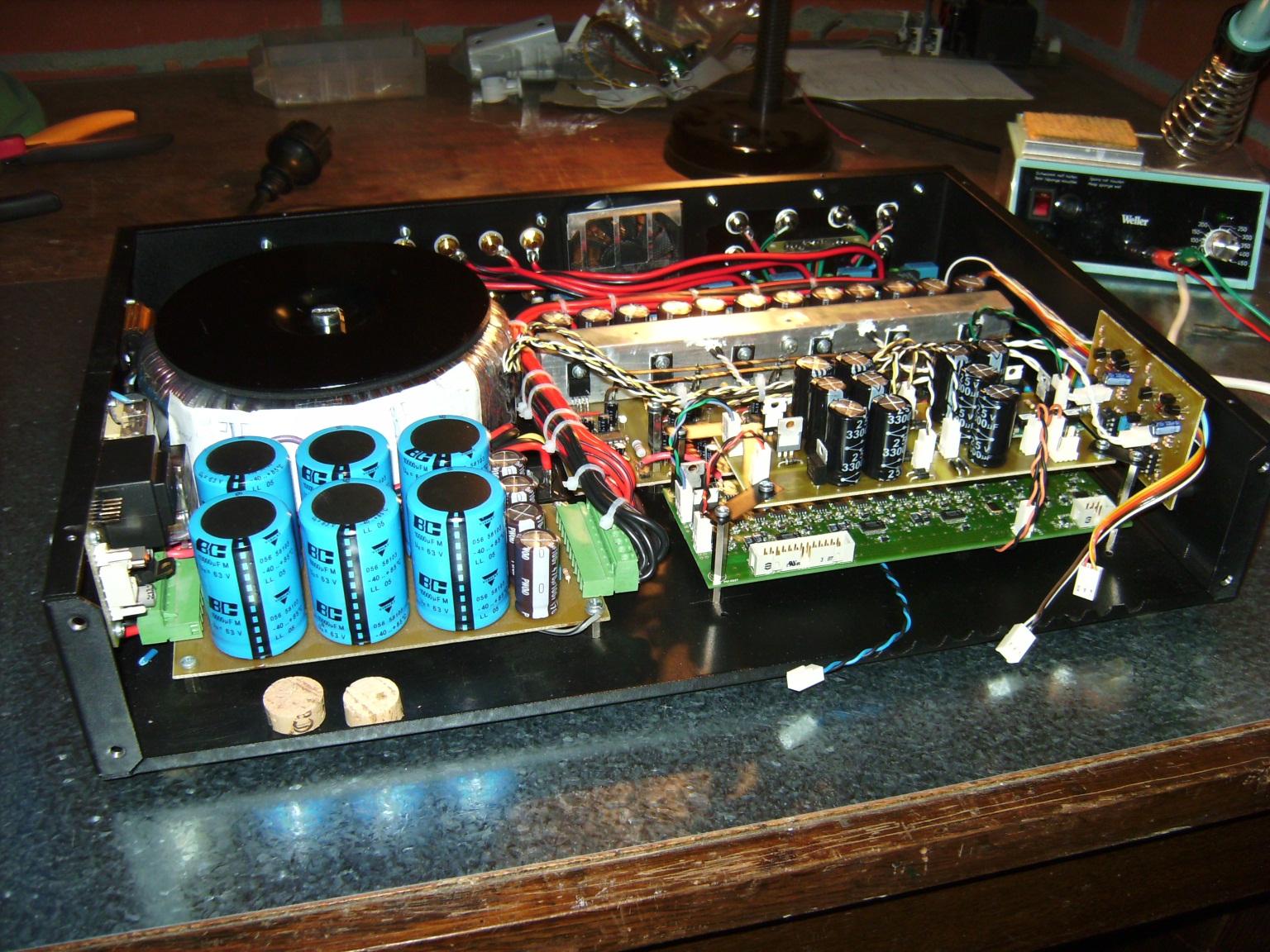

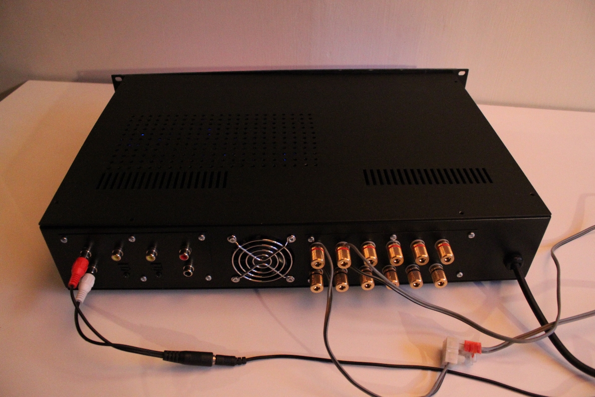

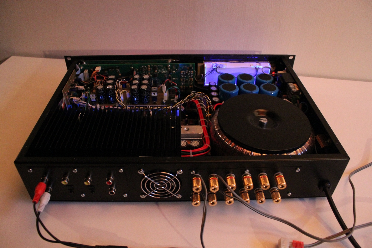

Here's my diy class D amp. The hardware is finally finished. There's still a lot of programming to do.
internals of the amp:
- 6 channel 300Wrms/ch class d amp (iraudamp based)
- 2 pcm1802 adc's
- 2 src4392 asrc's
- 3 tas3103a dsp's
- 3 dsd1794a dac's
- PIC24HJ256GP206 µC
- pic18f14k22 (stand by µC)
- 2 pcm1802 adc's
- 2 src4392 asrc's
- 3 tas3103a dsp's
- 3 dsd1794a dac's

Saveltech very nice project and also complex one too. How come you didn't use SMPS psu or it was just too expensive?
Best Regards
Alex
Best Regards
Alex
Hi Alex,
This project started as a college task and I had limited time to complete this. I've considered using an SMPS psu, but develop one would take to much time. I also had not enough knowledge of this subject.
Maybe something for the future. (8 channel with smps psu? I don't know yet, it would be verry educational)
Regards
Sam
Regards
Sam
uh nice, I like it. Any dsp inside or planed?
Yes, like I mentioned above, 3 dsp's from texas instruments tas3101a (one for each 2 channels)🙂
