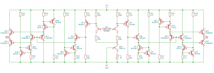

Dear fellow audio enthusiasts,
A second year electro student here. Since a couple of months I’ve been working on this power amp idea.
Design Constraints:
So far I snatched up one 2k5VA 3x25VAC toroidal, two 8k5g and one 6kg heatsinks, which id like to use. Yes, absolutely overkill. Total foorprint will NOT be a limiting factor.
I will keep developing the design before I order anything less general. This community has been of great help since I first posted here. Will purchase 'Power Amplifier Design' by D Self very soon.
The fully differential design so far uses a 2n3955 monolithic dual jfet at the input and a diamond-like output stage using NJW0281/0302. The VAS is still rather basic. Altogether, it does tick all my boxes. Nevertheless I am looking for a way to give each side its own common mode feedback to account for any asymmetries.
As I'm relatively new to this game, feel free to speak out against any of my reasoning. All of your thoughts and opinions are most welcome. I am here to learn.

Everybody loves those 2SK170 jfets. Digikey says their 2n3955 from Central Semi is a BJT. Why don't you use a silk rope to catch a unicorn?
I build or repair amps with MPSA06/56, or 2n5551/5401, or ST33078 or NE5532 or NJM4560. Parts I can actually buy from authorized distributors.

Seems like it ought to work, except you need common-mode feedback. I have no opinion on the JFET input. I don't generally use them, but a lot of people like them.
Most of the distortion will be in Q2 and Q3. I would have chosen to put an emitter-follower buffer before the Q2/Q3 stages rather than after. Q14/Q15 should probably be TIP42 instead of NJW0302, and Q16/Q17 should be TIP41 instead of NJW0281. The current sources Q6, Q7, etc are well done. I would replace R6, R7 with similar current sources.
The main problem I see here is there is no provision for common-mode feedback in this fully differential design. The output voltages will be within mV of each other, but nothing much holds them to VCC/2, other than low gain and bias stability (which is actually pretty low). DC common-mode output voltage, even it is initially VCC/2, will drift like crazy. Differential feedback won't help this, but it will make them track each other.

A little more help on the CM feedback:
You are manually tuning T1 to achieve your desired CM output voltage. Try to conceive of a circuit that would sense the average voltage of each output and adjust the current of Q26 to maintain the CM output voltage at VCC/2.
In other words, adjust I(Q26) until ((Va)+(-Va))/2 - Vcc/2 = 0.
There is plenty of literature on common-mode feedback out there. Controlling a current source with the common-mode error is a common method.

Those 2sk170's that I picked up on haha. It doesn't need to be there but it makes for an elegant little current source. Will replace it with a double btj current source like in the rest of the circuit.
The monolithic dual JFET I do really want to use. I have found the 2n3955 on shop.mocross, though expensive still somewhat available.

I have checked the power dissipation of each part and everything is nicely inbounds. Only the npn emitter follower and its current source are will dissipate about 100mW, bit on the hot side.
The NJW0XXX's will be snugly mounted to a 6kg heatsink I have here. Q15 is thermally coupled to Q25, Q17 to Q23 ect. As far as I know the NJW's and TIP's are in the right place when we consider dissipation. Any other reasons why there might me swapped in some places?
I will try swapping the npn driver and pnp follower, I see why they might be places the other way round.
Now the question really becomes how can i make sure this unit perform well in non ideal reality mainly considering the thermal runaway of the outputs. Somebody at PS audio already suggested the following:

I don't think that split supplies will gain anything for you, so your decision to stay with single supply is sound.
I did not know that you were thermal tracking the output transistors with Q15 and Q17. The flaw in your plan is that the Vbe tempco can be very different if the collector current is very different. Still, it will probably work, whether you use the expensive transistors or the el cheapo TIP41's and TIP42's. This is difficult to track with simulation because the modeling of tempco's is very bad in many discrete transistor models. Generally speaking, however, any silicon Vbe will track another silicon Vbe. (There are some exceptions.) To test thermal tracking, I've found no substitute for building it on the specified heatsink, and hitting the heat sink with a heat gun.
I still think your choice of transistors is OK, but I would be wary of the much lower Ft of the NJW0302/0281 with much lower collector currents. Probably still higher than TIP41/42. I was just trying to save you a little money.

Thanks again for your insights. Just looking at Q15/Q25 atm: Indeed Vbe of Q26 will be larger when more current flows, though as I understand it will drop as temperature increases. Still Vbe of Q25 could become larger than Vbe of Q15, would this be a problem?
I'm guessing I could try to simulate the output transistors (with fixed Ic and Vce temp vs Vbe, Vbe vs Ic)in isolation to see how well they are modeled compared to their datasheets. Its probably gonna be some trial and error in the breadboarding/prototyping phase anyway. I hope with the size heatsinks I got, it won't be too bad.
In previous iterations I was using TIP4X's instead of the NJW's. The NJW's gave me more performance and I like that they could potentially serve in a more powerful circuit and i'm okay with spending a little more here.

Dear fellow audio bliss seekers,
A quick look at common mode feedback got me wondering if this voltage controlled current source i had worked with before could be of any use. Sure enough in multisim it puts the output DC voltage right where we want it.
This solution was mainly driven by wonder and impatience as I have much research left to do on this subject.
I also tried some NFB and emitter resistors. Now the output impedance and top end phase shift are more than halved as simulated in multisim. Remember all these simulations take place in ideal virtual reality.

Hi Ruben,
You have the right idea about CM feedback. That does, indeed, work. The integrator cap makes it a differential version of a DC servo, with no worries about CM feedback stability. Probably perfect for your circuit, with a minimum amount of revision or fuss.
Your TL071 should be powered directly from VCC and GND. (VCC must stay below 40V.) The TL071 VCC/2 non-inverting input should also be 1/2 way between the TL071 supplies. There is no need to run the TL072 from a split supply.
If you decide you want a higher VCC, you can replace the TL071 with a PNP diff-pair that drives an NPN current mirror. The output of the current mirror IS the tail current. You can put a C between the summing resistors to limit BW.
That method throws away one of the outputs of the CM feedback diff pair. Another method is to keep a fixed tail current, but have CM feedback control the currents of the 2nd stages. You would replace R12 and R13 with current mirrors controlled by the CM feedback. That is the method used in differential amplifier ICs.
Just FYI, I am not suggesting you replace the TL071. You perfectly have the idea of a "servo". Let's make a slow op amp circuit continuously make the adjustment I've been doing by hand.

Please see the schematic of the complete (basic) PSU. These choices are driven by my intuition so I wonder: Is it actually beneficial to give each channel their own secondary side? Even though the secondary sides still interact with each other.
In short, yes it is still beneficial to give each channel it's own secondary. That way the channels will not share IR drop in the secondaries. Only core loss will be felt by the other channels. It's a close to dual mono as you can get.
Because your amplifier is differential, you are not drawing or returning any current to the center point. You are only using this voltage as the CM reference voltage. Using a resistor divider to create this voltage is just fine.Now here is the catch:
- The amplifier needs center point references at the input gate resistors and at the DC servo's positive input. Can these midpoints be defined without using a center tapped transformer (or two sec. sides in series)?
- Additionally the op-amp needs a negative supply with respect to the amplifiers ground. Is there any way to negate this?
In your PSU schematic, remove C2, C5, and C8. That will greatly increase your PSRR. Also, you are using a huge amount of supply cap for the size of your amplifier. Have you investigated if all that C will even fit in your chassis, along with a 2.5kVA trfr? I bet you could remove C10 and C11 and not notice any change in performance. 22mF would still be enough for each channel. Don't forget, you need to locally bypass VCC to GND on your amplifier PCB, and not just on the PSU board, regardless of the size of the caps in your PSU. At least 3 or 4 mF.
Indeed there's no need. I realized that I just need a gain device with a higher on voltage. With single supply the op-amp couldn't get the base voltage low enough. Using a mosfet current source eliminates this issue.
Thanks Russel, I'm liking your ideas. Before there was no real guarantee that Q1 was getting the right drain current. CMFB controlled current sources at the pnp voltages stages works around this.
You need an op amp with rail to rail output. It certainly does not have to be fast. Low noise and offset are what you care about. Take a look at the ADA4522-1. It also goes up to a 55V supply.

There are things in my own design I don't quite understand. Input to output is non inverting, so is the feedback i'm using actually negative feedback like I assumed?
