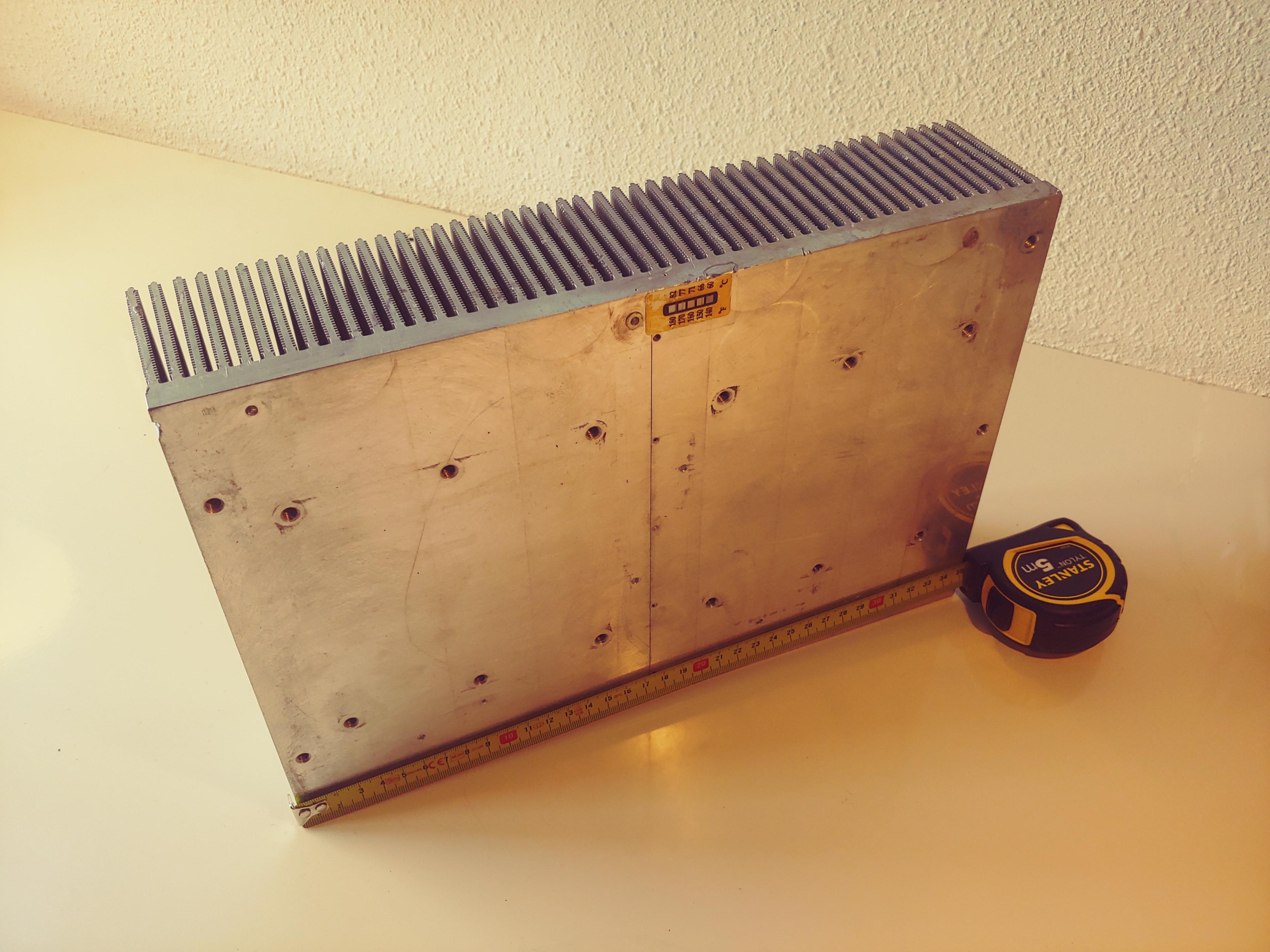

So far I snatched up one 2k5VA 3x25VAC toroidal, two 8k5g and one 6kg heatsinks, which id like to use. Yes, absolutely overkill. Total foorprint will NOT be a limiting factor.

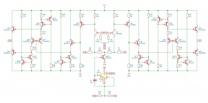

Seems like it ought to work, except you need common-mode feedback. I have no opinion on the JFET input. I don't generally use them, but a lot of people like them.
Most of the distortion will be in Q2 and Q3. I would have chosen to put an emitter-follower buffer before the Q2/Q3 stages rather than after. Q14/Q15 should probably be TIP42 instead of NJW0302, and Q16/Q17 should be TIP41 instead of NJW0281. The current sources Q6, Q7, etc are well done. I would replace R6, R7 with similar current sources.
The main problem I see here is there is no provision for common-mode feedback in this fully differential design. The output voltages will be within mV of each other, but nothing much holds them to VCC/2, other than low gain and bias stability (which is actually pretty low). DC common-mode output voltage, even it is initially VCC/2, will drift like crazy. Differential feedback won't help this, but it will make them track each other.
Be sure in your simulations to look at V x I for each resistor and Vce x Ic for each transistor. Raise power rating and heatsink where necessary. Nothing should be run at more than about 1/4 of its nominal power rating, and transistors at that power level need a small heat sink.

A little more help on the CM feedback:
You are manually tuning T1 to achieve your desired CM output voltage. Try to conceive of a circuit that would sense the average voltage of each output and adjust the current of Q26 to maintain the CM output voltage at VCC/2.
In other words, adjust I(Q26) until ((Va)+(-Va))/2 - Vcc/2 = 0.
There is plenty of literature on common-mode feedback out there. Controlling a current source with the common-mode error is a common method.

Dear fellow audio bliss seekers,
A quick look at common mode feedback got me wondering if this voltage controlled current source i had worked with before could be of any use. Sure enough in multisim it puts the output DC voltage right where we want it.
This solution was mainly driven by wonder and impatience as I have much research left to do on this subject.
I also tried some NFB and emitter resistors. Now the output impedance and top end phase shift are more than halved as simulated in multisim. Remember all these simulations take place in ideal virtual reality.

Hi Ruben,
You have the right idea about CM feedback. That does, indeed, work. The integrator cap makes it a differential version of a DC servo, with no worries about CM feedback stability. Probably perfect for your circuit, with a minimum amount of revision or fuss.
Your TL071 should be powered directly from VCC and GND. (VCC must stay below 40V.) The TL071 VCC/2 non-inverting input should also be 1/2 way between the TL071 supplies. There is no need to run the TL072 from a split supply.
If you decide you want a higher VCC, you can replace the TL071 with a PNP diff-pair that drives an NPN current mirror. The output of the current mirror IS the tail current. You can put a C between the summing resistors to limit BW.
That method throws away one of the outputs of the CM feedback diff pair. Another method is to keep a fixed tail current, but have CM feedback control the currents of the 2nd stages. You would replace R12 and R13 with current mirrors controlled by the CM feedback. That is the method used in differential amplifier ICs.
Just FYI, I am not suggesting you replace the TL071. You perfectly have the idea of a "servo". Let's make a slow op amp circuit continuously make the adjustment I've been doing by hand.

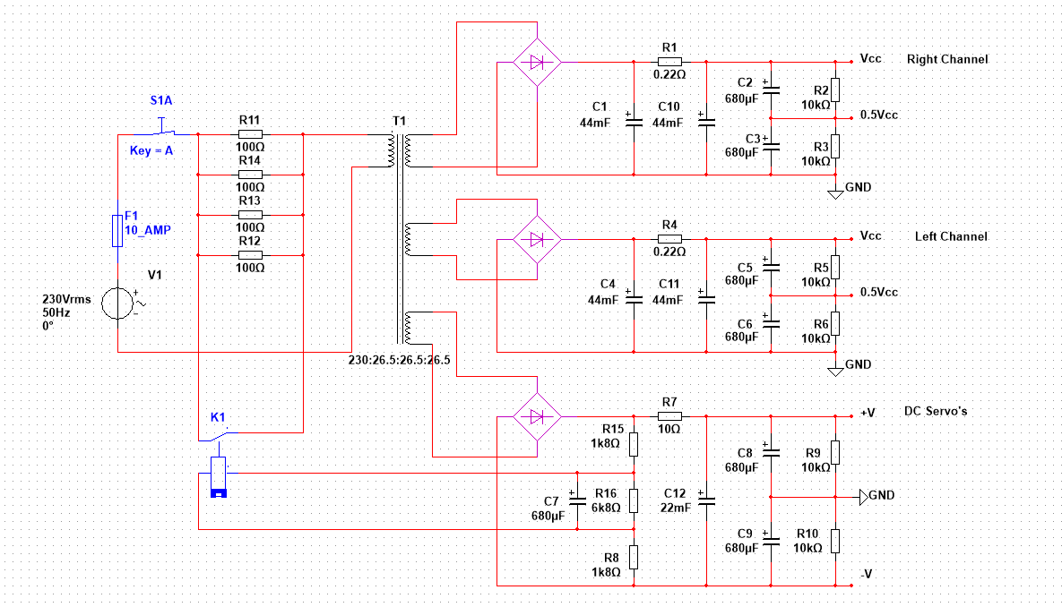

That's a big transformer. Whoa. I'm planning to power my 200 Wpc amp with an 800 VA trfr.Meanwhile I got a stellar deal on a 2k5VA toroidal. 3x25VAC.
I was planning on using one secondary per channel and the third for the 'DC babysitters' and a relay.
I would put the DC babysitters for each channel on the same supply as each channel. Then use the third tap to power several nice tubes on the circuit board , to give your amp a warm tube glow. (Don't connect them to your audio signal path.) OK, maybe don't do that.
Still, I would use one secondary for each channel, along with it's supervisor circuits. Basically don't use the 3rd secondary, except maybe to power a Jacob's ladder that runs a spark gap on a shelf over your amplifier. Ok, maybe don't that either. Or you could power a laser light show and listen to Dark Side of the Moon. I cannot think of a good reason to not do this.
More sensibly, for the third secondary, you could make a third channel to power a subwoofer. Hey, that sounds like a practical idea. Until you build that third channel, just tape off the secondary leads, and tuck them away.
Please see the schematic of the complete (basic) PSU. These choices are driven by my intuition so I wonder: Is it actually beneficial to give each channel their own secondary side? Even though the secondary sides still interact with each other.
In short, yes it is still beneficial to give each channel it's own secondary. That way the channels will not share IR drop in the secondaries. Only core loss will be felt by the other channels. It's a close to dual mono as you can get.
Because your amplifier is differential, you are not drawing or returning any current to the center point. You are only using this voltage as the CM reference voltage. Using a resistor divider to create this voltage is just fine.Now here is the catch:
- The amplifier needs center point references at the input gate resistors and at the DC servo's positive input. Can these midpoints be defined without using a center tapped transformer (or two sec. sides in series)?
- Additionally the op-amp needs a negative supply with respect to the amplifiers ground. Is there any way to negate this?
In your PSU schematic, remove C2, C5, and C8. That will greatly increase your PSRR. Also, you are using a huge amount of supply cap for the size of your amplifier. Have you investigated if all that C will even fit in your chassis, along with a 2.5kVA trfr? I bet you could remove C10 and C11 and not notice any change in performance. 22mF would still be enough for each channel. Don't forget, you need to locally bypass VCC to GND on your amplifier PCB, and not just on the PSU board, regardless of the size of the caps in your PSU. At least 3 or 4 mF.
Other options would be:
- Using separate toroidals (300VA budget limit) for each channel and tiny (10VA) ones for each servo.
- Using the two 1k25 secondary's in series for a bonkers 60something volts as the amplifier circuit should be easily modifiable for more power. However, now both right and left will share the power supply completely.
I thought you already bought the 2.5kVA toroid. Just power the servos from the same supply rails as each channel, and skip the tiny transformers. Because your amplifier is differential, I would stay with the 35V VCC. A separate transformer for each channel is cool, if you can afford that. Most DIYers cannot, and just have the channels share the supply.
Putting two of the secondaries in series, with the channels sharing, is what I would do for my power amplifiers, but none of them are differential.
If you already possess the 2.5 kVA, you could put it aside until you build the big brother to the design you've shown.
Indeed there's no need. I realized that I just need a gain device with a higher on voltage. With single supply the op-amp couldn't get the base voltage low enough. Using a mosfet current source eliminates this issue.
Thanks Russel, I'm liking your ideas. Before there was no real guarantee that Q1 was getting the right drain current. CMFB controlled current sources at the pnp voltages stages works around this.
Using the third secondary for a sub is a great idea! I definitely don't need it in my room but still its nice to have that option.
Yes I have bought the 2k5 unit second hand much cheaper than new 300VA units. If I don't use it for this project it will find its place.
Is 22mF enough even when drawing 15A occasionally? Is what I was asking myself so I ordered more. 16 pieces 22mF 50V but they've been held at a local sorting facility for weeks
I was planning to give the PSU its own casing and have decided not to let space be a limiting factor. Did not know I needed 3 or 4mF on the amp board. Ill most likely give it 22mF on the amp and 44mF on the PSU.
You need an op amp with rail to rail output. It certainly does not have to be fast. Low noise and offset are what you care about. Take a look at the ADA4522-1. It also goes up to a 55V supply.
