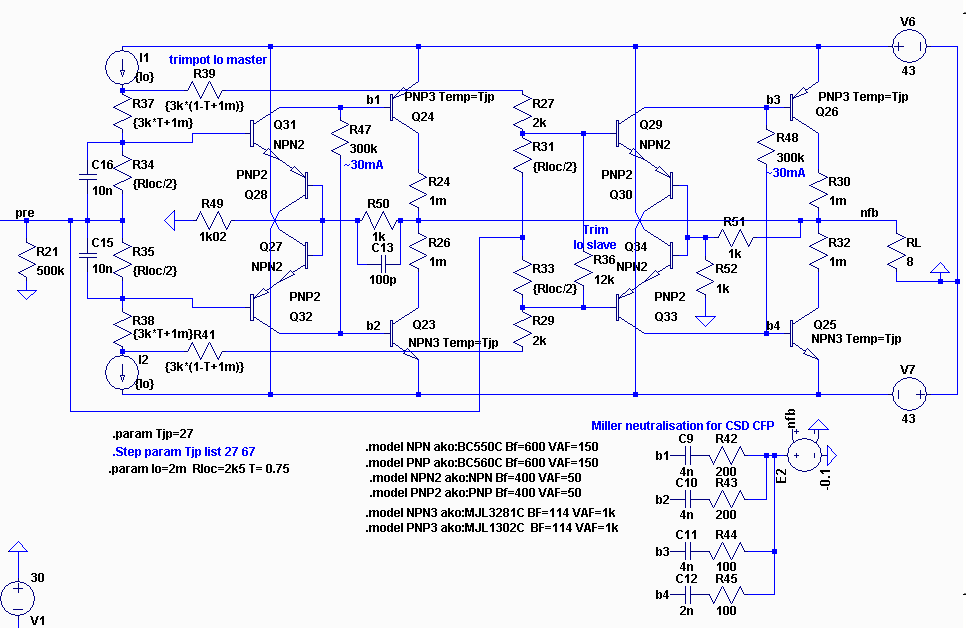

Hey, Ian, Your schematic, the one based on FAST configured drivers, it gives the fuzzy gut feeling that it should work OK. Work quite well, actually. Did you not ever feel the urge to actually build it and see how it sings?

Hey, Ian. Did you ever play "chicken"? Risky business ...
Suppose that someone wants to build a practical circuit based on your schematic. One of the very first "challenges" that would come to mind is how to provide comfy stability to the pair of transistors that are sweating at quite a high standing current.
According to your wing-spread model, one pair of output devices (the "sleepers") are idling at a trickle of 3,5 mA, as calculated on your Sheet2. These - I would not worry about, for the time being.
But what worries me is the other pair of output devices (the "hard workers"), which even at idle conditions, are getting a beating with an idle current of 310mA. The first concern is: How does one ensure stability of this standing current, so that it does not wander off into thermal run-away and self destruction of the device(s)?
Did you do any sensitivity analysis for these devices, as to how stable is their standing current and what possible "thermal feedback" mechanisms could be put in place, so as to maintain optimal biasing, and guard against gross thermal run-away, as the temperature and associated Vbe changes unfavorably? For classical AB stages, a bias generator ... exists. So, there are known paths to pursue, such as putting the bias generator transistor in close thermal coupling with one of the output devices, plus possibly some additional tricks to ensure optimal biasing, for a wide range of operating temperatures.
But I can't even start to envision how one could ensure similar stability in your circuit. For starters ... it does not even include a bias spreader. So what would be the subject of "thermal stabilization"? The current sources/drains? But HOW? Putting the current source transistor on the heat sink - would actually be counter-productive: Higher temperature ==> lower Vbe ==> higher voltage drop on current-programming-emitter-resistor ==> higher current from the CCS ==> thermal runaway(?)
My assumption would be, that as the output devices get hotter, thermal stability would require that the CCS actually goes down with it's current. True? Maybe some form of "Differential CCS", where the "other" transistor is on the heat-sink?

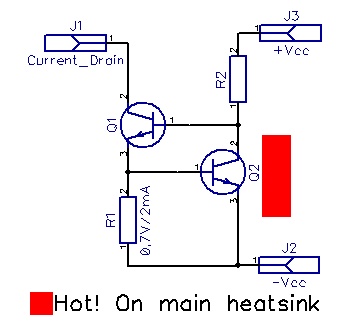

If you were to apply some thermal/DC negative feedback just for the output stage, how would you do it?
If I heat up the transistor Q2 within a dual-transistor CCS, the current of the CCS will decrease. Correct?

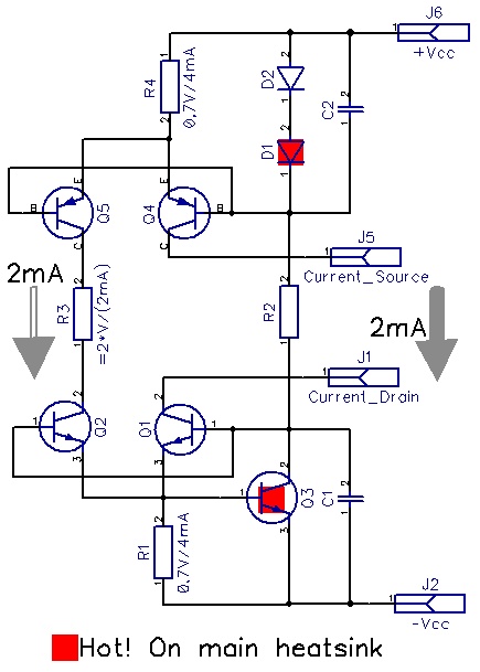

Question: will this circuit work?
The goal is to create a pair of related (affinity, non-contesting) Thermally modulated Constant Current Source and Current Drain, exhibiting negative thermal feedback capability.
My idea being: The lower transistor Q3, mounted on main heat sink, will serve as a temperature sensor. Higher heat sink temperature shall reduce it's Vbe and hence reprogram the Constant Current Drain to a somewhat lower CCS current.
Lower Current Drain is actually comprised of a set of mirrored transistors Q1, Q2.
It is the sum of their currents that is held constant.
The upper side of the circuit is equipped with a current mirror, forcing equal currents through Q4, Q5. Instead of a third transistor, it is just two series connected diodes up there, to bias the bases. No transistor there, so as not to antagonize the Upper Source and the lower Drain. The upper "programming resistor" is just for the sake of symmetry. Does not perform any hard-core programming.
Will this work, as a means for additional thermal stability, in the context of Ian's double wing spread schematic?

Standard biasing can be used for this type of amplifier, eg Bob's DoubleCrossTM (aka Class-AB+C) since it is simply two standard output stages in parallel. Bob Cordell's gives several method for biasing his DoubleCrossTM (aka Class-AB+C) that he tested. Have you read it yet?
Biasing in my CSD Class-AB+C topology is a completely different approach since the power transistors are current driven and do not need a thermal bias loop to prevent thermal runaway. But the driver transistors need thermal compensation (mainly for ambient temperature changes).

Hi zjjwwa, ALL,
Attached is a snippet of my Linear Audio Vol.13 article to help explain it. Thermal sensitivity of the power transistor's idle current is less with current drive than the usual voltage drive. Also the crossover function (and hence optimal bias for minimum crossover distortion) is not affected to a first order approximation by temperature changes of the power transistors because crossover is done by the drivers.
Temperature increase of the power transistors increases the Beta (current gain) causing an overall gain increase which occurs relatively slowly -- it does not affect the optimum bias setting for the driver stage -- so there is no increase in crossover distortion when the power transistors heat up. My measurements showed this.
