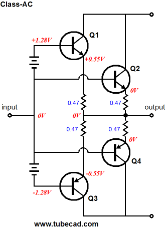

Specifically, I am mulling about things I read in this article:
CCDA & Class-AC
(Thank you, John Broskie!).
Even more specifically, about this very picture:
https://www.tubecad.com/2009/11/12/class-ac.png
If you look at the bubbles closely, it basically looks like "two paralleled typical AB output stages" ..... but with two series connected bias generators, and a very specific way of connecting the four driver transistors.
My draft of a possible ABC class output stage looks more or less like this:
Tell me what you think. Any pitfalls here? Pro's? Con's? Do's? Don't's?
The only down side of such an AB+C architecture that I see is that it will not achieve as much peak to peak output signal swing, as in the case of a typical class AB amplifier, with a single cross over area. What am I missing?
Ziggy.

I am generally aware o the conduction angle being substantially less than 180 degrees in Class C. Not sure though, does the 'large amount of harmonics' apply in this particular scenario.
The general idea is to "pair up" the conduction angle of Class C, which is significantly less than 180 degrees, with a conduction angle that is appropriately substantially more than 180 degrees, so as to jointly achieve a seamless "cross-over" .... but not necessarily at the zero-signal point.
Please take a look at the conduction angles of the four transistors within the concept, as depicted:
Transistor Q1 is "paired-up" with transistor Q4. When the one stops conducting, the other takes over.
Similarly,
Transistor Q2 is "paired-up" with transistor Q3. When the one stops conducting, the other takes over.
Both of the aforementioned pairs have their own "cross-over" point.
But both of these points are in a different place, and none of these points coincides with the "zero-signal-crossover" point.
To say more: At the cross-over point of Q1 and Q4, when the transition occurs, the other pair of transistors is in a state of stable continuum, i.e. works so as to "alleviate the ripple". And vice - versa.
Jointly, the four transistors seem to be working in a "constant gm" mode, with no gm doubling in any area: At any point and at any time, it is always exactly two transistors that are conducting.
Does this seem feasible and doable in light of what you wrote earlier, or am I missing something ?

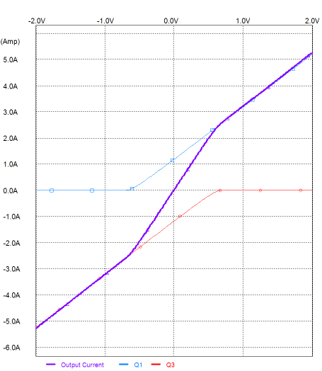

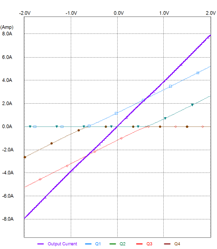

I also attach three graphs from Mr. John Broskie's article ( CCDA & Class-AC ), to better show the two transition points.

Please look at the picture with the conduction angles of transistors Q1..Q4 in post #6. Indeed, these are two "Class B" outputs. Working in parallel. But there is a small trick here: each of these "Class B" outputs has its hand-over point at a different place. So at the time when one of the "Class B" outputs is undergoing a hand-over, the other one is within stable conduction of one of the transistors in its pair. In other words, the "Other Class B" unit is under continuous (kink-free) conduction, of quite a healthy current, that may serve to "swamp and hide" any of the "hand-over-artifacts" of the "Class B" unit that is undergoing the handover.
"One Class B" stage would have its single hand-over point, and to make it worse, this hand-over point is exactly at the zero-signal crossing.
As the "One Class B" stage will probably have more than one pair of output devices anyway, with the output devices readily available, so why not give this concept a chance?

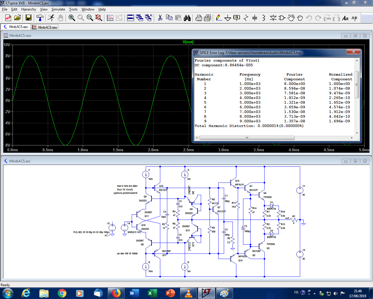

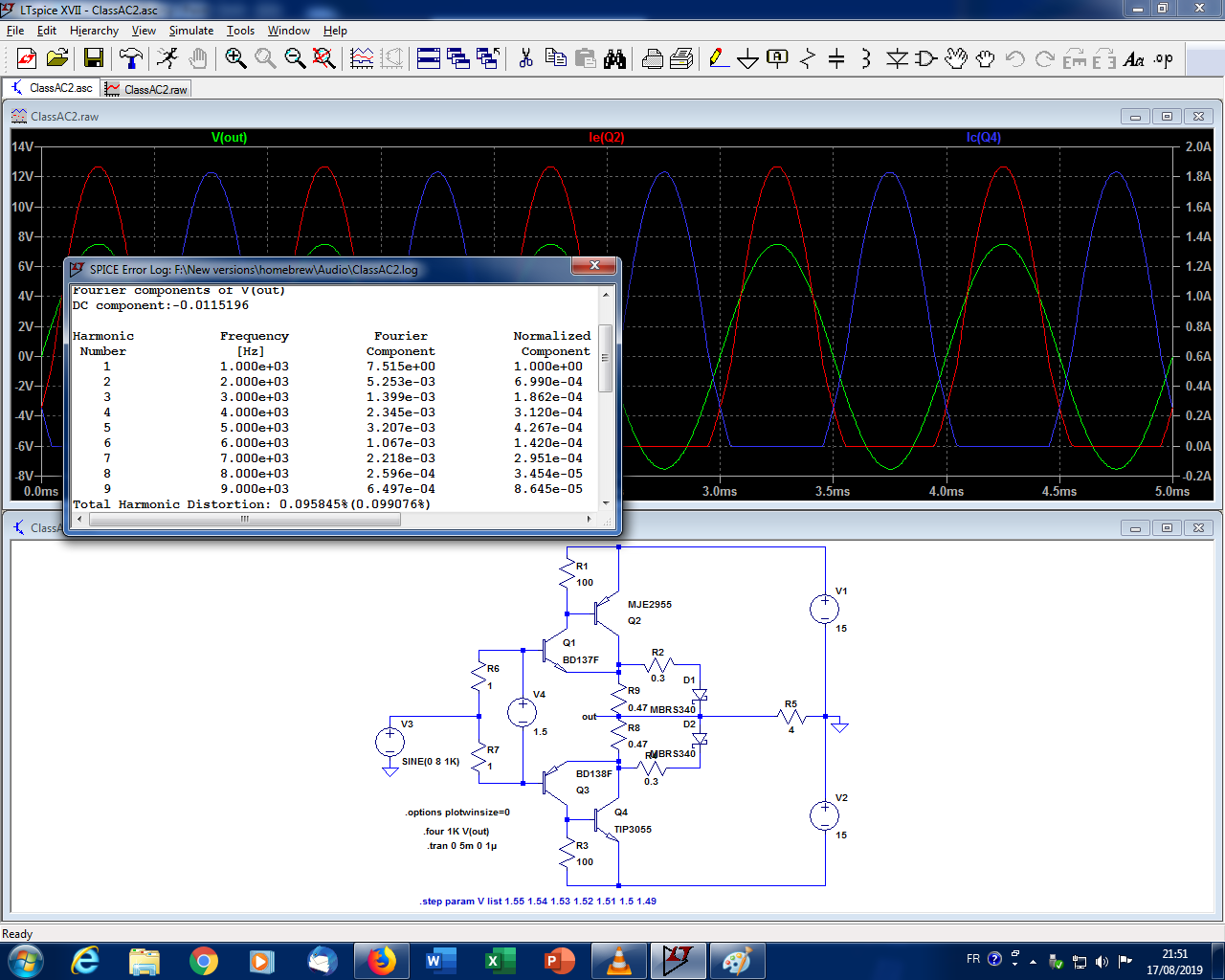

Yes, I did about 7~8 years ago.
I didn't actually use the extravagance of two actual Class B stages in parallel, instead I used a single stage, and breakpoints provided by diodes and resistors.
Conceptually, the end result is exactly identical, but the cost is halved.
It is possible to obtain quite good results: here are some sim results of that time (one prototype must still be gathering dust somewhere in a crate).
First, the naked OP stage:
attachment.php
Note the two-current slopes characteristic of the AC class, and the THD for the OP alone which is already <0.1%, without FB or anything.
When such a stage is included in a complete amplifier, the THD falls at a (certainly fictional) level comprised between 0 and 10ppb, depending on the evaluation method:
attachment.php
I didn't retain it in the end, because the quiescent current needs to be really high, between 0.25 and 0.5A minimum, which generates a serious amount of heat

Hey, were those diodes of a normal forward voltage 0,7V, or did you try to use some low Vf schottky types, or something?
My idea for bringing the power dissipation down on such a scenario would be to actually increase the value of the emitter resistors and at the same time - try to find a type of diode that is both quick, but with a low forward voltage at the same time. With a lower Vf, the bias current could be smaller ...
I also noticed that the value of your resistors in the "diode-bearing" branch is significantly LESS than the value of the resistor in the "non-diode-bearing" branch. Is this a result of your Spice simulation optimizations, or did you come to these values by means of some theoretical concept / theory / calculation?
Why are they so ... small ?

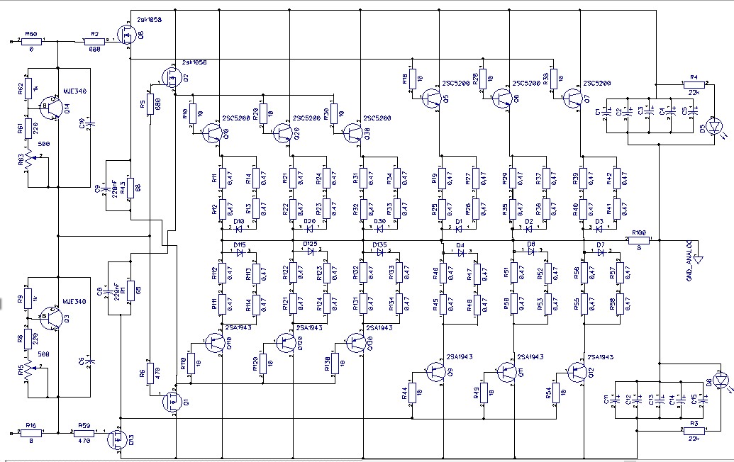

The Yamaha M70, if I understand the OPS schematic correctly, uses a fairly simple scheme with the 4R7 resistors ladder, but I perceive that solution as not ideal, because it actually results in a different current loading of the output transistors, which is not ... "cool". (Or at least, that is how I understand the circuit).
What I would be searching for, is basically to find a KISS (Keep-It-Simple-And-Stupid) approach/architecture, that implements the two-crossover-points concept, and each of them - not at the zero-signal-crossing point. With equal current loading of the output transistors.
Would be even better, if this quickie KISS solution could be "embedded" with no hassle into the existing architecture of some proven "classical AB" amplifier design. (as the Ovation e-Amp, for example).
Having a bunch of 2sc5200/2sa1943, and 2 x 0,3K/w radiators per channel, I am trying to find a nice idea for building something more than just a "classical AB OPS with paralleled pairs of output devices".

Kind thanks for your valued inputs.
If you look at their type N°, you will see that the diodes of both examples are schottky
IIRC, I made a crude arithmetic estimation based on fixed voltages (300mV) and no internal resistance which I used in a sim, where I refined the values to take into account various real-life effect: junction equation, ohmic resistance, etc.
The values ended up rather low for the C branch, because the diodes have a non-negligible resistance of their own
