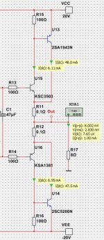

How about this output stage?
It is CFP.
How to think and design for best result?
SPICE shows 54mA bias at 1 Watt for lowest distortion.

What about bypassing the emitter resistors with capacitors to reduce the local feedback, but retain the positive effect of the resistors on the DC and temperature conditions? Kinda like with the cathode resistor in triode input stages. Could that actually work? There are supercapacitors now, which pack 50 Farads at ~20mOhm ESR, able to withstand 30+ Amps; the voltage rating of 3V should be adequate in this case. Didn't get around to simulate this, but stumbling on this thread just made me remember this idea.
Those resistors do very little to stabilise bias, they are more often for output protection. Just 20mV is inot enough to control thermal run away
20mV? At 50mA bias 0.2 ohms gives 10mV total.Those resistors do very little to stabilise bias, they are more often for output protection. Just 20mV is inot enough to control thermal run away
Still, I agree with your point with a proviso that a well designed bias stabiliser MIGHT be able to control quiescent current. Not the usual one transistor circuit though.
All this assumes a constant bias voltage, which is typical but not a given. Have a look at LVs "Tandem" regenerative driver bias, which cancels the output Vbe (+Re) with a ~diamond driver Vbe. The generative bias means the (diamond) driver current and OP current are in phase instead of inverted. I'm sure there are more ways to mitigate the EF distortion. Perhaps it becomes a moot point as this topology is good enough for most applications and irrelevant for those who want something "better". Thermal stability often pushes the bias down to less-than-optimal THD settings. Very few customers actually care about THD less than 0.01%. Stability, reliability & ruggedness, and clean clipping are more important.
Yes, the point I was making was that the voltage drop across your typical 0.2 Ohm emitter resistors is so small, that it does not contribute much to thermal stability., although that is what is claimed all the time in design articles and text books. They usually exist to trigger current limit circuits when the voltage across them reaches around 0.6V20mV? At 50mA bias 0.2 ohms gives 10mV total.
lineup - The CFP requires a more complicated analysis. It has two exponentials and twice as many crossovers.
For the emitter follower, I can safely ignore the driver stage because it runs in class A in my amplifier.
As you can tell, I like the emitter follower.

In Distortion in Power Amplifier Douglas Self found that CFP had lower crossover distortion.
http://www.douglas-self.com/ampins/dipa/dipa.htm#2
lineup - Interesting. The distortion caused by the emitter-follower driver stage can be reduced by applying more bias and using higher Hfe output transistors.

Unfortunately there's another thing which actually is problematic. The currents through the emitter resistors are highly asymmetric and don't roughly cancel out, like the whole signal usually does. Thus there's a substantial charge buildup in those capacitors, which then act like batteries and push the output transistors deep into cutoff. Bummer. Temperature compensation looks like a breeze, once you increase those emitter resistors to 10 Ohms each.
In a class AB stage, the resistor voltage is not constant. You may set it to 0.025V at idle, but a 3 Amp peak in 0.22 Ohms is 0.660V. The emitter will charge-up the cap very quickly. After that the transistor is BACK-biased about 0.635V, or nearly-off, until the charge on the cap leaks off.What about bypassing the emitter resistors with capacitors to reduce the local feedback, but retain the positive effect of the resistors on the DC and temperature conditions?
Also: what value cap do you propose? To "bypass" 0.22r down to 50Hz is 15,000ufd; nearly 40,000uFd or 40mFd for 20Hz (because crossover in a subwoofer may be extra offensive buzz).
This blind alley is nearly 70 years old. Emitter/source/cathode caps for speech/music MUST work class A.
