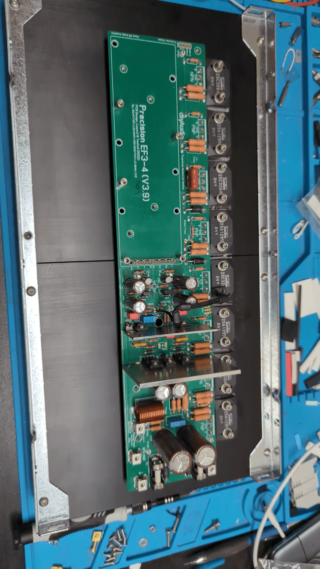

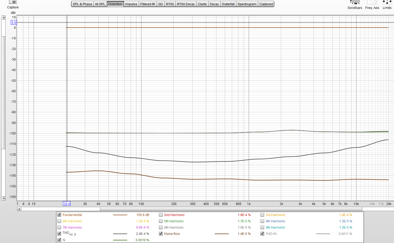

I've included a fully range distortion plot sweep of the Wolverine EF3-4. No bandwidth limiting, full range to 384khz
The plot is 25v or 80WRMS driving an 8 ohm load.

stuartmp - Your measurement of the Wolverine's distortion has caused me to re-think my approach to amplifier design.
The measured 0.00024% THD is lower than I thought possible. It is so low that the analyzer has to fish the distortion products out from below the THD+noise floor. Both the Wolverine and the analyzer are performing incredible feats of engineering.
The low distortion is achieved through high global feedback (I estimate ~50dB). The Wolverine has high-open loop gain with effectively one more gain stage than my amplifier. The Wolverine is quite similar in design to an IC op-amp. The high negative feedback is made possible by fast power transistors (Ft=30MHz).
In contrast, my amplifier traces its origins to the "Low TIM" school of design. I designed each stage to be highly linear and applied only 23dB of global feedback. Linear stages are possible for all but the last which has to handle huge current swings. The open-loop gain is moderate and the frequency compensation is mild (dominant pole >20KHz).
This is a conservative design because it can run open-loop and still be a respectable amplifier. The downside is that not much global feedback is available to linearize the last stage's exponential.
I estimate that my design achieves 0.015% THD. This is below the threshold of audibility but would be measurable without a sophisticated analyzer.
The question in my mind is what downsides are there to pushing distortion much lower through global feedback? I think that feats of engineering are fine only as long as they do not worsen other attributes of the design. I think I am going to stick with the low-global-feedback approach unless I can convince myself that applying more feedback has no downsides.
