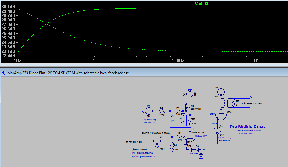

Here's my 833 amp sim. At the output to the 833 grid, -3dB is 2Hz, with a .22uF cap and 1Mohm resistor to ground in the gyrator.
That's low enough in my estimation, and I can fit a nice Duelund CAST on the driver board.

Just one question: why such a large cap in the gyrator/mu follower? You have a corner frequency of 0.03Hz when combined with the 4.7M +220K resistors. You could easily drop that to 0.22uF or even lower. Smaller caps usually sound better provided they achieve the required corner frequency, IMO, and they are cheaper, too!

Thanks for spotting out the cap value. I went back through my notes and found that originally calculated a 100nF cap for 1Hz-3dB corner but somehow I wrote down 1uF. It happens that I have some 1uF caps around so I just went ahead without checking this again! The Amp -3dB corner is primarily driven by the output stage LF response which should be around 7Hz. Haven't measured it yet though. Of course using a lower cap is better from a sound perspective so will look at buying some to test the difference.
A 220nF will provide 0.5Hz corner. The 1uF one gives a -3dB point of 0.15Hz which is completely unnecessary.
At the moment I have at hand for testing: 1) Mundorf MCap EVO SilverGold Oil and 2) Obligato Premium. Both are 1u ones. Will need to buy some good 100nF ones and try them and compare!

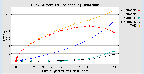

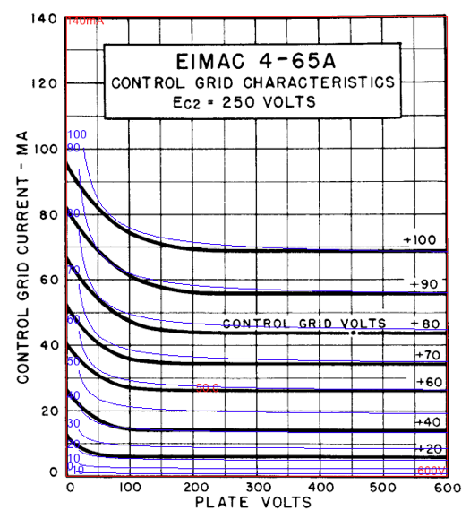

The THD response will be very much dependent on the model you are using for your valves. Specially whether these have a good approximation on the grid current and yes, it will be higher on odd harmonics in class A2. The challenge is also to fit the anode curves with positive grid bias, as this will also impact the THD levels as curves get shrunk at higher grid positive voltages. My tracer has its limitations but I'm closely to build my version of the uTracer which allows you to trace positive grid bias curves very easily (and safely).
I refined my 4-65a DHT model to better match the grid current as attached.

Good to see that your experimental data has the same trends as my simulation data, in terms of THD, and the fall off of 2H and rise of 3H and higher as you go deeper into class A2.
Of course the absolute amounts of distortion need to be taken with a measure of caution in the sim since there is no accounting for imperfect voltage sources, tube models and the like, but the trend data is interesting.

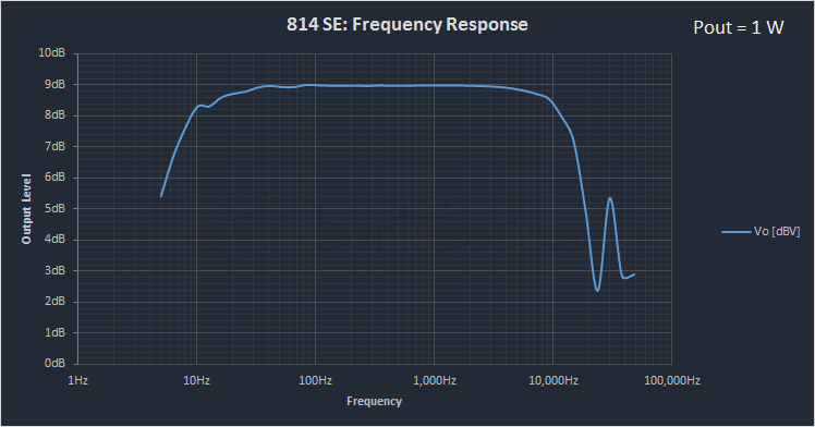

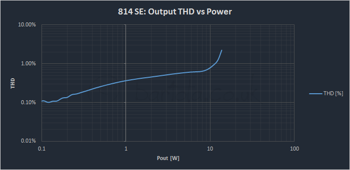

After some time I finally run some proper measurements on my 814-SE amplifier. I nearly blown it away (twice) by trying to do excessive power sweeps and also did some speaker measurements. Thanks to the crowbar protection, all remained ok. A real challenge for a DC-coupled amplifier.
The case was proven that the 814 in triode mode is an outstanding valve. Here is the THD of the amp:

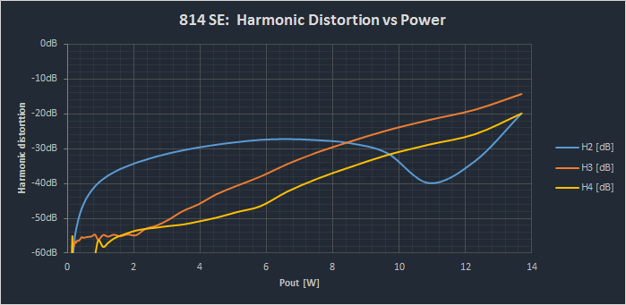

It operates mostly in class A2 (above 3W) and harmonic profile is quite nice for this type of amp:
The response of the 46 driver is fantastic (i.e. up to 48kHz) however the output stage is slightly disappointing as -3dB is around 17kHz. I assume that the OT capacitance is bigger than expected as a byproduct of a reasonable primary inductance to achieve good LF response for an iron gapped at 100mA. Not easy to achieve in an amp. The sound is fantastic anyway and I don't perceive any loss in HF - at least on my ears

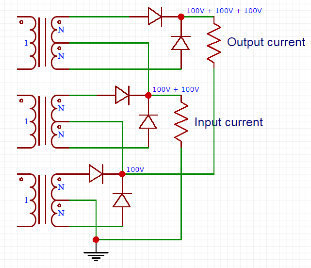

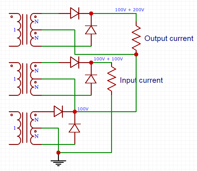

I have a question about the stacked supplies for this kind of design. Is it possible to arrange the current loops as shown below? Assume there's filtering/regulation where needed, of course (simplified so I can wrap my head around this).
Or would it be preferred to stack the supply for the output stage with the current return directly to its own winding?
I would be going after much lower voltages here and am thinking that several identical windings/voltages would be a little simpler (and more scalable) if they can be stacked like the first example.

It looks to me like your V5 is also providing part of the anode current for the driver tube, in conjunction with the PS stacked below it. In any case, the MOSFETs have high PSRR so the supply may be able to be a little rougher than usual. I'll probably regulate both supplies anyway.
