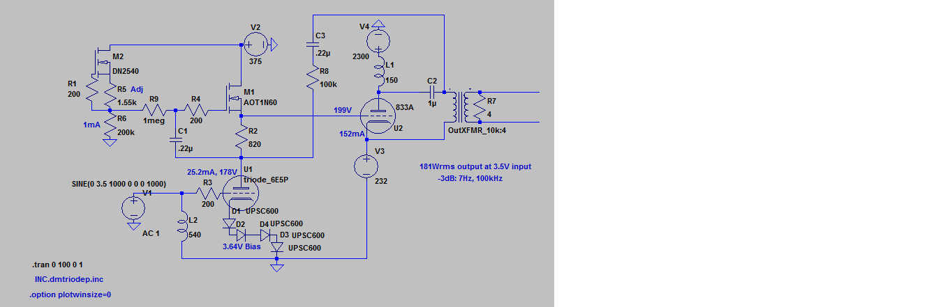

Here's a slightly different version of the 833 schematic, using a gentle 3dB of local feedback to lower the output impedance and increase the damping factor a bit.
Full power is now 181W at 3.5V input...it will make my preamp feel more needed...
I think this is the one I'll build. Probably.
Actually, it turns out that the above schematic sims very well with the feedback removed and everything else the same, so I'll just make it switchable. Best of both worlds...

Turns out I can eliminate C3 from the above schematic without any harm...one less capacitor!
After some further optimization I've obtained the following output figures from the sim:
200Wrms at 2.5V input with 0dB feedback
192Wrms at 3.3V input with 3dB feedback
156Wrms at 4V input with 6dB feedback
Anything past that and the 6E5P runs out of steam.
My 26 preamp can easily supply the 4V needed, so that's not an issue. So it looks like I'll make it with switchable feedback and experiment to find which is best. Now just waiting for the iron...

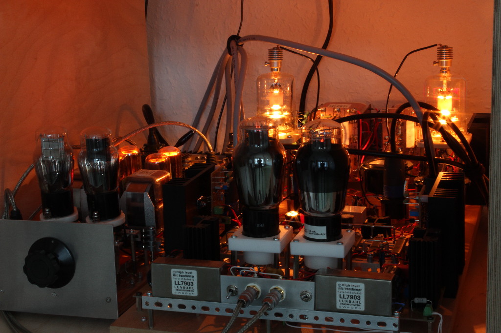

4-65a SE Amp finished!
Glad to have reached the end of this long project. A fantastic amp built experience and so far I'm amazed with the performance of this amp. I've only listened to it no more than 2-3 hours. Need further burn-in, but I'm very happy with it!
My initial goal was an all DHT class A2 SE amp based on Michael's design. I ended up with a crazy idea of a 46 driver in filament bias. You realised it's crazy when you see the size of the power supplies. The investment paid off. The driver can do 200Vpp @ 0.09% running at about 35mA which provides a great driving capability to the 4-65a thanks to the mu-follower gyrator load.
What surprised me so far are the bass and dynamics of this amp. Clearly I wasn't used to having 10W of single-ended power, but know I can get more than the 2W of my 45 SE to play that music that needed a tad more power. I'm not playing it loud at all. So far I did a quick run through jazz (e.g. Coltrane, Mingus, Davis), classical and rock music to test some favourite songs to listen to subtle characteristics of the amp. I will probably make some further comments in the future but overall can say it has a deep bass, fantastic dynamics and sweet tone.
A remarkable note is the quietness of this amp. Can get no hum whatsoever on the FE167E speakers. See my THD measure below. All filaments are DC using Rod Coleman regulators (highly recommended) and not easy to achieve this with the 6V/3.5A heaters 🙂
here are some pictures if you are interested:

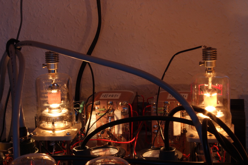

And the 4-65A running cherry red to keep the getter healthy:

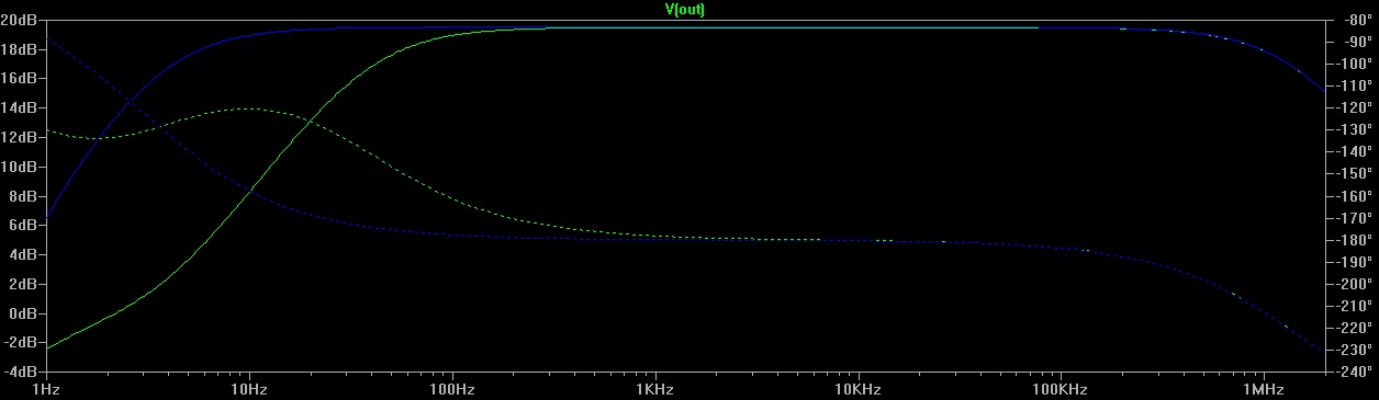

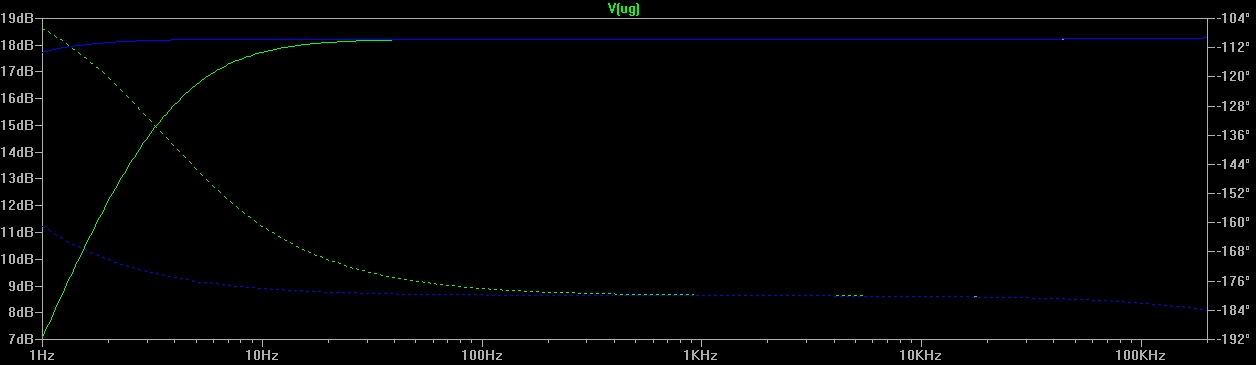

Just one question: why such a large cap in the gyrator/mu follower? You have a corner frequency of 0.03Hz when combined with the 4.7M +220K resistors. You could easily drop that to 0.22uF or even lower. Smaller caps usually sound better provided they achieve the required corner frequency, IMO, and they are cheaper, too!
I'm adapting a variant of this scheme to my 833C 'Midlife Crisis" Amp. My custom OPTs and HV chokes just arrived at the airport in a 92kG crate according to the tracking data (yay!).
Euro,
What's the R associated with the C? It must be much lower than 4.7M to give that response. The C value in isolation really doesn't tell the whole story.
Interesting. I didn't see that in my amp sims, I'll have to check them when I get home later. I wonder if the value of the R under the cascode plays a role; mine is 820R, with the 6e5p input tube beneath it, like in Ale's schema.
