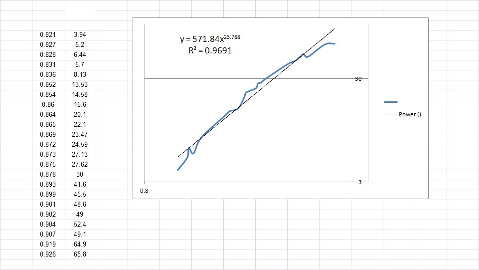

THX for that, I finally got back on this last night. I've rearranged the data so that the Vf is continuously ascending.
That way a reasonably continuous curve results. It fits square law well. So that would add some distortion while in
the cathode of triode or pentode. Has anyone tried D% measured results while comparing to a bypassed
cathode resistor? With diode biasing the operating point will drift as the tube ages.
