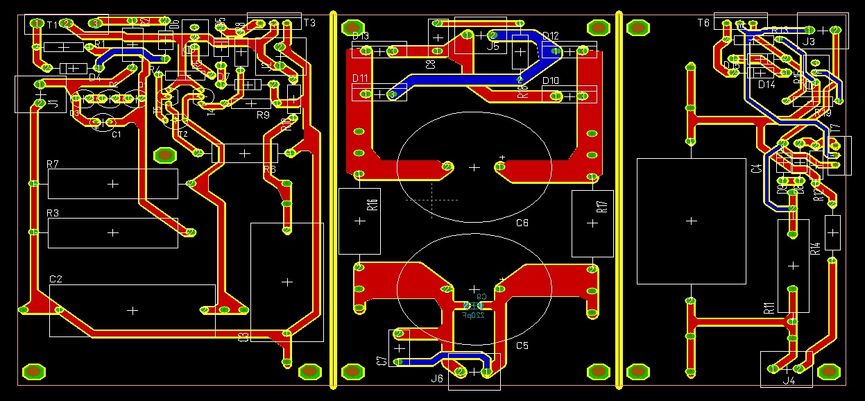

Here's an image of the boards. Left to right it is the SalasHV reg, then filament supply, and last the mu-follower. It's only the second board I have drawn, so I am sure there is room for improvement.

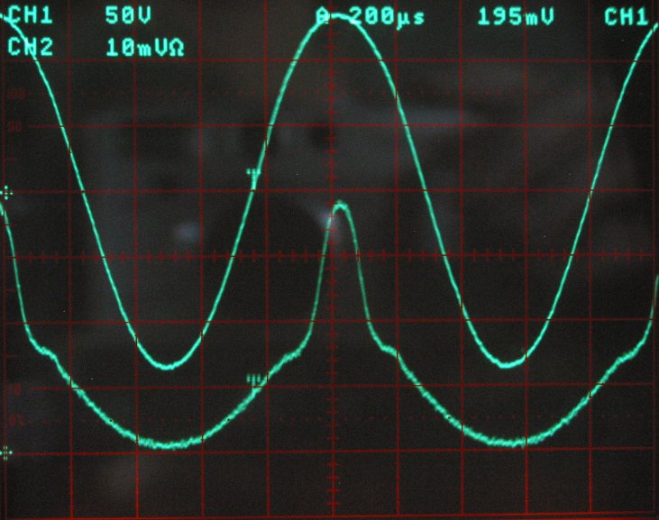

Hi Frank,
Better late than never?
Here's a trace of the g2 current from the Meteor amp. Top trace is the G1 voltage from the driver at 270V pk-pk and bottom trace is the g2 current at 10 mV/division. At zero signal, the g2 current is about 9 ma (at ~700V). This would result in about 6 watts g2 dissipation, well under the 10W data sheet maximum.

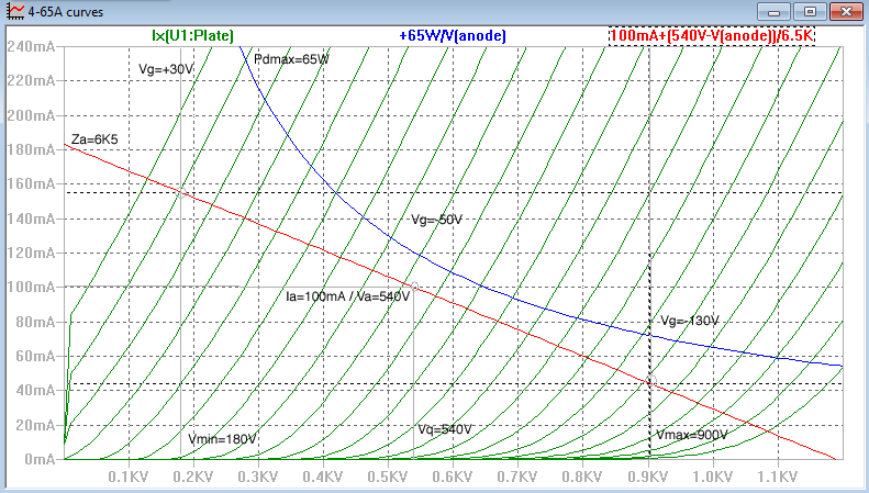

I used the curves from Dave you posted earlier and managed to create a SPICE model using Dmitri's tool. See model below. I think is nearly there...
http://www.bartola.co.uk/valves/Valves_and_Hi-Fi_audio/Entries/2012/4/22_4-65a_Triode_curves_files/shapeimage_2.png
What is the operating point you ended up using?

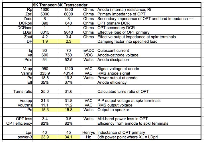

With an 8K OPT, I used 750V and 70mA. That was just enough to get the orange color you see on my anode
Thanks Michael! that's a lot of good insight.With an 8K OPT, I used 750V and 70mA. That was just enough to get the orange color you see on my anode
I'm waiting for the arrival of a pair of nice LL9202 gapped at 100mA. I'm not really looking at maximising every single watt here, so am a happy bunny with 10-12W. My power output valve supply will be limited to around 600V, so looking at LL9202 with Rp=600 ohms max (need to check primary winding combination based on target Np:Ns wanted) should be around Va=540V @100mA.
The LL9202 can do either Zaa=6.5K or 11K for this purpose, what would be your recommendation based on your tests?
