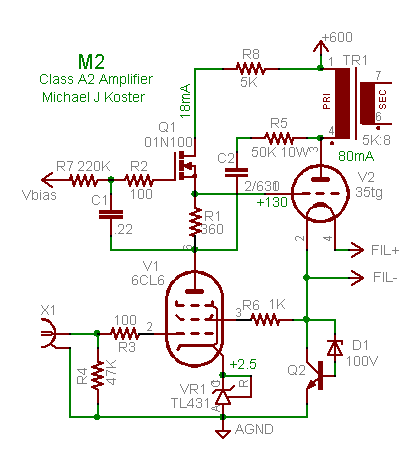

Yes of course we know mu can be used here and it has been tried. FET source followers actually sound better!
I am still going to try a JFET current-biased in an input tube's cathode. Hadn't thought of the TL431 though! Sometimes cathode bias with a resistor sounds nice, sometimes it doesn't. It's just another flavor.

Hey why don't you say how you really feel ;-)
Put in a pentode based op-amp just to avoid a SS part? Would a pentode really perform better? The MOSFET performs quite well in circuit. There's a nice gm-multiplier trick using a TL431 also.
Sure the TL431 is lower impedance, and I will use them where they're really needed. BTW, the dynamic impedance of a 431 is usually less than an ohm. A few ohms of an LED or diode-connected FET is no big deal and it's one component simple.
There's a reason for the regulated cathode. Can you study the circuit and figure out what it is?
Cheers, and thanks for the comments
Michael

It looks like the 811A and the 35t can be used at the same Vpk and Iq for 5K load impedance. The 811 will not use as much grid drive voltage (maybe 60Vp-p vs 100Vp-p for the 35t) but in this plate-grid feedback circuit that won't make any significant difference in the circuit operation. The feedback resistor could be made a little smaller but would work fine as is. The Rfb mainly sets the amp's input sensitivity and driver load line.
Conclusion: the 811 is practically a drop-in with only g1 bias needing a few volts tweaking.
There is no negative supply but it currently uses stacked supplies to keep the grid current loop separate from the cathode. I would like to try with a single supply using a shunt regulator in the cathode ( see attached) as per the "no light district" thread but that will take some experimentation to see how low impedance the cathode shunt needs to be. Grid current in this should not be too spiky since it's in A2 bias.
C1*R7 time constant should be shorter that C2*R5 for good gain stability.
Michael

Hey Tim, here's a TL431 cathode regulator for my driver.
Not op-amp (not differential, and the gain is far from infinite). You've got the pentode in there anyway, so why not excorcise all SSin from your amp? 😀
Nope, nothing the circuit won't do without a resistor (or for that matter, a CCS, to use an extreme example). Bypassed, of course, otherwise AC gain (particularly HF) suffers.
Only thing that cathode controls is its current, which can be anything. Top side voltage reference keeps the operating point stable, which is very handy. (Stable as the dFET anyway, which isn't great...check Vgs(th) vs. temp.)
I think we like tube handling voltage amplification and the FET follower doing its thing.
Tim
I think Michael would like you to see the cathode CCS device tracking the constant plate current instead of the other way around?

It is to provide a clean stable reference but I see there is some ambiguity about the current loops. And in practice the change is about 0.25V as the dFET warms up. The 2N7000 is < 0.1V the way I use it.
I guess we have to be careful which variant we're talking about but it is the reference for the bias, and RC bias won't work if grid current returns through the cathode resistor. However...
In the actual breadboard I used stacked supplies as in post #1 where the driver idle current + grid current are supplied by the grid supply but only the driver idle current is supplied by the "cathode" supply. The B+ supply is returned to the common cathode point as well. So counting the filament it's four power supplies all common at the cathode. This is the power supply layout for the circuit in post 19 also.
Given this, it's good to have the cathode supply be clean and regulated because it's the reference between input ground and the output tube cathode.
However one could float the bias reference on the cathode instead, letting the pentode Rp decouple the input from the power tube and reduce the regulation requirement on the cathode supply. So maybe it can be simplified after all, but with the stacked supplies there's no idle cathode current in the cathode supply. I need to think about this.
Thanks!
Michael
PS In the post 32 variant with the cathode regulator, both cathode and grid current would return through the regulator.

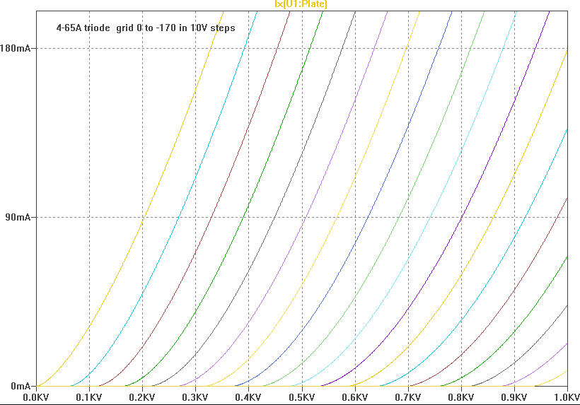

Sorry if this has already been asked, but are there triode curves for the 4-65 that I can use?
Thanks,
-Michael Woods

I got this from Dave Slagle
Michael
Michael
Nice! That looks pretty linear to me!
Thanks a bunch.
-MW
