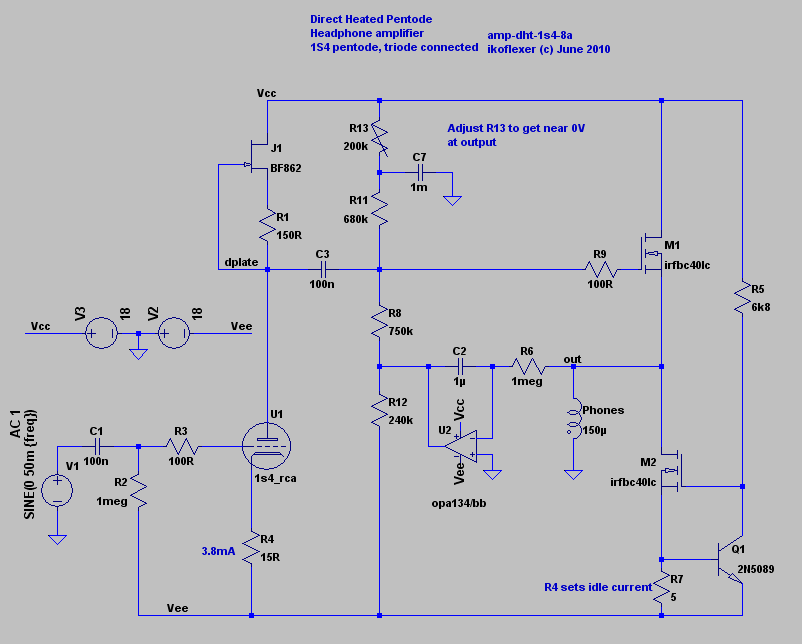

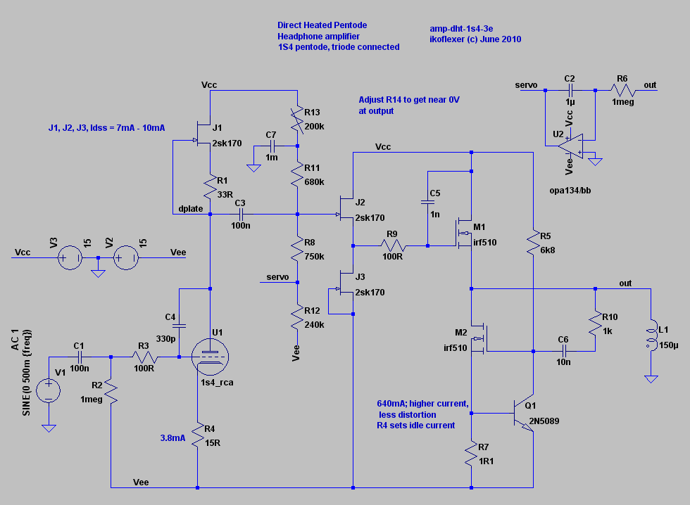

So I fixed a few things.
a) moved the servo connection to a different point and redid the jfet stage bias
b) changed servo capacitor from 10uF to 1uF
c) removed the jfet source resistor from J3 because it introduced a lot of distortion
There are no oscillations now when the servo loop is in. The output DC offset stays at below 20mV. Note that it takes approximately 20 seconds for the output DC offset to get below 20mV, which can damage the headphones. Ideally the headphones should be connected after about 20 seconds. I might implement a simple relay based delay to keep the output disconnected for a short time upon power-up.
Edit: connected a 47R resistor at the output and then ran a 1kHz sine wave in, so that the output would be at normal listening levels. Then measured the harmonic distortion at the output using the HP 3585A spectrum analyzer. The fundamental measured at 111mV, the second harmonic at 160uV, and the third harmonic at 20uV. We can normalize these numbers by dividing the second and third harmonic values by the fundamental to get 144e-05 and 180e-06. Compare this to the normalized distortion numbers of post 77 which are 3.78e-05 and 1.33e-06. How's that for difference between simulation and reality?
Edit2: the servo opamp seems to pass about 10mA to Vee, and it gets warm, almost host. Sticking a tiny heatsink on it brought the output DC offset below 10mV and the opamp is definitely happier.

And an update. Wavebourne asked me: "why do you need that jfet source-follower?" And though it seemed like I couldn't get the circuit working with low distortion before without the jfet source-follower, I tried again. And not only it works, but it works better. Even got rid of all compensation capacitors, and it's stable and it rocks. This version is also easier to build.
As active load I've tried the simple CCS with a BF862 and also with a 2SK170. I'll probably stay with the BF862 because of its lower capacitance. I've also tried a simple gyrator made with an MPSA81.
