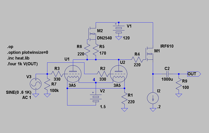

ikoflexer said:sheldon, interesting output stages over at tubecad. Ok, I've simplified the abomination somewhat. Have a look.
You will see the simple ccs load on the 3a5. I use double the jfets (if different Idss the source resistor needs to be adjusted offline until the voltage drop across the two jfets is roughly equal; the reason for this is that the 2sk170 has a 40V Vds max; I know it's a hack, but will look for more suitable jfet, with higher voltage).
Funny, that simple ccs has this output impedance. Over 100kOhm at 1Mhz. Of course, in the real world it's not like that 🙂
So, the simpler circuit simulates a bit better for distortion. Nice figures for the voltage on the 3a5 plate (V(dplate)).
I like the resistor load better. It's actually lower on 5th and higher order distortion - which is more dissonant than the low order distortion - assuming it models realistically. I'd still try a resistor load first and see if you like it. I agree with Doug, that the output stage is unnecessarily complicated, and that the coupling cap is not a big issue. I disagree that the output cap (even electrolytic) will necessarily sound bad. Try it, you may like it. Even if you don't want an electrolytic there, you can probably find a 100uf motor run cap or other film cap from a surplus source.

Sheldon, the resistor load has higher number in all 9 harmonics. See below.
As for the output stage, unless I can get a simpler version that works just as well, then the more complicated version is not unnecessary. It is a learning project for me, so I'm exploring various topologies and I know some of you disagree with simulation, but it's a great learning tool for me. The spud amp I built behaved almost exactly as I had simulated it before. It was nice to see simulation and reality be very close, and it allowed me to explore very much.
dsavitsk, I am more concerned about the large output cap, that's for sure. But until I switch to OT I'll just have to live with it. Perhaps it's just a dream, but I was thinking of direct coupling two tube stages with that p-channel mosfet schema I showed above (in the future).
About the DN2540 ccs of Gary Pimm. Something doesn't compute, perhaps I made a mistake. To satisfy my own curiosity I'll try to get some of these devices and measure their impedance myself. FWIW the models I used in simulation are from supertex.

I guess I was reading the distortion data incorrectly. I believe that tube will sound good with a resistor load. Also with a current source. Your amp. Your call.
When you say "works just as well". You mean in simulation. I've nothing against simulations at all. But just because something simulates with lower distortion, doesn't mean it will sound better to you. If the goal is to produce an amp that has the lowest possible distortion, then by all means follow the simulations. But if that's the goal, why bother with tubes at all? Heck, a 3A5 doesn't even have a visible glow to warm the psyche. You can always get a more complex solid state circuit to simulate better in that regard than a tube circuit. I'm not sure I see the point in using a tube, then very tightly regulating it's environment, to the point that you could substitute a solid state device in its place without changing the sonics.

Even if the distortion-sims does not tell us how things will sound I am curious how you did them. The reason I ask is as when I use the dmitrynizh-model my sims differ very much from yours.
Did you use the S-command ".options plotwinsize=0" and did you sim over a longer time like 5m to 100m (1u) for 1kHz?
To make it easier to grip/show a Blackman-FFT could also be good to use.
As the cathode is common for both halves of the 3A5 I believe, as mentioned before, it would be better to parallell them, like in a 2A3. See my sketch below. Instead of dry-cell a CCS could of course be used.

The DN2540 current source the way you use it has about 500ohm Zout across the bandwidth.
Fortunately you are wrong about the above 😉 ! A single DN2540 this way will be in the ballpark of 1Mohm(ref Gary Pimm). So it will work good enough. Though I would prefer a higher B+ together with a resistor load.
Anyway 4ma/half could be a good start.
Yes, I'm glad to be wrong about it as implemented in reality. I meant in simulation. So it wouldn't be much of a good load in your simulations, that's all I'm saying 🙂 That ugly variation from my previous post simulates as well as Gary's real tests, that's why I'm using it, as something closer to reality.
BTW, I got a jump in distortion at 3.7mA (as the data sheet recommends). Those harmonic results above are at about 2.95mA, and -2.5V on the filament/cathode.

Here we go; left everything the same in the circuit except for the 3a5 model derived from the plate curves on Dmitri's site.
The simulated thd on the plate is 0.023% as opposed to 0.009. The big difference seems to come from the second harmonic. I suppose one can expect even more differences between real life and simulations, but hey, we're in the ballpark.

If you can get anywhere close to those values and profile (even the resistor load values), then I'd think that harmonic distortion is not an issue.
Sheldon
It seems to be a good simmed load that follow Pimms measurements.
About resistive loading vs CCS I did the sketch mainly to show the idea with parallelled 3A5 and simplified SF. The good thing about CCS though, is that you will get a good PSRR.
Nice to hear you did a new Spicemodel based on Hubers curves. Do you mind sharing?
