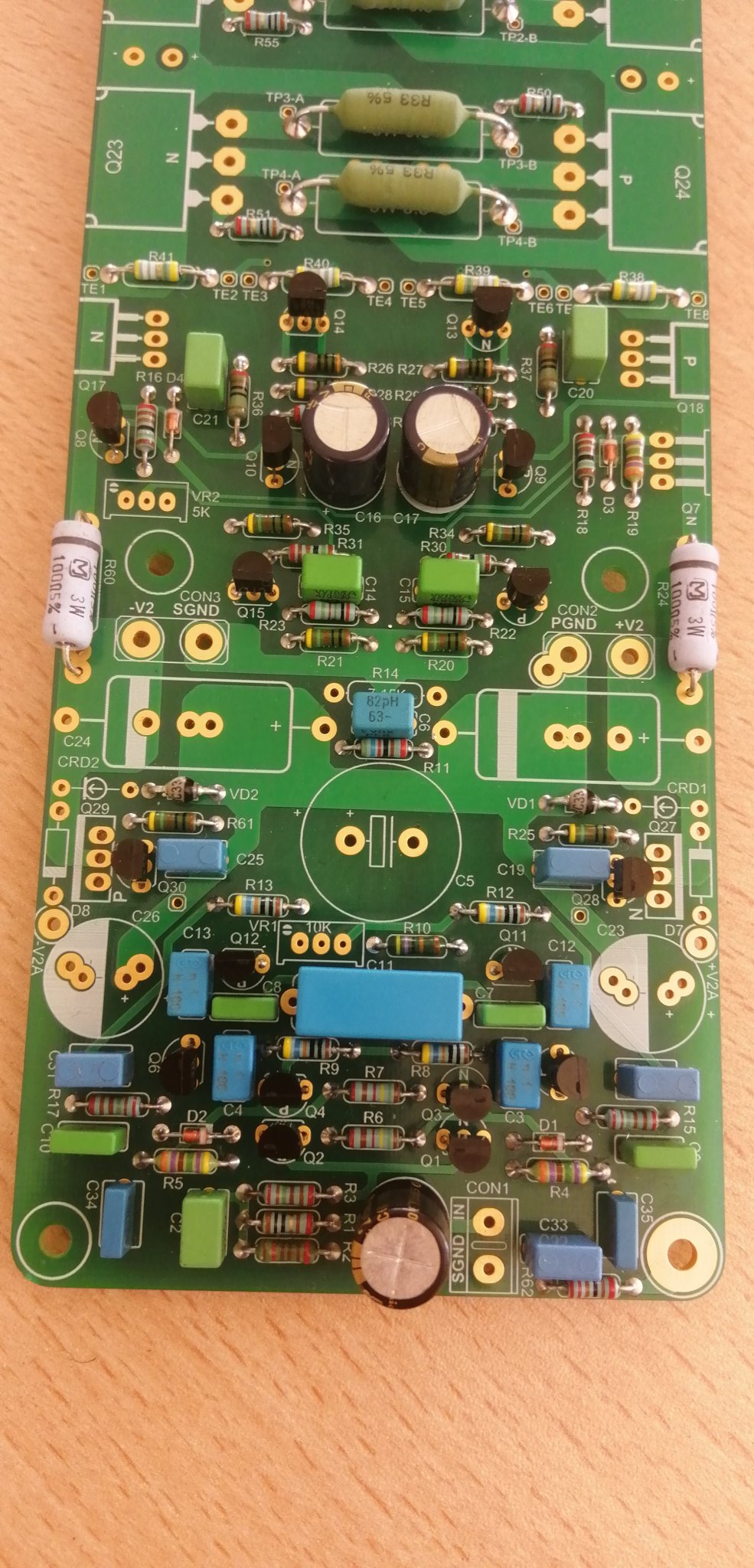

Class A board DOA33. PSU Help!

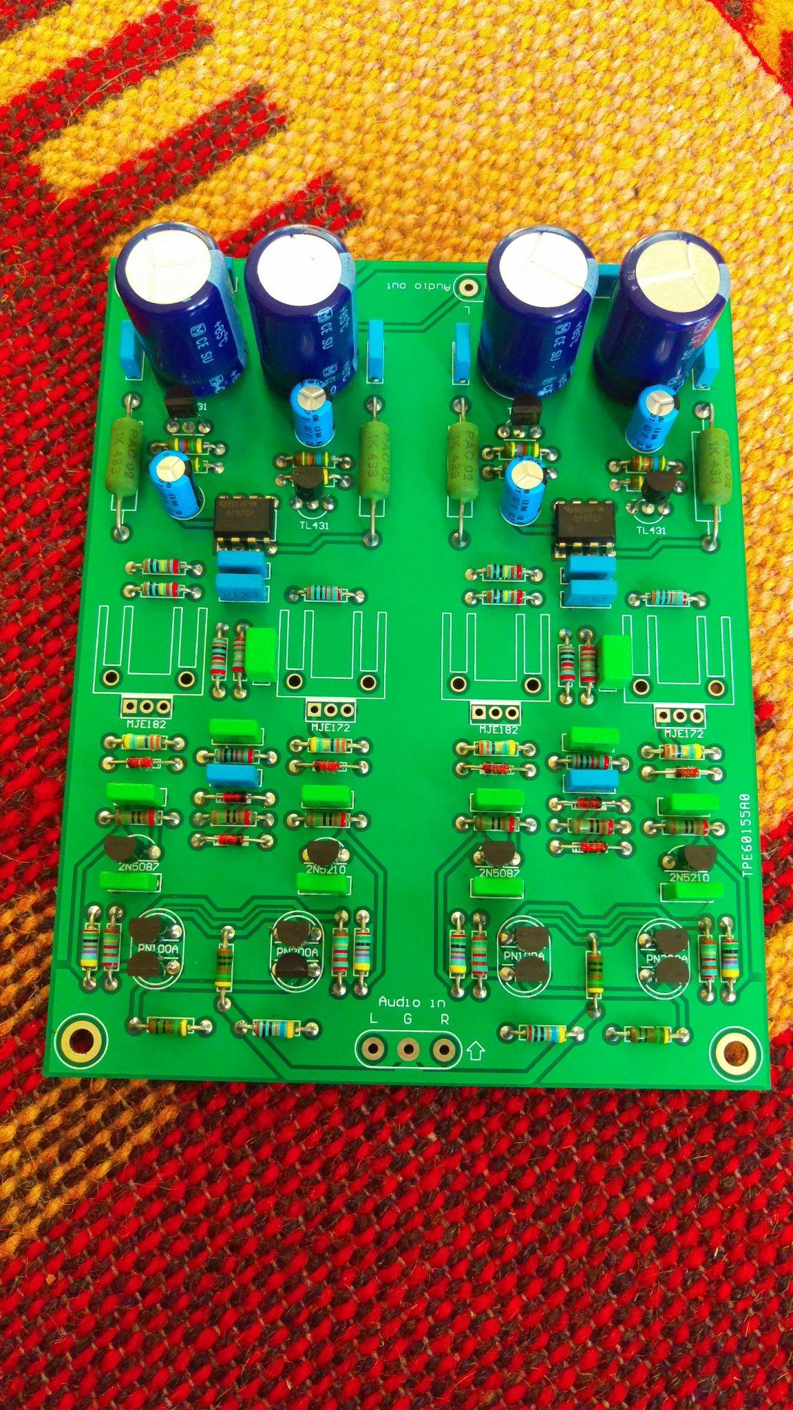

Your DOA33 does run within 25 V - 35 V very well.
To increase the supply voltages significantly, you would have to replace BC413 and BC415.
3 x 150 Ohm-resistors set the current. You could the middle one replace by trimmer (500 Ohm), as example.
I would remove the last two diodes 1N914 (feedback), it will sound much cleaner.
To get more "smack" (sound) connect emitter-base MJE182 and emitter-base MJE172 - per resistor or wire. Better solution than the two 1N914.
You could replace both R33 (emitter-resistors) per other values to modify the sound: the higher the more naturalistic. The lower the duller, more brittle, tighter.
Attention: this one is a push-pull-design, 3 (1/2) steps: this one is not to use to listen music;-)-;

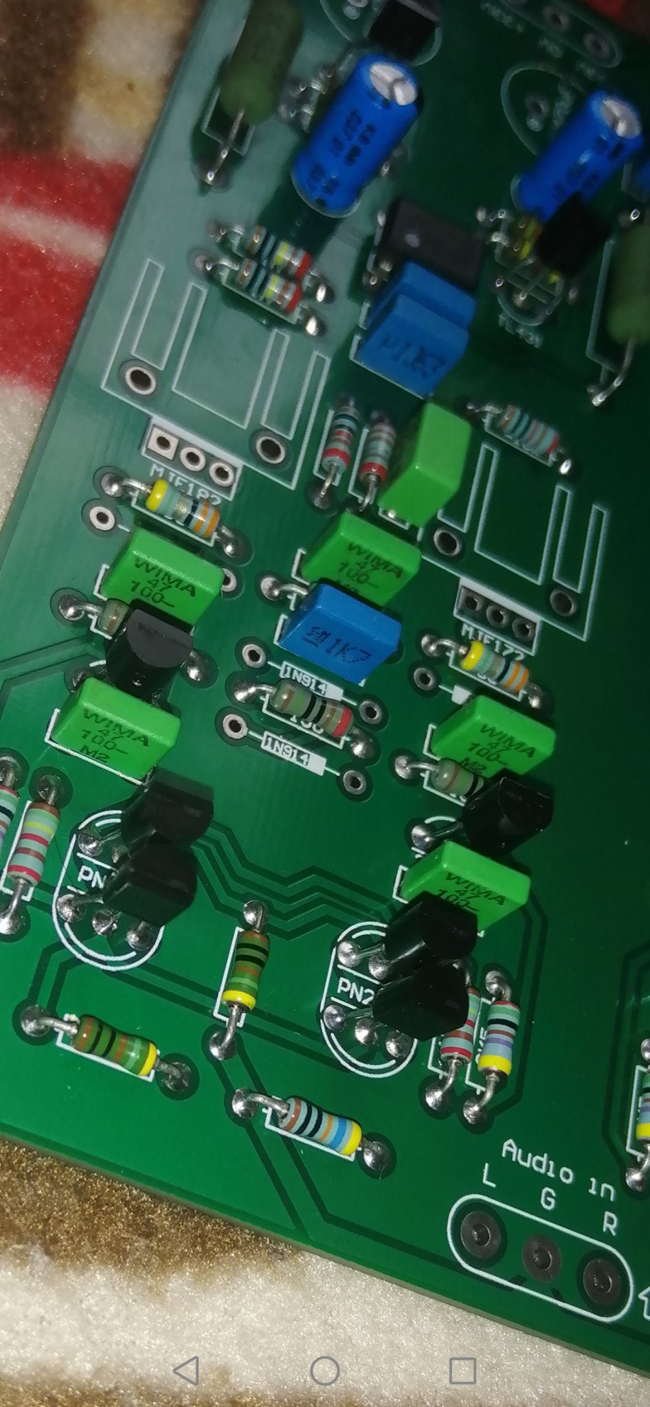

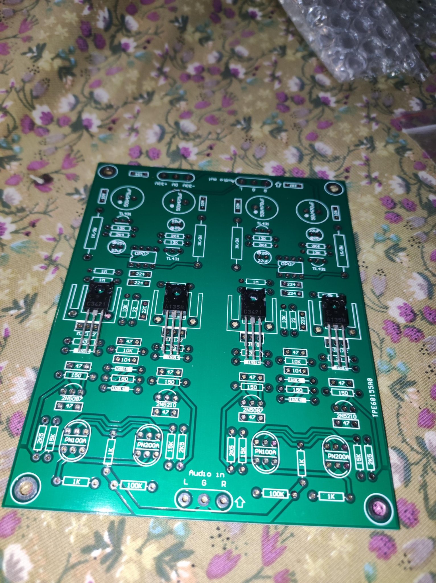

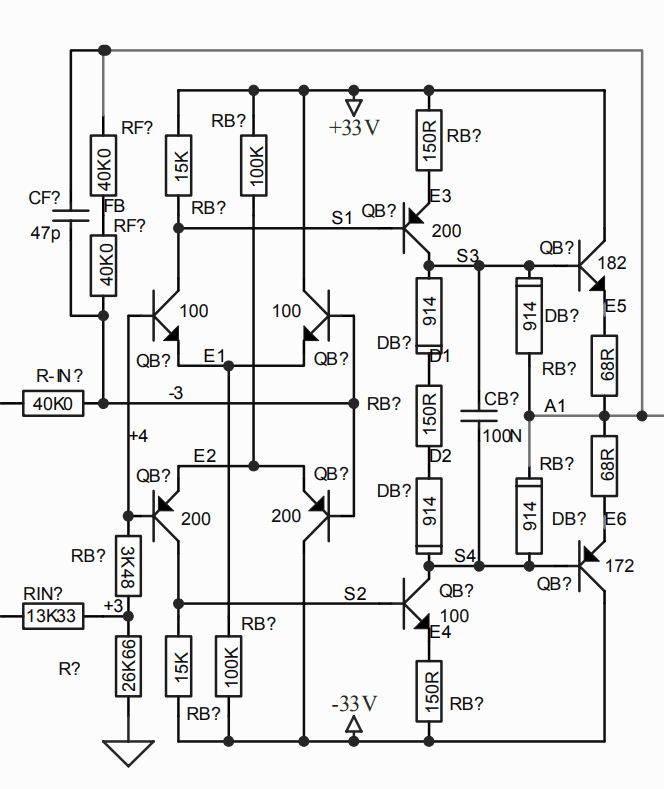

i have this doa33 circuit
doa33_skjema_mg-jpg.1102539

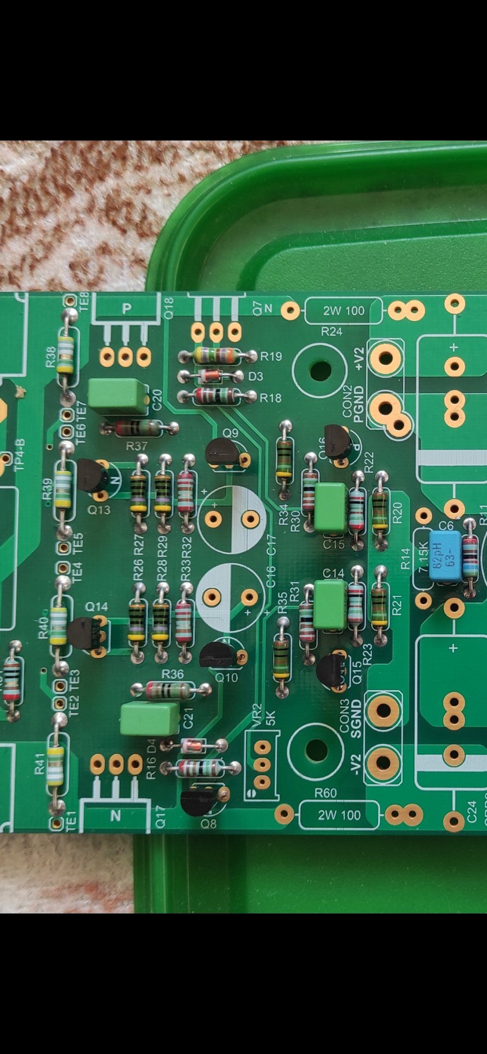

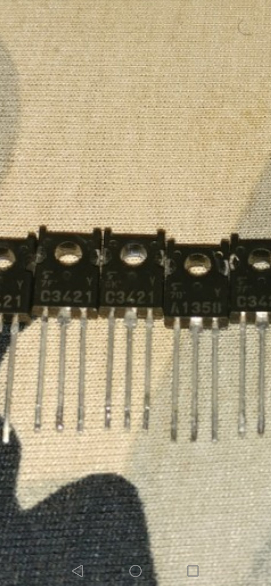

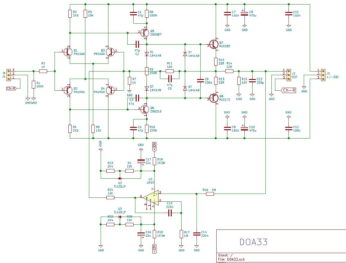

I will use 2sc3421 2sa1358 instead of mje172/78View attachment 1102577View attachment 1102578
May be, 2sc3421 and 2sa1358 are wonderful choice. May be not very liveful, not very large, a bit artificial over clear colors, like dollhouse, very disciplined.
I would replace Q5 and Q6 with the same types as Q7 and Q8. To get less differences of "character" of parts in both halfwaves, in both strands of amps - to get more harmonic and cleanness in sound. (Or Q6 the same as Q1 and Q3, Q5 the same as Q2 and Q4)
MJE172/182 I did not hear yet.
I would remove C7, C8, C11, C12. Without replacement.
Reactions: Sensation45
What did you replace Q5 and Q6 with Q7 and Q8?
Two half-waves but including two times the same character of two different parts, not 4 characters of 4 different parts: more harmony, cleanness, less noise, differences.
The same "character" of sound. Result of "streaming", "floating" - "current" does not describe the process. We have to understand "current": through materials, forms, modulated by resonances of materials...: same parts - nearly the same characters. different parts - very very different characters.
The ear does detect not "waves" only or amplitudes;-) The ear does detect differences at first. The ear does detect very very complex differences: signals. A measure per looking (oscilloscope) does not represent the audible character of parts and circuits and more. Not a bit. Zero!
