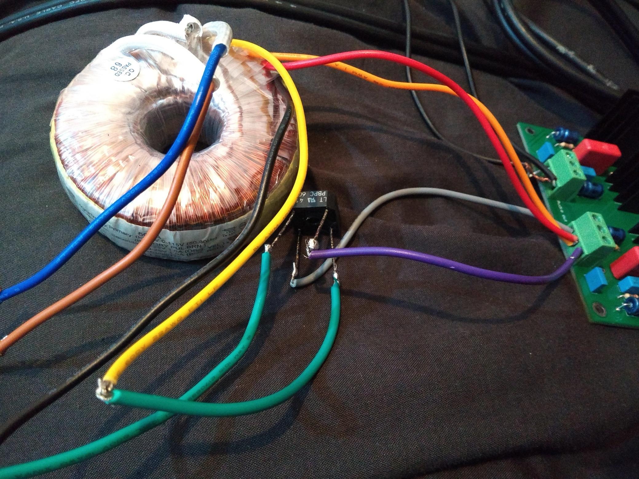

Nope had to shut it down quick making a crazy buzzing / humming sound.
Might have to call it a day. These late nights can make you do crazy things lol

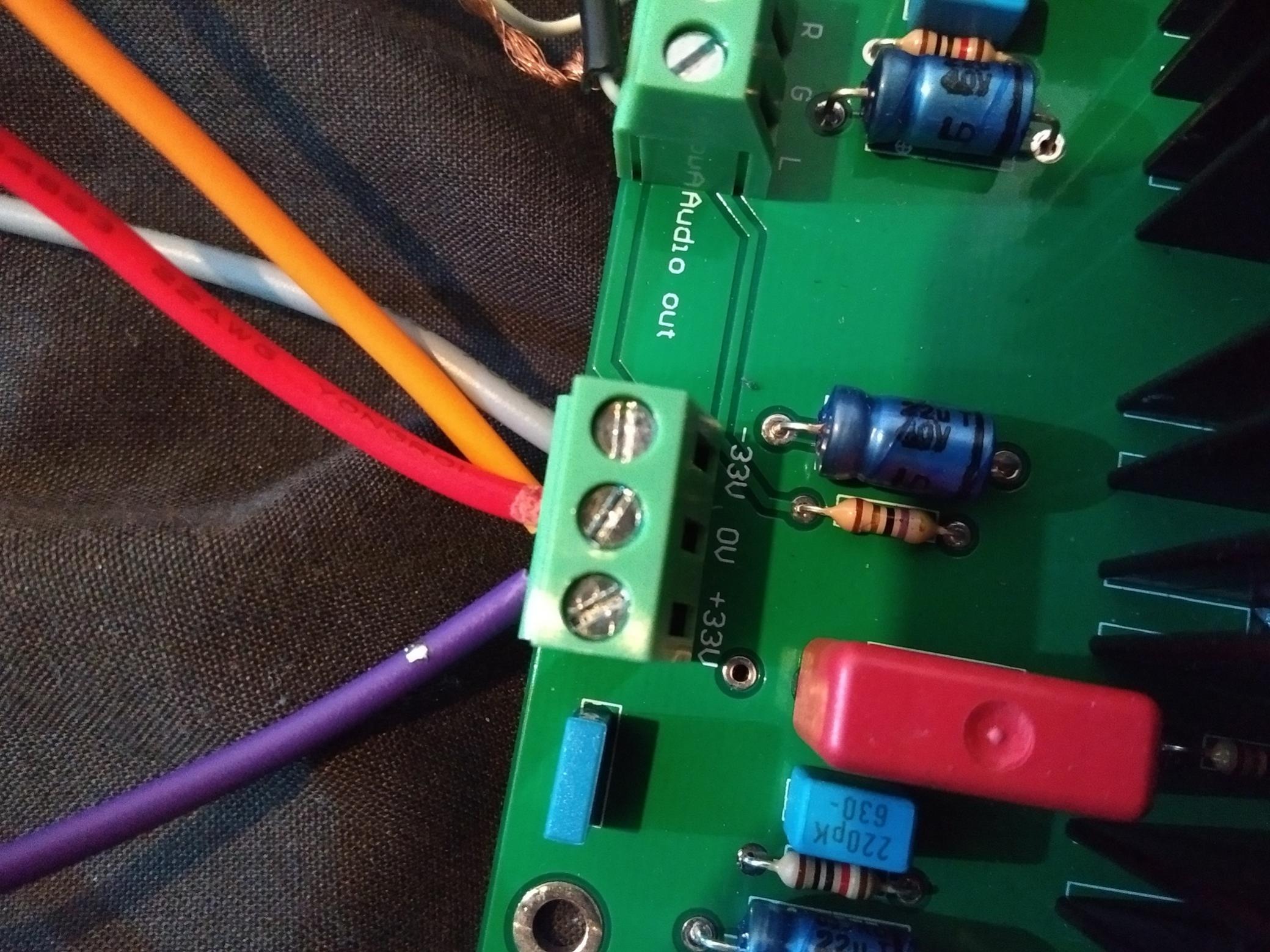

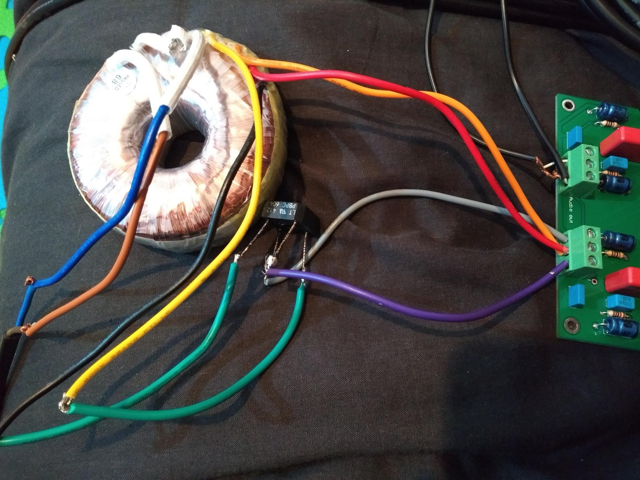

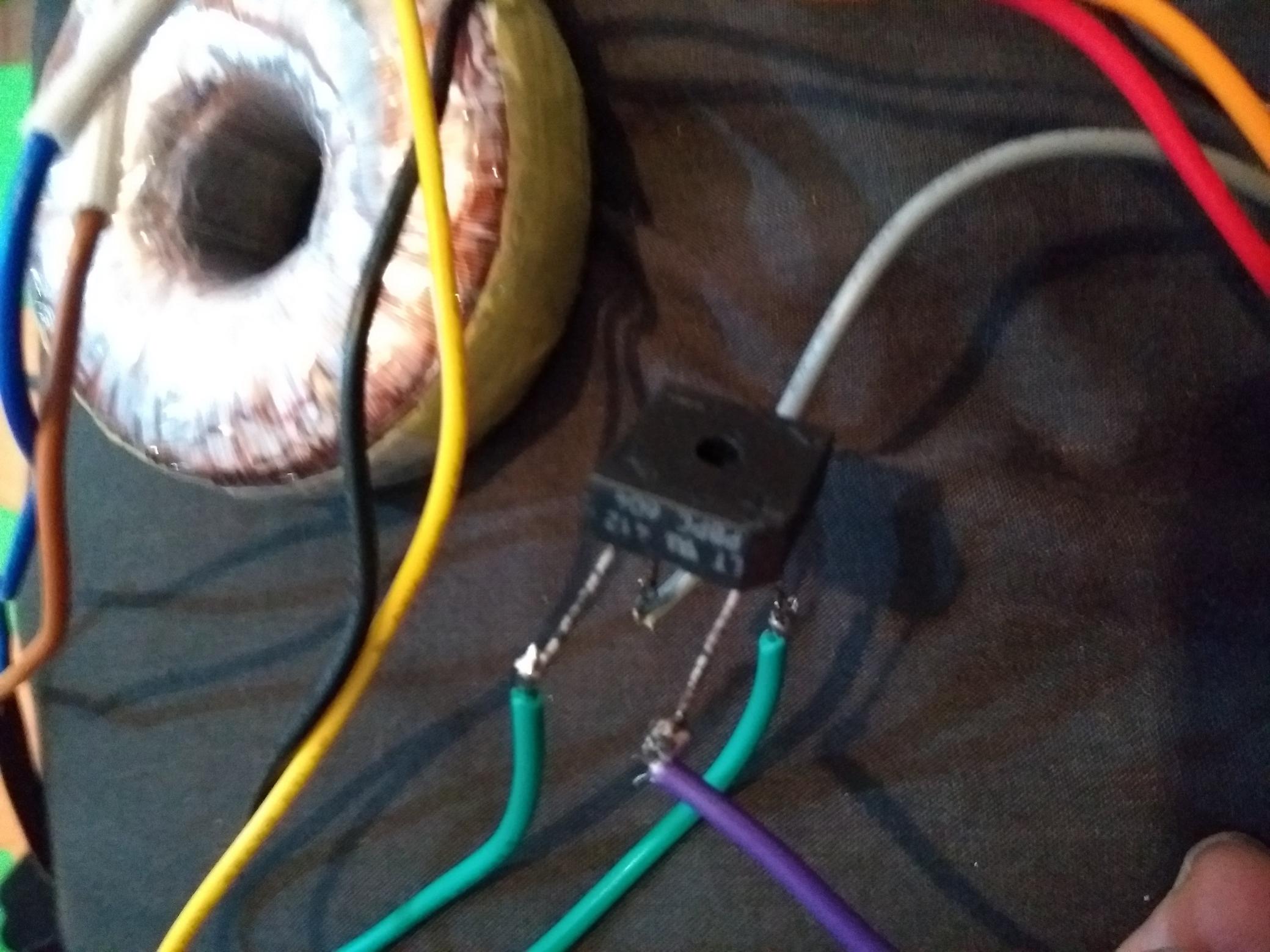

When I put the meter on the - and + of the bridge rectifier I get 56V
Just the bare transformer I get 62V or 2 x 31v. The transformer is only suppose to be 25V.
The transformer is 25V-0V-25V or 50V CT.
UN-loaded, 31V instead of 25V is 24V regulation which is a little poor.
31V AC, withOUT large filter caps, will be a PULSATING wave with "DC" of ideally 0.9 the AC Volts, 28V, which agrees with your 56V both sides.
With large caps it will be 1.414*VAC or, no-load, 44V each side, far past the 35V rating and potentially damaging.
Can you trade for a 20V-0V-20V transformer?
You need to learn how to construct a DC power supply using a transformer. Best thing to do is read some good articles on it, such as these:
Linear Power Supply Design
Power Supply Wiring Guidelines
Short notes:
* AC voltage != DC voltage. DC voltage is AC voltage * 1.414.
* You need capacitors after your rectifier, or your DC voltage will be full of 100Hz buzz which will be useless for an amplifier.
* Amplifiers generally require a symmetrical supply. You have a 0v "centre tap" and then +V and -V around this tap.
* Make sure you have your transformer primary wired correctly for your country. If you have a transformer with 2x115V windings, you need to connect them in series for a 230V country such as the UK.
* Be careful. Power supplies are not forgiving. Get the connections wrong and you can expect smoke. Verify everything thoroughly before you switch on. Consider making a "dim bulb tester".
You could also buy a variable power supply that uses LM317 and LM377 with your current transformer which will have input caps (small ones) already on the board. Just adjust down to +/-28 VDC on the output and you are ready to go. Should be less than a new transformer.

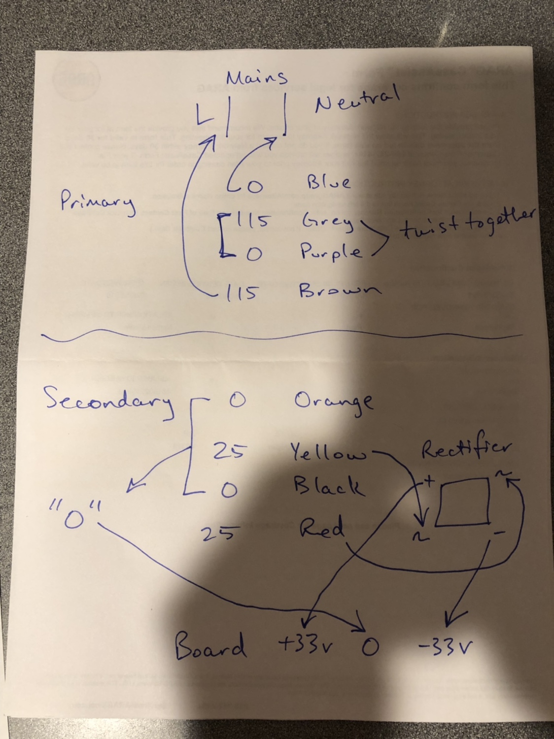

Just the bare transformer I get 62V or 2 x 31v. The transformer is only suppose to be 25V. But I have read it can go down when load is attached.
Your transformer has dual secondaries with a center tap. The center tap should be grounded, then you have 2 x 25 (or 33) on each side. That should go into a full wave rectifier, feeding some serious capacitance as noted. Google full wave rectifier with center-tapped secondary.
If, like you have done, you rectify the entire secondary you end up with double the intended voltage.

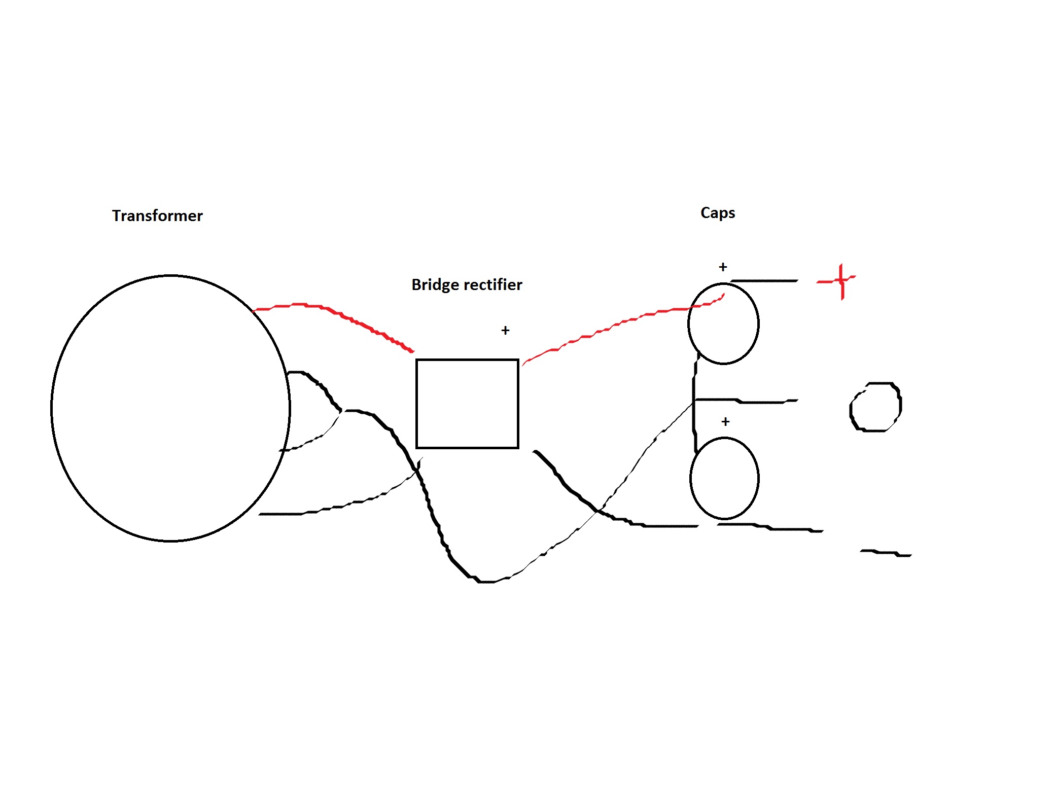

Jaycee pointed out earlier that my voltage is too high! I need to order 20v to get 28V.
My 25V AC will produce 35V DC which is too high. I have made a sketch for myself based on what he sent in last few posts.
I plan to use 2x 2200uf Capacitors.
