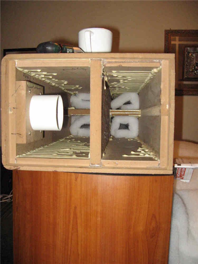

Byrd said:A variety of port lengths cut
You have a plethora of ports.....looking to corner the market?
A few more pairs of PlanetMoose Thor's and we can,
"TAKE OVER THE WORLD"!!!!!!!!!!!!!!!!!!

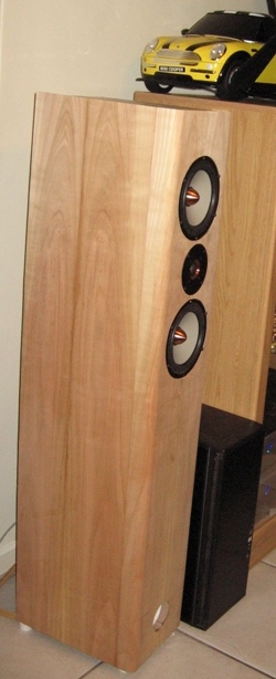

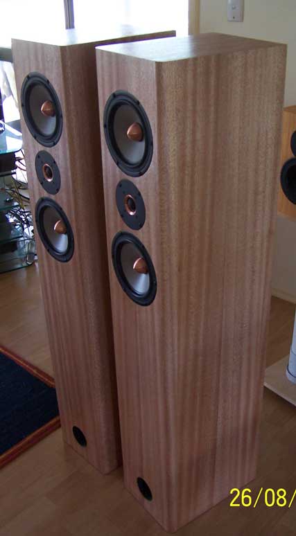

John – wooow that sounds a lot of work and heartache; I’ve never really liked iron on veneer and never had success with it the few times I’ve tried. “Real” veneer seems very tricky also to me and especially when covering large projects. A while ago I found (like a lot of others) paper backed veneer – Valhalla – huge 2.44 x 1.22 m (I’m in Australia) sheets; lovely and flat bonded to a strong paper backing.
A lot of people use normal yellow wood glue but I’ve gone the recommended but more scary contact adhesive route. Small panels are fine with care but I did a side-front-side one-piece wrap on my Small Thors. There was no way I could do this on my own. So a mate helped, we did a number of “dry-runs” to make sure we new exactly what to do and how to locate the large sheet and avoid it “grabbing” before we were ready. Success – not one bubble – see http://www.greenie512.net/greenie512/html/finished_thors.html
