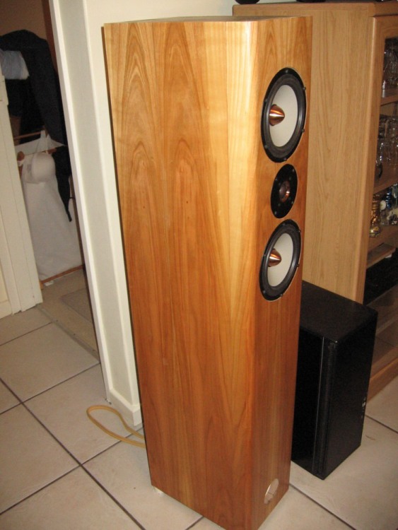

Still not finished. Busy with polishing and a few other bits of finishing. Attached is where I am at at the moment. A bit busy with work @ the moment, so only going to be able to finish them in a few weeks.
Hope you'all have great weekends.

Byrd said:Hey guys.
Thanks for the interest.
I used the cutting methid shown in the picture in
this post. Essentialy done on a router table with a stop against which the other side of the tube can run.
They look stunning, Byrd!
Are you happy with the sound as-is?
Are you running the original XO?

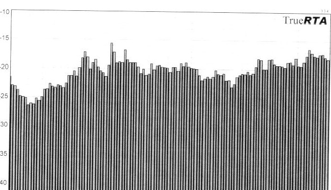

Hi all,
I have been playing around with some RTA software, not completely competant with it yet, but it clearly shows the rolloff of the original cabs and the BBC dip in the new XO. My environment is a little noisy, you have to disregard some of the small peaks. This is 1/12 octave averaged but not smoothed. I think I'll be at this for a few days yet.
Bill
Bill
High Karl
Thanks, yes, running the original XO. I am very happy with the sound of the speakers as they are. I can possibly understand why some may not like the level of brightness the Thor's are voiced with, especially if they had the previous cabinets.
They are typical Scandanavian speakers, which some (including Dave I am sure 😉 ), would describe as clinical & sterile.
I enjoy the sound because good recordings sound brilliant and bad recordings are outed for what they are. Usually people associate good recordings with classical & Jazz etc, however I have found a number of newer "pop" albums mixed pretty well. Jason Mraz for example or the Black Eyed Peas - Elefunk. OK, OK I know - I am not right up to the latest with my listening tastes 😀 These sound mellow and mild in my system
Put in something like this Leona Lewis album (if you can call it that) and the system is transformed into a screaming banshee. This is the approach to music that I take though. Others take an approach of wanting to make everything sound good, but then, for me, those special recordings don't shine like they could. Just my opnion and nothing wrong with either approach.
Maybe we should have both crossovers installed and a switch to switch between the two depending on the mix being listened to 😉
I will be trying the new crossovers or active at some stage in the future. Too much work ATM though, so likely that will be a project for next Christmas.
