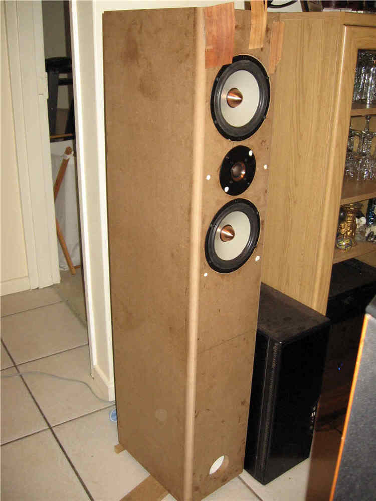

The main construction has been finished.
Perhaps just a word on my setup before I give my opinions. I run an HTPC based setup, with an EMU1212m running with ASIO through foobar as source. That is fed directly into my leach power amps.
VERY happy with the resulting sound. Bass is present in large quantities matching my Jamo D 590's, but it is a very different kind of bass. Very defined, tight and smooth.
Mids and tops are also good, but then that was to be expected. I don't hear any of the harshness others have described
Will begin veneering tomorrow

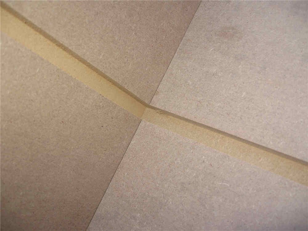

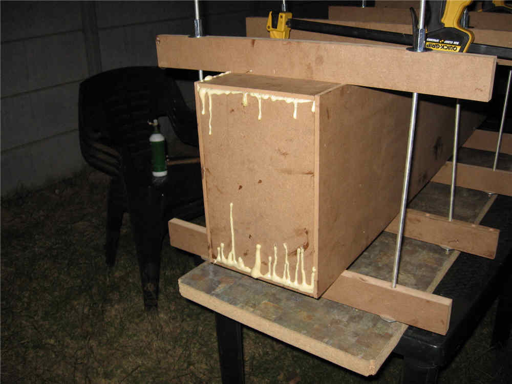

The cabinets under pressure.
I dont like sash clamps, so I created something similar to what we used when making office furniture filing cabinets etc
I used a polyurethane based glue, hence all the overflow.
Very difficult to work with, but very sturdy glue

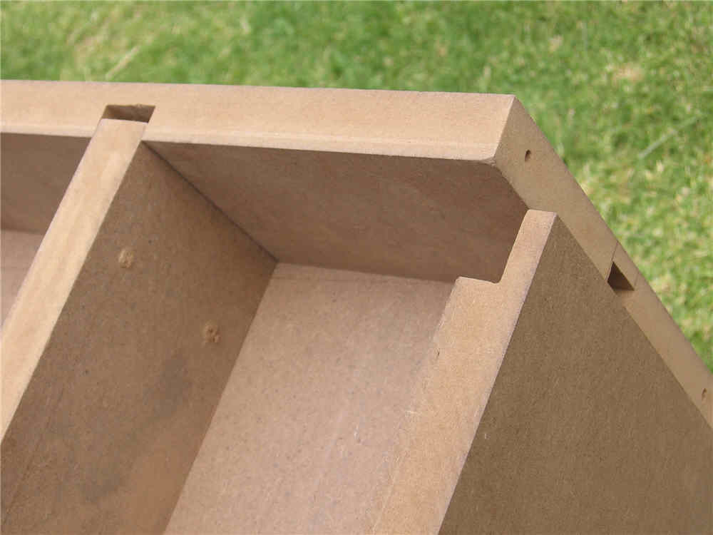

Byrd said:The interlocking panels.
Thats some serious work. Impressive.I relied on the glue.

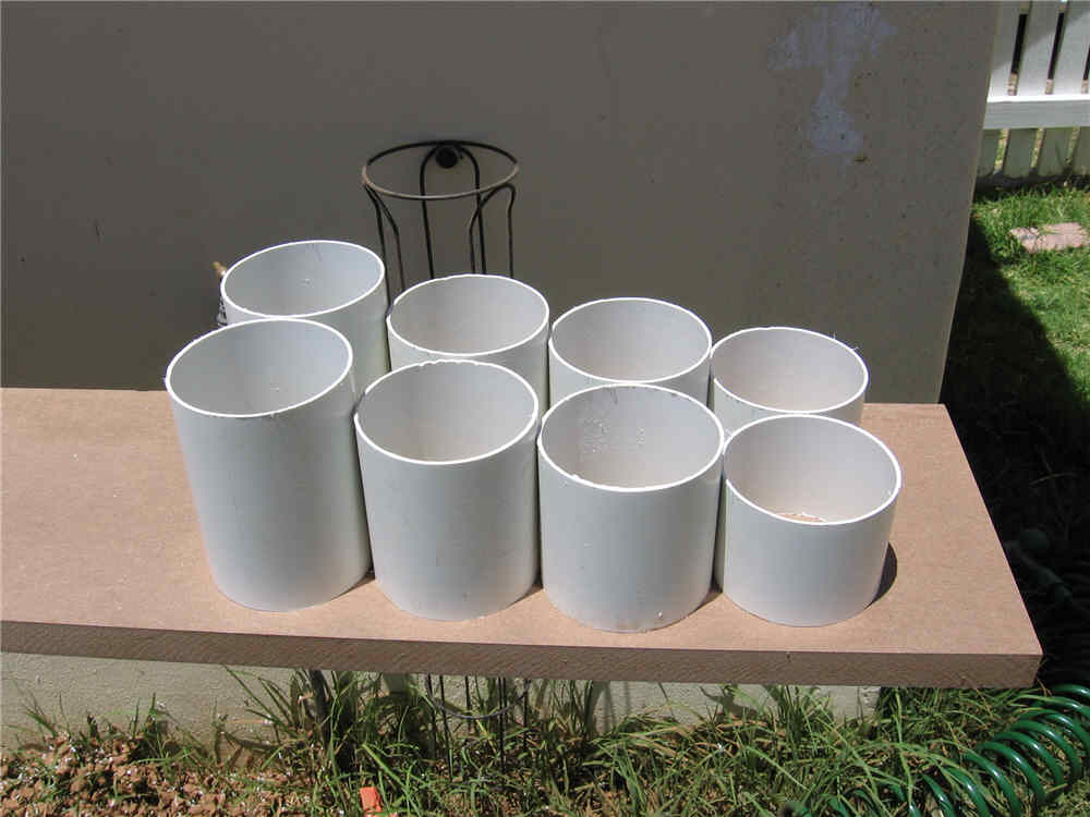

Byrd said:Cutting the ports. I hate hacksaws, never get the cut straight
Me too. I used this.
