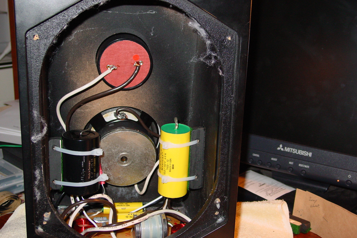

Here's a pic of a 1200V Mundorf Silver/Oil 6.8uF cap in an Ensemble Ref. speaker. I had to locate it off the xover board and up the side of the cabinet. However, the customer loved the sound regardless. The Mundorf is on the left and a Hovland cap is on the right.
Very nice, speakerdoctor. But you can try dampening the cabinet with acoustifoam and maybe locate the capacitors further back as to not block the backwave of the woofer.
Mundorf Silver/Oil is actually quite compact for an exotic. The Clarity MR caps are 2x bigger, and the teflons bigger still. Values of 6.8uF would be way too big and expensive.
The cabinet is jam packed with polyester fiberfil. I don't have the speaker any more. Like I wrote, the customer was extremely satisfied with the result.

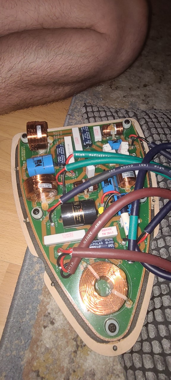

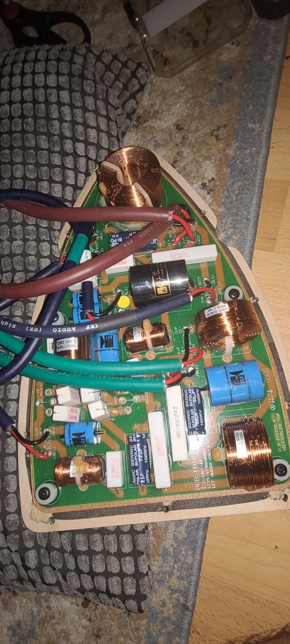

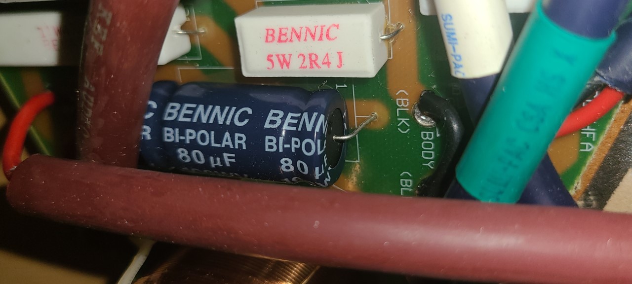

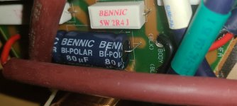

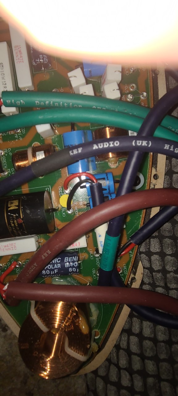

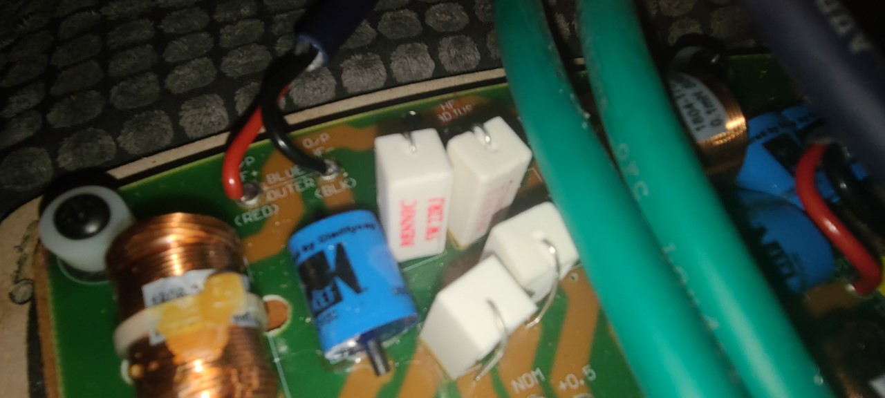

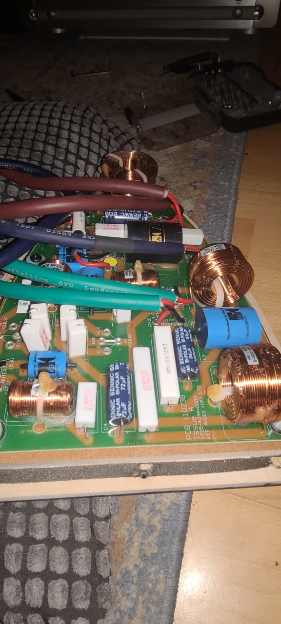

Hi! I figured I'd just try and tack onto this thread rather than start a new one. Hoping someone could recommend a good capacitor to replace these on this pair of Kef Reference 201/2 Bookshelf speakers. Also would it be worth changing out the resistors? I know some people would say that different caps dont sound different. Not here to debate that...
Its a true 3 way design with a coaxial tweet/mid combo and a 5.5" woofer beneath.
Frequency cutoffs are around 350hz/2500hz
Ive uploaded some pictures. any advice welcome !
