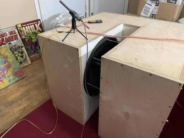

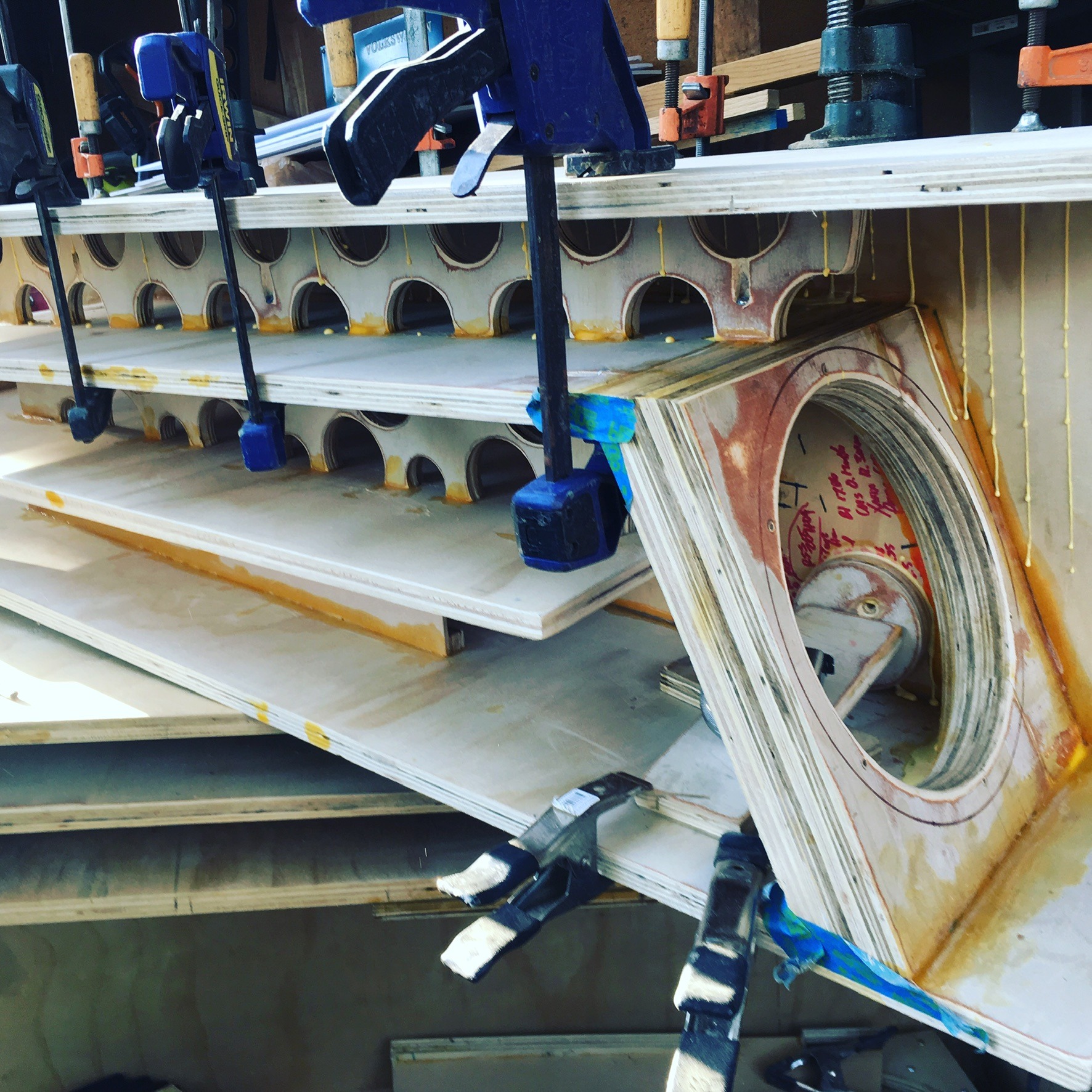

Sealed...the slot is the vented section, so it is essentially 4th order bandpass.
I placed a board across the top, to take measurements, above. The midwoofer enclosure will be that baffle in application
Theres no damping material in it either. Taken in my living room I'm sure the the room is in there somewhat. 90 and 70 hertz is the room I think.
Theres also some screws not in place in the back wall, if that matters...

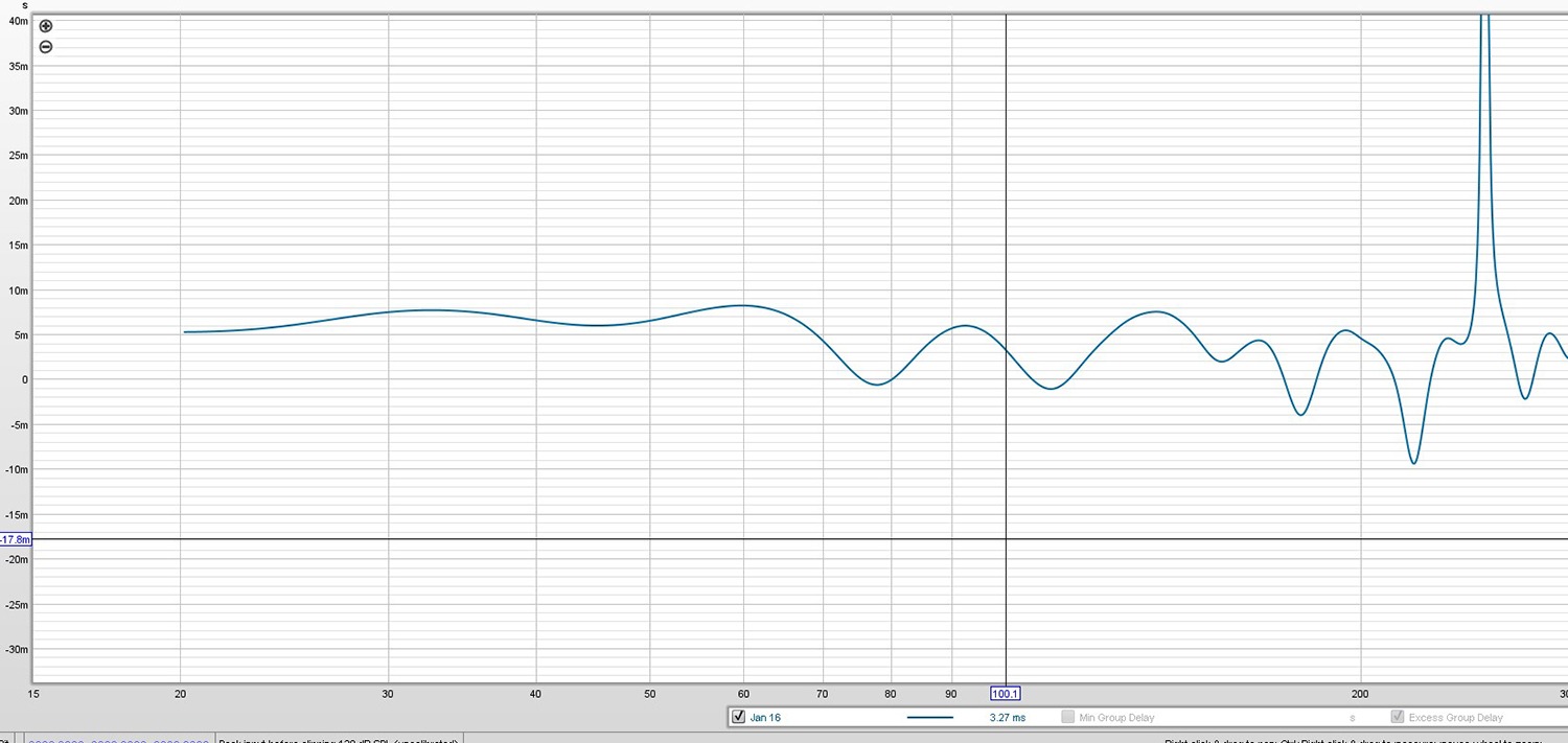

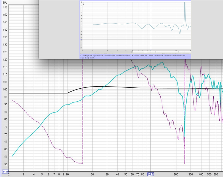

If I change the right window to 50ms I get this result for GD. OK I think I see, as I lower the window the results are limited but I loose more room.
Camplo,Taken in my living room I'm sure the the room is in there somewhat. 90 and 70 hertz is the room I think.
Considering how closely your measured response matches the Hornresp simulation, I'd think the small dips around 70 and 100Hz are in the actual driver response, since the measurement was taken "maybe an 1inch in front of the slot in front of the drivers".
Group delay is a fraction of a wavelength for most of the response, other than the narrow slot resonance dip, where it increases to over 10 wavelength duration, fortunately we can't hear what has been canceled ;^)

Late to the party on this, but I built my first PPSLs nearly 20y ago. Mine did not have the rods across the plenum because that would have made them a motel foxtrot to build. As they were built as PA enclosures in the first instances, the plenums had tops and bottoms, and after the plenum dips/peaks were obvious in the first measurements, the rear wall of the plenum was made rounded. There was the vertical rear wall and then up and down from 9 o'clock 2 short walls each side at 30* then 60* from vertical. This braced the plenum very well and meant I could load drivers through the plenum, but it wasn't a job I relished and only did it to check drivers that may have been overdriven when rented out. Otherwise they remained in situ until the PA was sold maybe 7ya. In the final versions, the plenums were made as shallow as possible, yet still practical and the plenum mouth being >2x total Sd. Mine were also narrower and taller as I had to move then through doorways.
Most of mine were built with JBL2226s (some had RCF 18P300s which were heavy as expletive) and none of the ports were loaded into the plenum, rather exiting through the front baffle.
With the rounded rear plenum baffle, the response peak/null was much lower than sims I did later. At the time my measurement suite was not as good as today and I lost the old measurements, but they were mild and easily EQ'd. With the 15's they were crossed 4th order active about 200Hz, I think 175Hz from memory and high passed at 40Hz, again LR24. If I needed more SPL, I stacked multiples. Got lots of compliments on how clean the system was.

Hi guys. If 70 and 90 are slot modes, I'll take it. I thought it was going to be worse. Call it my sacrifice to the vent gods, in order to receive the blessings of the slot. If Brett likes then it must be an acceptable configuration (PPSL)

I can claim nothing re these as all I did was follow the advice of the late 'djk', here and initially on AA. 6th order porting used on all LF cabs in the PA and have used it on domestic speakers several times too, most recently the surrounds. And my bass guitar cabs.
I just go my mids up and running, happy to say the same notes 70 and 90 are there...The response I've gotten from the PPSL looks promising, lets see if I can make it play nice with the mid.

Someone suggested putting a baffle down the middle of the slot, to separate the two woofers… What do you guys think about that?
The measurements have been so good thus far, I haven't really thought twice about it.
you can use a higher crossover frequency. Depending on the use case this might be pointless though
Depth of the manifold determines this so a baffle down the length (depth) of the manifold won't make a difference. I do have actual experience of designing, building and measuring these types of enclosures.you can use a higher crossover frequency. Depending on the use case this might be pointless though
äeehm sorry you are totally right. I dont know what i was thinking. I have also just recently built a ripol but somehow i confused that.
edit: do you know btw any good sources about the nature of the resonance? when i was researching i figured that it actually must be a helmholtz resonance which would mean that also the volume of the cavity matters. But all i find are vague statements
