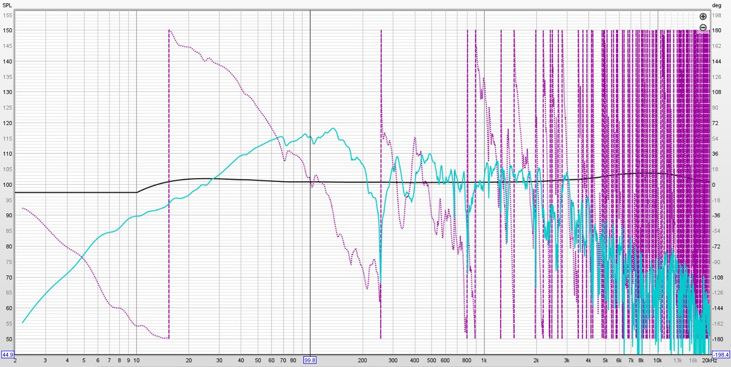

Is this PPSL even worth it for me? The 18H+ has all the useable upper range that gets high passed due to slot resonance/cancellation...

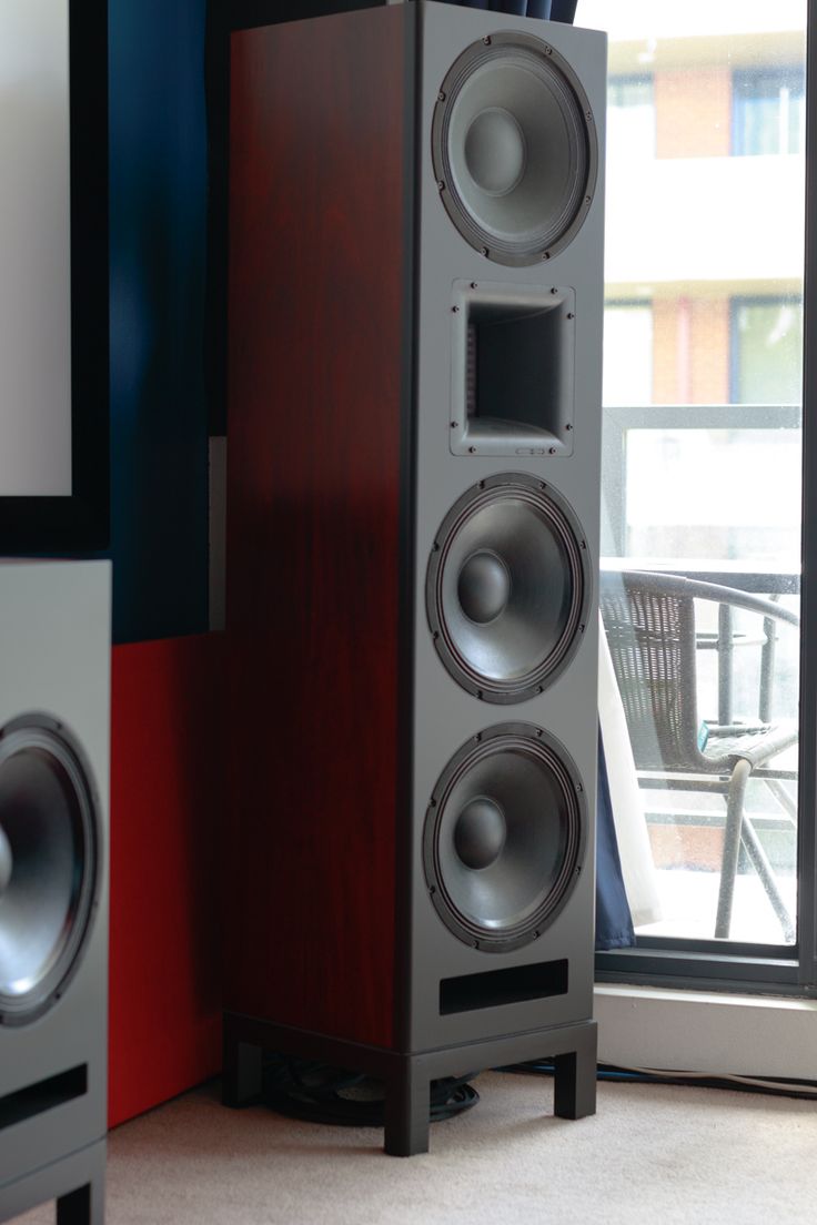

I was thinking I configure like the pic up top.... with the 15m on top and the 2 18h+ on the bottom..... MTMW...yes I know its not traditional but I think it would work fine...I end up with a little lower group delay around 100hz..... The efficiency through most of the bass increased greatly as the bottom woofer can help out much higher being out of the slot.....
The bottom woofer, low passed at 35 with a lr12, at xmax, in half space, is at 112db with 2db of help from the other woofers (no filters helping on the top woofers).....vs the 117db at Xmax in PPSL....
On the otherwise of the fence....I can create some nice wide polars on the vertical with the 3 way config....excursion is much less in the lower bass....
The more I look at the two sims the less differences I see. The two major differences are the major efficiency in the subbass vs the major efficiency in the rest of the bass....wether helped by another woofer in mtm of highpassed in a 3 way the 15m never sees much excursion in either setups....
I don't know what to think about that.....I think I just want a sanity check...and probably still with the 3 way...but I am not afraid of change
Someone say the wise words please.
The best I can think is that this PPSL was a wise choice and that if I want more efficiency in the midrange to add another 15m.... I'm just curious if I would even notice....the 15" should never reach past 2mm the way I have it set up....do I really need more efficiency there?

After modelling for a long I came to the realization the 3 way is actually more efficient than the mtmw.....
TLDR; with the 3 way, THe 15m gets to couple with 2 18H+....with MTMW the 15m only gets to couple with 1 18h+ and that made all the difference....The FR is janky where the resonance and cancellation are but. apparently the FR is still useable where it matters....like due to the high sensitivity in the midrange of the 18H+
I've tried to second guess this design more than a few times...the current configuration still is champion =)

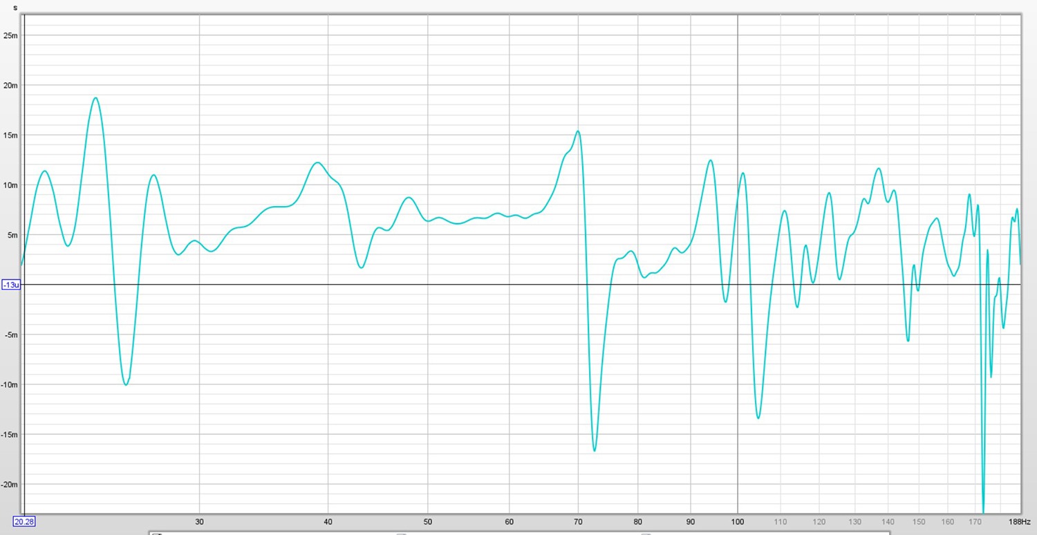

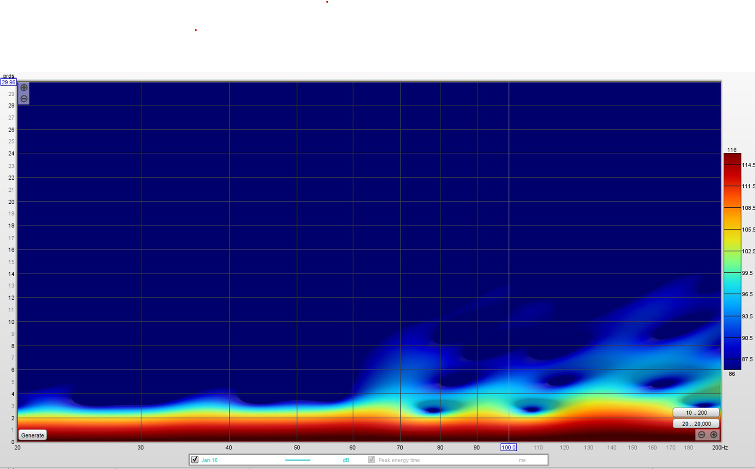

Sooooo....In HornResp....if I fill half the slot (innerside) with 53000Fr damping material (rockwool density 80) its showing the slot null totally gone....how trust worthy is that lol!
Me too...otherwise, everyone would be doing it already..........................or...has anyone tried filling the slot of their PPSL with damping material...or half it...or anything in between?
What are the dimensions of the slot ?
My >2’ tall slot had a resonance near 250hz (I’m approximating), but crossing at 80hz 18db, I never heard it.
29Hx6.5Wx20D
You should fill it with polyfil and take a measurement...if hornresp is correct...you can soften the peak get rid of the null
