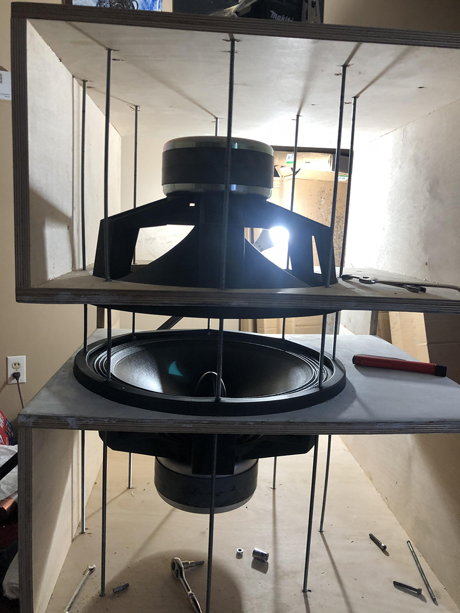

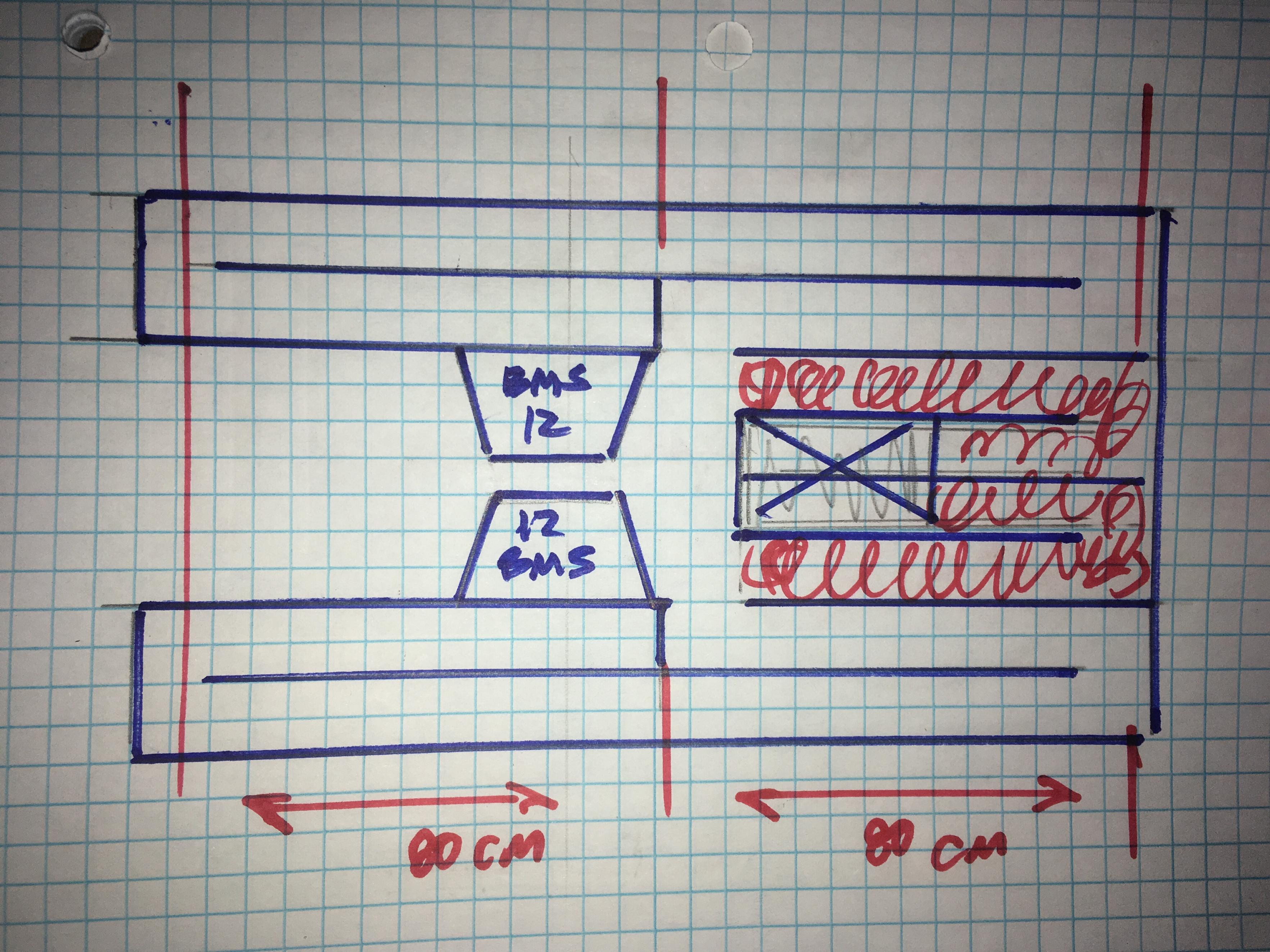

PLanet10 did ever build one of these or just make the drawing....lol....theres no way to readily manipulate the threaded rods...Im use a cap nut to drive the threaded rod and am going to have to permanently attach it to make it reversible... IM thinking jb weld or epoxy might be the trick...got any ideas?
I've tried threaded rods on opposed drivers. Its a massive pain! very hard to line everything up, they need to be tensioned and there was no noticeable benefit over just opposed drivers.
Was your build slot loaded? Any pics?
At the very least I can use what I’ve started and run threaded to the woofers but not cross the slot...
Maybe a wood brace or two in the gap or maybe not...but I like how the woofers back wall bracing is taken care of in the process.
Tension isn’t a problem if you use several threaded inserts in a row...I’ve binded and snapped and destroyed 2 threaded rods already along with 2 threaded inserts...the slight misalignment at each following insert causes tension.
Gotta go pick up a few more lock nuts and washers...but I definitely have to remove some threaded inserts because tension was too high.
Pain in the *** is an understatement lol

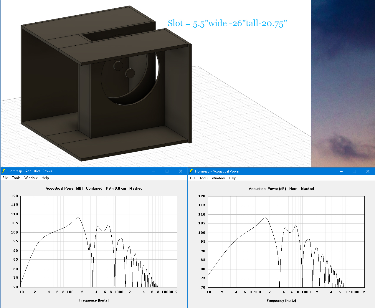

these dimensions are slightly off but the profile remains the same. Curious to what GM is talking about.

I can use the backwall of each woofer to create tension by removing the threaded insert and just use a nut and washer on the outside.
Can you all look at the pick and imagine the threaded bracing at each 8 mounting holes to the woofers backwall....from there wheres the nest important bracing....the large back panel is one stop but not much more bracing is needed if you ask me...but I'm asking you all.

Hey Court, if you remember Kirk from Martin’ s page he did this trying to freelance a copy of the paraflex/roar i did awhile back. But he had some kinda TS parameter issue or something and did the design offsett by s good margin (not good) and do he ends up playing around to salvage it but long story short was recent comments nit yet tested, where he was flipping polarity here on one driver back and forth and the suck and blow version(opposite motion is ‘an incredible audible’ difference and he did have a phone app with a imm6 which definitely looked great, but had nothing to ompare or reference it to(yet),,?
Never the less, it sounds intersting as i have the same basic layout except fir akl that offsett to the middle and ‘stuffed area’.

So I am back for some reassurance...I got a thread in installed....the thread is slightly magnetic now....is this an issue? Being that I have 7 more to go?
Camplo: A nut is missing!
You have to do it again. 😀
DOH.... you have to do it again! ( don't you wish mono to be the norm now?).
LOL! omgoodness....I got one thread in and secure, on the second one, I'm calling it a night lol...take notice to the 1.5lb of mortar on the each driver baffles (the white stuff). This stuff will be sculpted onto the other baffles when the time comes. I came up with this mortar to achieve a certain look but at ~1/8th inch,do you guys think it'll help dampen the box? I don't see much of a need to brace on the vertical as the dimensions are narrow (12") (the box is pictured sideways)....the rear wall is 32wx29h so I have plans to run bracing up the middle of that to the middle baffle between the woofers...I also will have to cover the rods with something thick...maybe a thick "tar" like tape...because I had to install the woofers first I am not sure if I will continue with the idea to coat the inside walls but if i am careful it may be ok...opinions?
