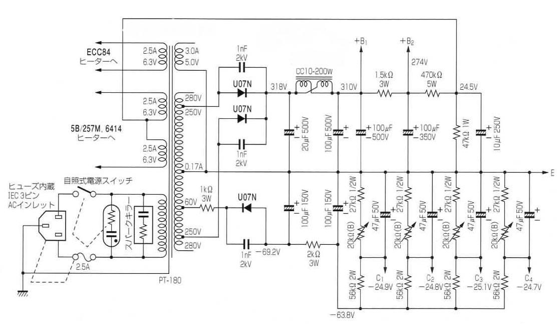

Here's an offbeat Japanese design that I'm going to try this winter. I'll use a 272JX and with SS rectification and should have about 350 volts B+. The JX has lots of filament current for KT66s. The output tubes in the Japanese circuit are more or less a 12-volt loctal base 6L6GA or GB, so KT66s aren't too big of a leap. I'll be using 7581 or 6P3S-E outputs. Don't be choke-averse. They don't cost a lot and can help.

@ Steve, that looks like a cool amp!

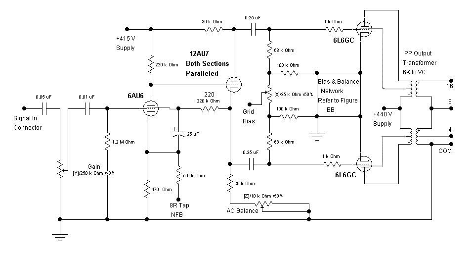

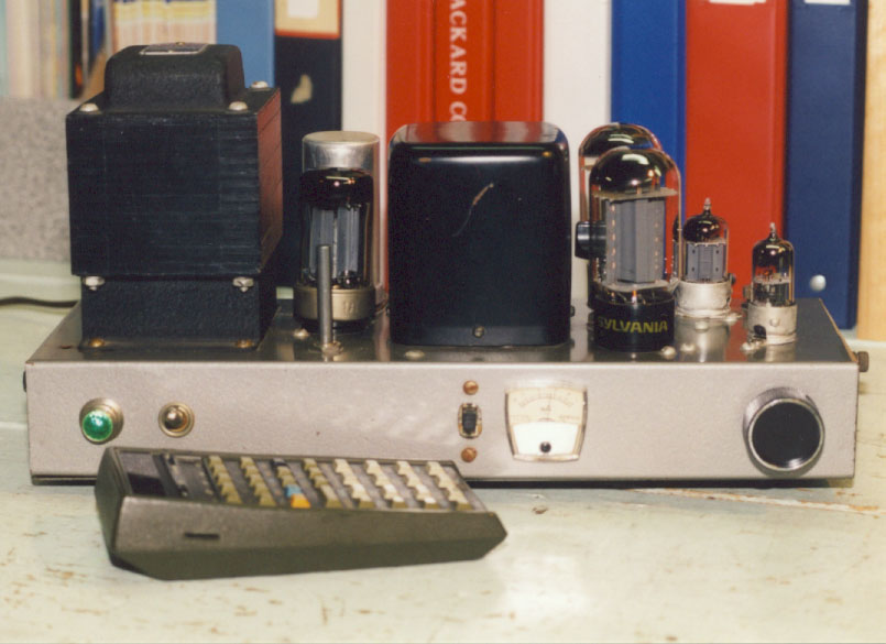

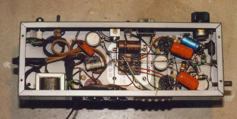

Here are mine, two of them built in 1960, PP 6L6GC UL.The Hammond 278X would be ideal
6AU6 front end into a paralleled both sections of a 12AU7 driver.
Each have their own Hammond 273BZ PT & GZ34 Rectifier.
Used for 17 yrs till I bought a Sansui AU717 & matching tuner.
@jhstewart9 , I assume you meant 273bx, no? I just read a little about au717 from back in 78! Still a sought after piece!
The monoblock amp in the pic looks nice and 70's calc is a nice touch!

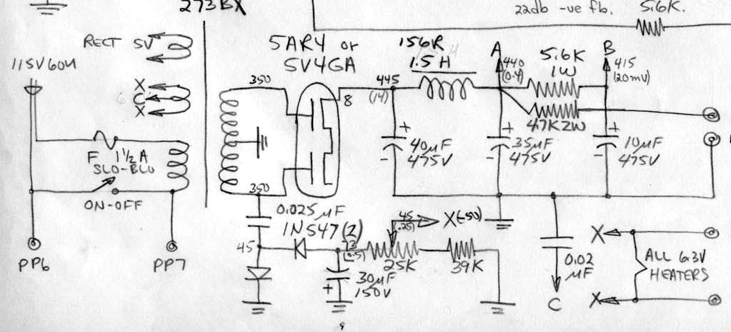

The 274BX works great with a 5AR4 rectifier. The 278X will work well with a 5V4. The Williamson is flexible--anywhere from 400 to 450 VDC B+. Up to you. ;-) I prefer a tube rectifier but the Antek with SS diodes gives you a bit more "grunt," of course, without the sag in the PS. The nice thing about the Electrohome circuit is that they have the feedback and compensation dialed in for those outputs.

About the power transformer, I use a 372jx (110...240v version of 272jx) in a 28W stereo amp, solid state rectifier, no choke, gives 405v as idle (190mA total).

The HV filter is 40 microF, 1.5H, 35 microF. The choke is a Hammond 153 buried inside the chassis.
The PS ripple is 0.4 v p-p. The OPT is something brought in from Japan labelled REX. It came with a freq plot.
There are both AC & DC balance pots as well as a bias pot in the circuit.

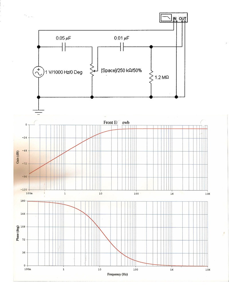

The front end is a 2-stage HP filter to block LF transients that would cause serious intermods
to the rest of the program material should the amplifier or loudspeaker be overloaded. Something most ignore.
The 2-tone IMD test was done using a PicoTech 3224. 👍
