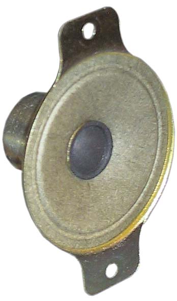

Nuuk said:So probably the most practical solution is to add a tweeter in front of the main driver. What particular tweeters are suitable for such a job?![]()
The Ciare is a 4-ohm driver.
You ideally need a small tweeter, with a small magnet (typically neodymium), AND a tweeter that's sensitive enough to be used with the Ciare.

Thanks Carlos. Actually, although this is the Ciare 250 thread, I was thinking more about my Goodmans 201's (8 ohm)!
Nuuk said:Thanks Carlos. Actually, although this is the Ciare 250 thread, I was thinking more about my Goodmans 201's (8 ohm)!![]()
Aaahhhh...
Well, on the cheap you can try this one:
http://www.visaton.com/english/artikel/art_383_1_8.html
Above ~10Khz (where it's needed) it's quite sensitive.
At around 10€ each, you don't risk much to try it.
