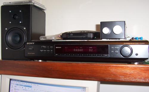

Do you have the tweeters close to the Ciares?
It can be problematic if you have nore than a few cm separating the two drivers.
My Visatons work fine with a small (super) tweeter, but there's only 1cm separating the two drivers.
The enclosures are not very perferct, I was on a slippery day.😀
Yes, but with 10 and 12 inch drivers the centres can never be close (unless you mount the tweeter in front of the woofer)!
