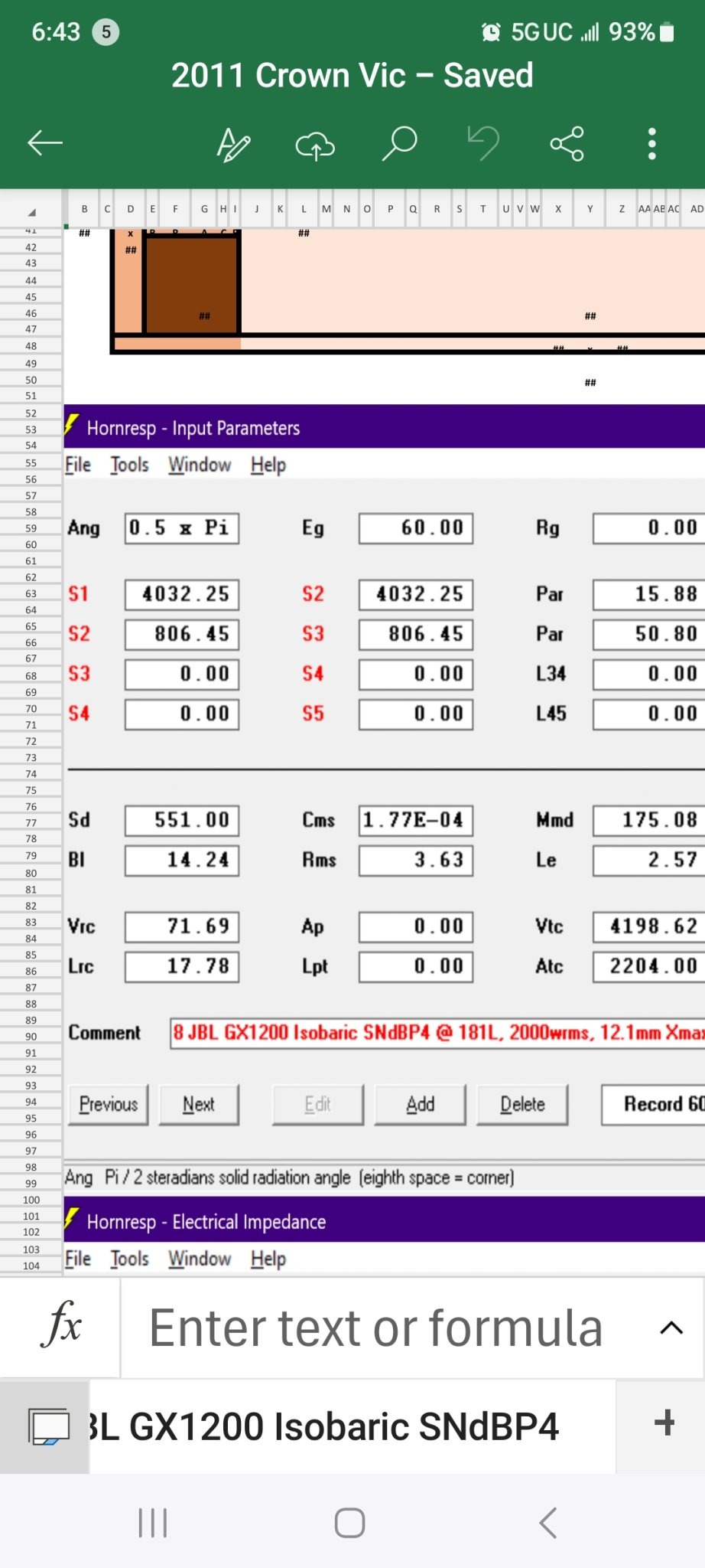

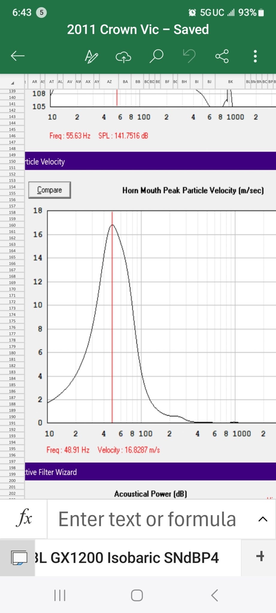

When I saw the presentation on ports by DIY Audio Guy, realised that the 180cm2 recommended by guys here is the optimal for output but also that it was a function of Vd. So I messed with port with a driver volume and port with no driver volume (TL) in HR until I found a compromise at 130cm2 for 31.4Hz that eliminated most of the peaky dips. This appears to be controlled entirely by pipe length to diameter and taper rates.
What are the throat and mouth velocities at 130cm2 with max voltage at xmax?
