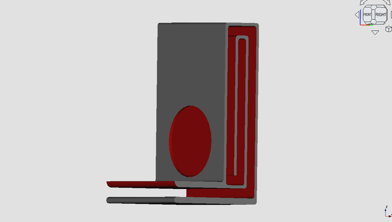

The other thing is, starting with the original post, this thread is about an auditioning box based on a BR system. All my studies so far indicate that the port is a function of cone displacement and a TL is the way to go and one that can come back and bite itself is better. The driver displacing more down this tube will have a higher output that is cleaner than a poor aspect ratio port
The only parameters that matter for the physical box design is cone Sd and Xmax, in other words Vd
This port only system has problems though. At the 183cm2 suggested by BP1Fanatic, the output is highest, but delay along the upper sub band is high. This is independent of which driver. This is a length and Sd thing
The 130cm2 Sd with scoop exit that was my final tapped TL auditioning model hit the spot with the best tube performance in all the graphs. Plus it looks good
But it still leaves a question mark if a BR is possible. We have to remember that the BR port again at 1803cm2 is way too long for a 30L box and increases overall size out of the desired range. So a traditional port is not an option. It seems like I am the only one curious about how to solve this. I have a number of drivers from 6.5" to 12" from DS18 and others to try to find which is the best fit for the largest 4x boxes that I can carry and store

I have prepared a 30Hz ported design to audition with and the TL version which Hornresp shows as better use of the components in the physical circuit. But I have an unresolved issue that is preventing an immediate start with the BR design. This as I already mentioned is about how to accommodate the HF drivers. The TL version below has the space for this, but I really want a BR for the initial box

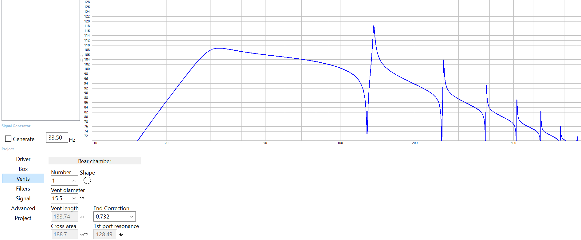

Guys, it would be a refreshing change to work on this without the didgeridoo talk. Folks keep suggesting 180cm2 port Sd as minimum and making the assumption that I am ignoring good advice, so let's dissect this. Maybe I have a misconception that the following would be a poor port resonance performance
Here is the recommended widish port. I have increased Vb to the stock recommendation of 38L for ported and 32hz tune for the sim. So please explain why do you folks recommend this response over the clean and flat output graphs from the original post BR concept. In other words, and quoting and earlier such remark, why recommend the wheel over reinventing it? This response is with a 100Hz filter
That seems like a bit much for such small Vas, you can also tune a bit higher, to reduce the port length. That will reduce your unwanted outcome, while still giving good 30 Hz performance.
  • Simulation programs often exaggerate peaks and dips of that kind. So the fact that you simulate it doesn't mean it's going to be there, or at least not with the same order of magnitude in real life.
  • You're comparing a simulation in HR to a simulation in WinISD, two different programs that will give different results, for the same input parameters (where possible). My suggestion is to simulate both in HR.
  • I would cross that driver a lot lower, say 80 Hz and 3 or 4th order. Again for a better outcome.
  • I tried to input that driver into HR, I got a lot of inconsistencies in T/S-parameters, Re, Mmd/Mms and BL seemed weirdly off. I would await DAT's outcome.
  • Like I hinted earlier, I've build so many subs of that kind, that your first post simulation seems way off without even simulating it. My experience with measuring those enclosures tells me that they mostly resemble a simulated rear loaded horn in HR, meaning Vtc, Atc, S1, S2 and L12. Use L3, L4 etc. to approximate the flare.

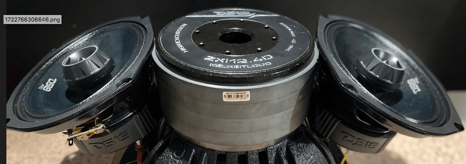

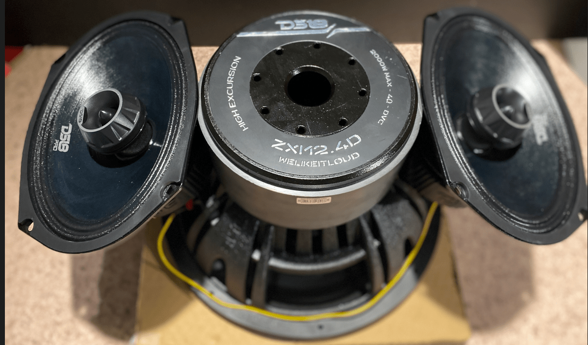

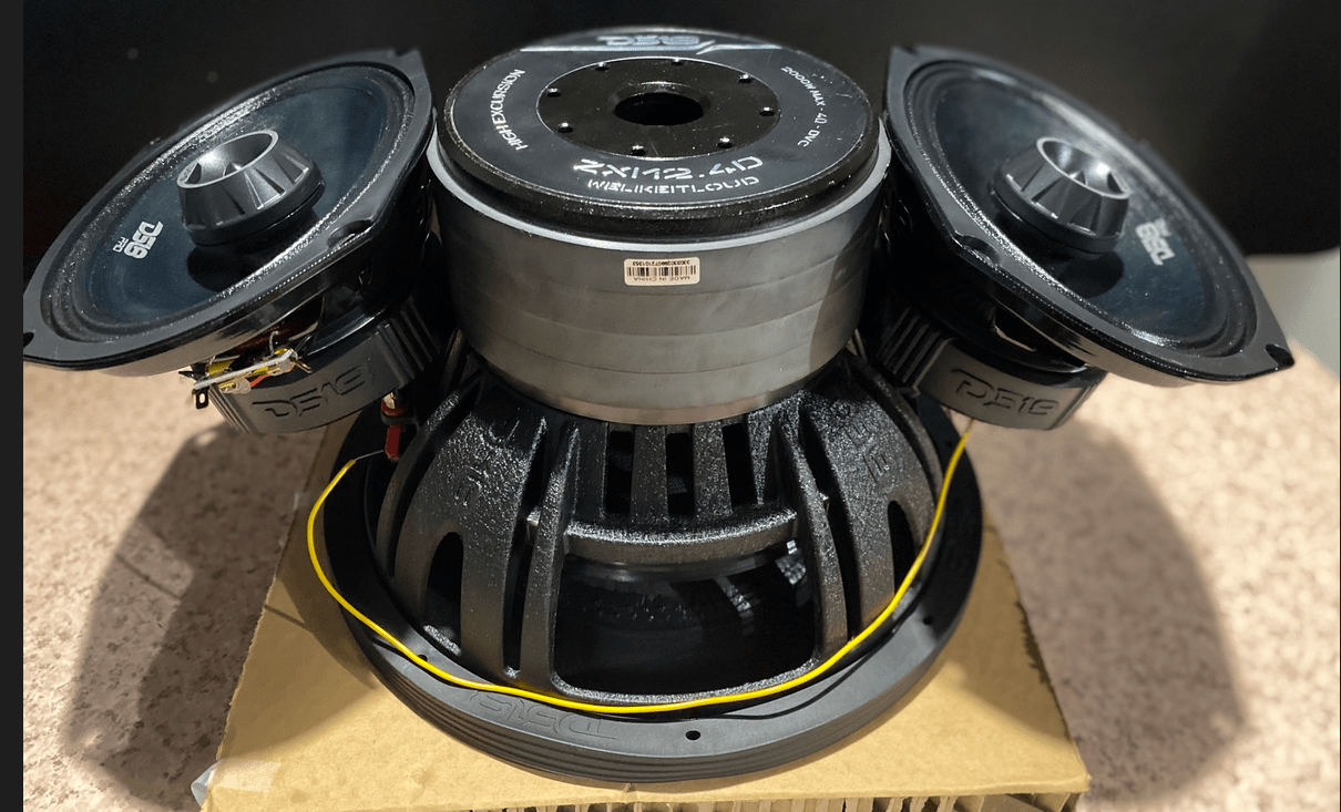

Continuing on with the three drivers. Creating some GA's show, a minimum footprint of 580mm x 400mm and minimum height of 600mm needed to accommodate the trio. This is larger than what I desired but accepted as compromise
Anyway, the old system will get used for the 7th Aug. A 30Hz box without pipe resonance issues is not simple to assemble, which makes it difficult to achieve a result with trial and error
These three need to go into the cab. Getting the racers in elegantly ina stereo pair is proving to be challenging.
Randy,
You won't hear any real stereo effect from drivers mounted in a 580x400mm cabinet, other than room wall reflections.
The angle they sit at looks about right to even out the beamy tweeter response with a mono signal, but the co-ax drivers should be placed as near to each other as possible to reduce comb filtering.

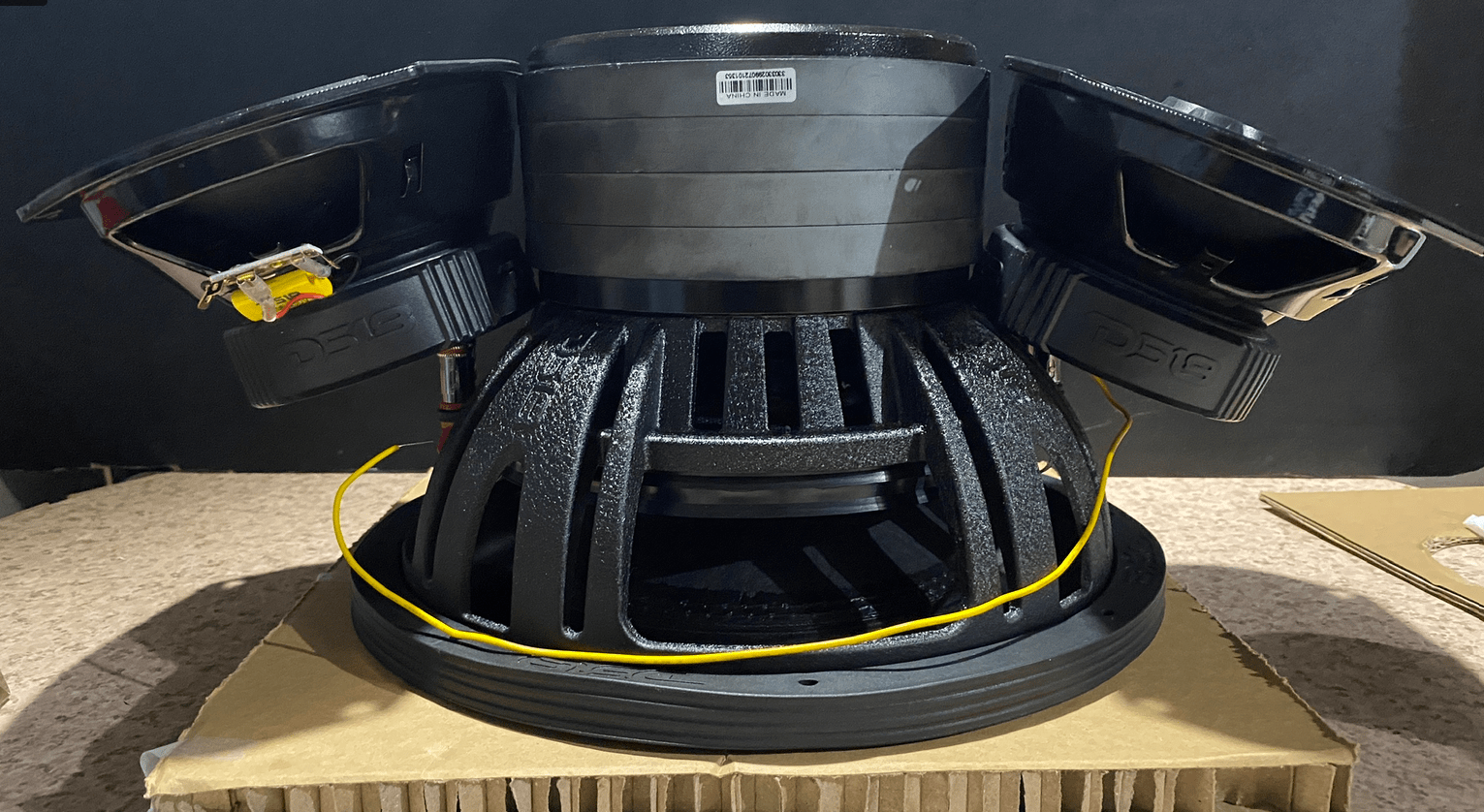

Have you listened to how much noise the subwoofer's rear vents and spider make at 70mm peak to peak excursion?
Art
Have you listened to how much noise the subwoofer's vents make at 70mm peak to peak excursion?
Yes, some are good and some sound like jackhammers. This one seems ok in free air but giving it very lil plugged in place of the 7". Don't want to tax that amp
