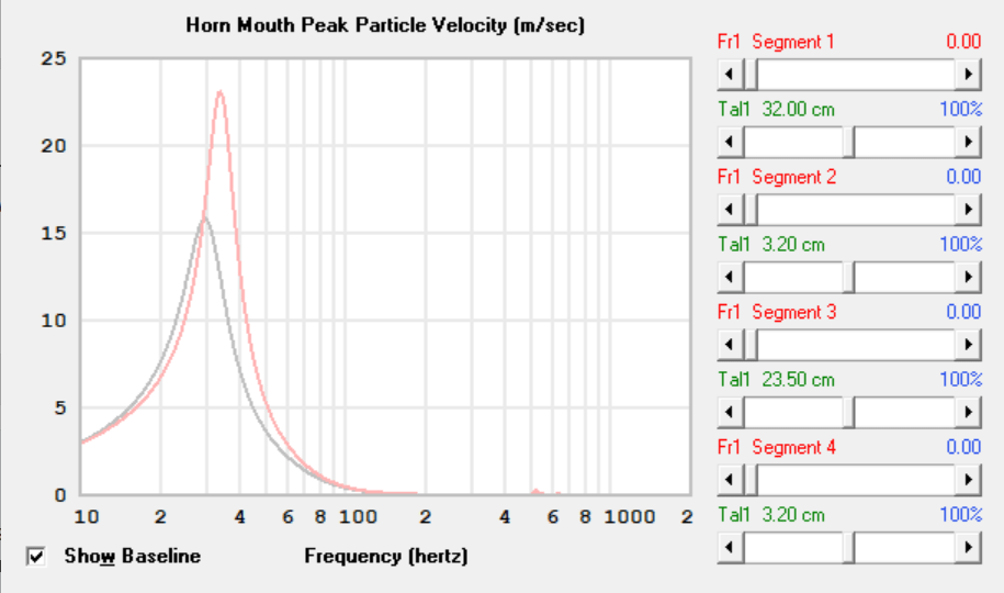

I don't have the design experience to properly translate this very spiky looking thing. I suppose this first design effort in real life will help build some context of what this spike would sound like
There is detail on dampening in the intro, 290g of poly. Below is the big spike in the graph. I read somewhere that under 25 is good? The red trace is undamped and black dampened. This is at 78.4v producing average 115dB

How bad are the undamped and dampened traces? I can't really tell

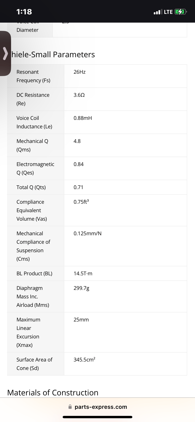

you’re using radically fake Ts parameters which make the already exaggerated horn response graphs and info even more ‘fake’ and misleading. its all ‘lies’, theres nothing to interpret or learn from imho
i think my pea brain is thrown off most by the tight suspensions affect on the enclosure size choices (fake ideas to solve issues that don’t actually exist?) but the crazy (fake) motorforce score is fighting a 700 gram moving mass….🤷♂️ suggesting you need super long skinny ports /TL shapes

https://www.parts-express.com/DS18-...rbon-Fiber-Duat-Cap-4-Ohm-294-8070?quantity=1
maybe experiment with this in horn response temporally until your dats woofer tester arrives ?
Why that one Booger? I have the ZR12.4D already. Previously mentioned as the other speaker on hand
Guys, let's forget about a specific driver. If what I see in from sims and modelling cabs is correct. Then the port tuning is a box to port function and doesn't use driver T/S. It's basically up to the driver to fill those two holes
If the driver is around 30Hz Fs then all should be fine other than the chuffing and pipe resonance issues which this shorter and narrow-minded port places over 540Hz. Am I getting this part right?
The very bandsaw friendly redraw port pipe Sd is 60 with even larger exit flare of 500 (500 Sd air piston driver?). Zero fill shows port speed below 25
Because those are ‘real’ parameters instead of the random bizarre stuff you keep postingWhy that one Booger? I have the ZR12.4D already. Previously mentioned as the other speaker on hand
That driver shows the same BL/Qes anomaly in both WinISD and Hornresp. And I have both here, it's tiny compared to the ZXI, I think the ZXI magnet is 5kg heavier
I think the programs are showing either incorrect BL due to either drivers not being broken in for measurements or someone at DS18 not configuring Qes correctly for the datasheet with all the DVC drivers. The DATsv3 will be here by Wed. Let's get a box ready to break the driver in and initial testing. Sealed is out of consideration
Correct, you don't need any driver data in HR to design/tune a BR, though need the driver's specs to determine the area of the port.Then the port tuning is a box to port function and doesn't use driver T/S. It's basically up to the driver to fill those two holes
