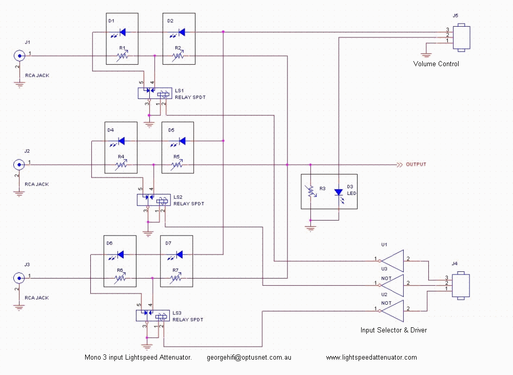

The Lightspeed Attenuator it's main criteria was to get rid of today's volume controls with the light contact between the wiper arm and the resistive track.
This is also the reason for only one input to get rid of the source selector switch which is another wiper with a light contact.
There was a way posted many moons ago to make a con-tactless source selector, using again LDR's and relays, but it was too much cost and trouble.
Cheers George
