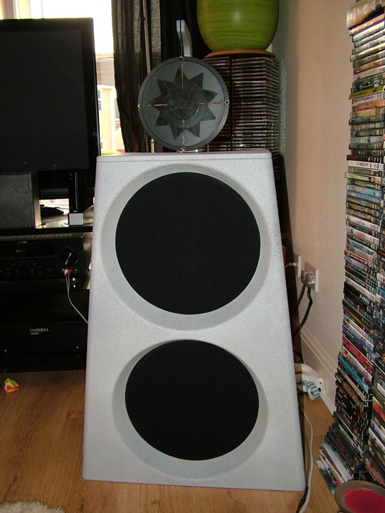

Matching PHL mid range
Hi Kev,
The Beyma TPL / AMT high frequency driver matches the efficiency, speed and dynamics of the PHL Midrange...Nothing else this side of a compression driver and horn can keep up.

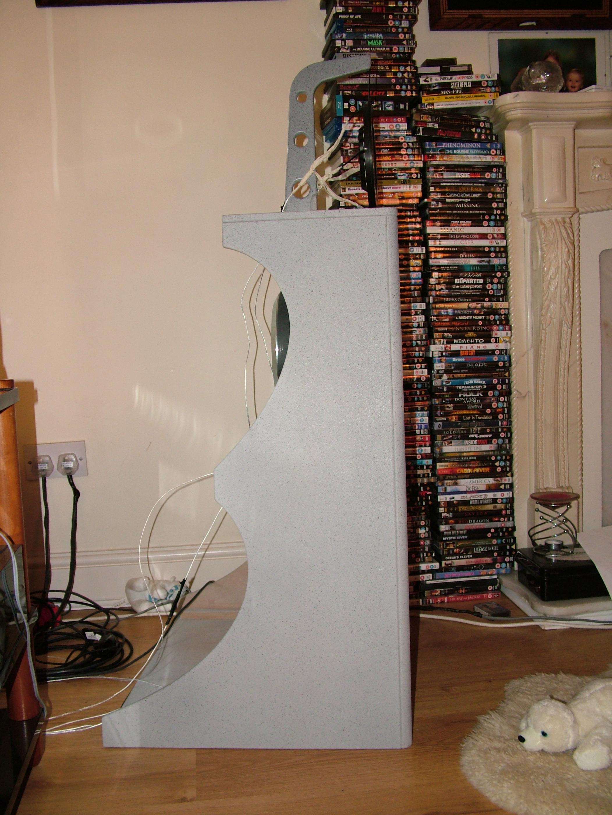

For bass... If you have the space for an open baffle try a Precision Devices PD 1550 in a VPL baffle ( pic attached) or if you cant manage 4 or 5 feet clear behind the speakers try a sealed 60 litre box with a Beyma 12SW1300Nd...both are great options.
Cheers
D.
Hi Kev,
Cheers
D.

Derek, very nice looking speakers there! I must admit that I was thinking of something a bit more conventional for my first serious build, and as simple as possible to use in less than ideal room position, but maybe one day I could aspire to something like that....
Cheers
kev
Cheers
kev
Simpler than they look...!
Hey Kev,
You are right, Keep It Simple to start and see how it works out, the open baffle speakers are actually easy to build, but take up too much room space....
The simplest and most flexible build to start out is 3 sealed boxes stacked on top of each other...
Bass - 60 litre sealed box for the Beyma 12 inch driver. 30Hz to 300Hz (ish)
Midrange - 4 to 6 litres sealed box for PHL 6 inch 1060 ( 350Hz crossover) or 8 inch 2540 ( 250Hz crossover)
Tweeter - Beyma TPL AMT driver in small sealed box.
Experiment with your active crossover slopes and points and your done!!
A few details worth including...
Fit good spikes to the bottom of the bass cabinet.
Use a 10mm thick sheet or coaster sized circles of Sorbothane to separate / isolate the mid cabinet from the bass and the tweeter from the mids.
Use Twaron internal fill for the midrange cabinet.
Move the mid / tweeter cabinets to align the acoustic centres of the drivers.
Later on you can experiment with the TPL, remove the back plate and make a tapered 2 litre box with Twaron stuffing... All good fun and rewarding sonically.
Separate sealed boxes are the easiest to design and build, also the modular approach allows you to mix and match and easily compare different drivers in the future.
Cheers
Derek.

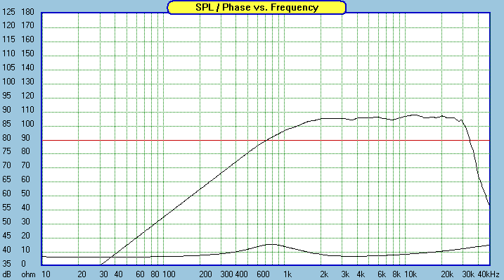

I've been continuing to investigate the scanspeak 10F and I'm finding all very positive stuff. So if this will marry with bass/tweeter options that I like, then it'll probably be the one for me, though with the Audax HM130C0 still up there in case it fits in better. Thanks for all the help 🙂
The F10 is rather smaller than I'd originally imagined; I'm thinking it should be crossed over a bit higher than my initial intentions. To keep things simple I'd like it reasonably flat to some distance outside the x-over ranges without any sort of clever compensation being needed.
Fs is 90hz and (in a sealed enclosure of Qtc 0.7) -3dB is around 180Hz, so 2-octaves above Fs or 1 octave above -3dB is about 360Hz. I'll be using 4th order active X-overs; would something like 360-400Hz seem like a comfortable lower crossover?
The upper X-over seems to be pretty flexible; the flat range is quite high, so its probably the off-axis deterioration that'll limit it for me. Possibly 4kHz at most, but ideally 3kHz seems reasonable?

I would think it would be closer to 3.5k, don't have one physically in my hands so cannot test. Would make a good starting point tho 🙂
Seems reasonable enough, although it's OK here at 300Hz 24dB/8ve- it seemed comfortable playing louder than I would need it to! Ideally crossover low from the tweeter. The SB neo is not only very good- by reputation- but the small flange size reduces centre-to-centre distance so that you can experiment with a wide range of crossover frequencies, if you want to. Although I've not built using these, I have heard them in quite costly and excellent sounding complete speakers where they were clearly not a limiting factor. The HM130C0 is a good driver which I have used, but in my experience the 10F and the HM100Z0 are cleaner-sounding up top. I still think the '130 is a nice drive unit for a smallish two-way speaker though.
Thanks both, I think we're getting there! The 10F appears to be as flexible as I'd imagined (or more!), and so if I go for a tweeter that'll work from relatively low then it'll give me a lot of scope for adjustment - which is ideal for me as a newbie. Hopefully ditto for the bass.
