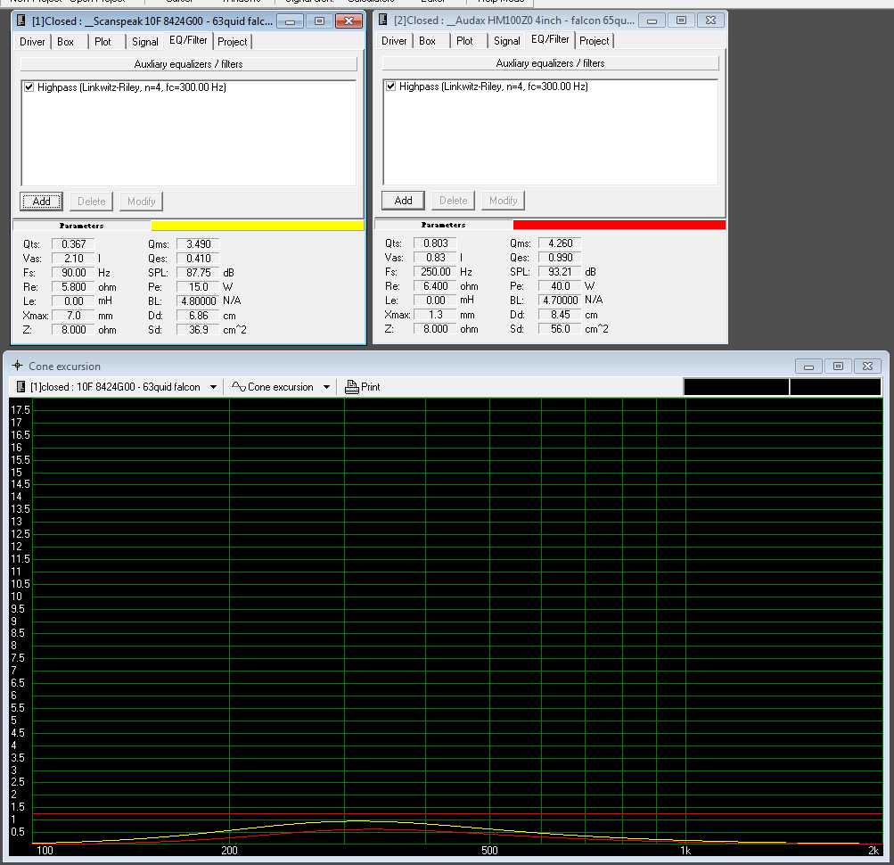

Possibly I have made a mistake as I am comparing the same frequency range (>300Hz), I'm certainly no expert.. I'd very much appreciate people looking over my logic if you suspect an error:
The 10F has (far) more excursion than some dedicated mids. But as I understand it from the basic simulations in WinISD, achieving all that excursion for the mid-range frequencies in a sealed enclosure of 0.7Qtc would require something like 400W, yet the driver is rated to 15W (30w peak). So I'm concluding that rather than Xmax, I should be looking to electrical/thermal capabilities as the limiting factor in this case, especially since it is rated relatively modestly and its not the most sensitive in the world either.
Importantly, I 'think' that this thermal/electrical cap on the 10F is likely to be somewhat below my chosen max SPL of 105dB@1m (before any sort of clipping, electrical or physical). BUT its very possible that I have not judged the relative power correctly...

Okay here they are:

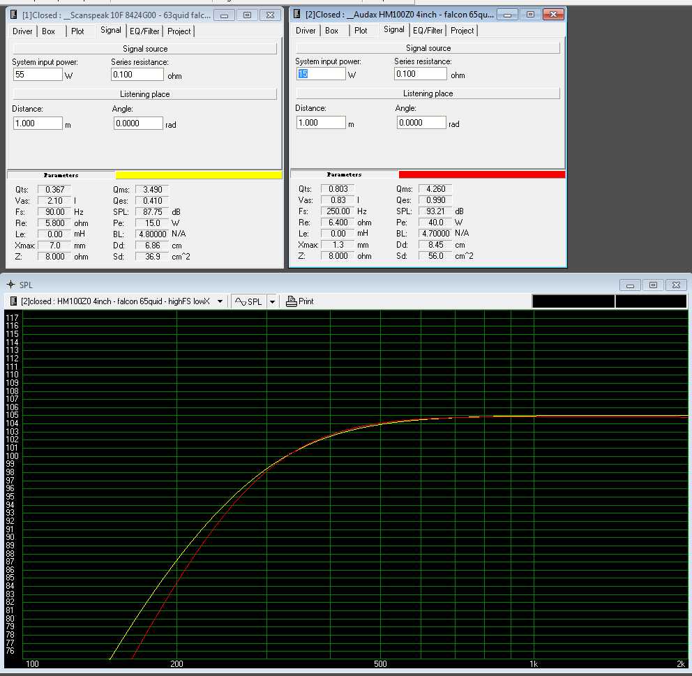

First the SPL chart - both the same, 105dB@1m
Second the Excursion - The Audax HM100 is about half its X-max but still plenty in hand, the F10 is of course only about 1/7th of its Xmax - so very easily okay. Both with 300Hz 4th order high pass.

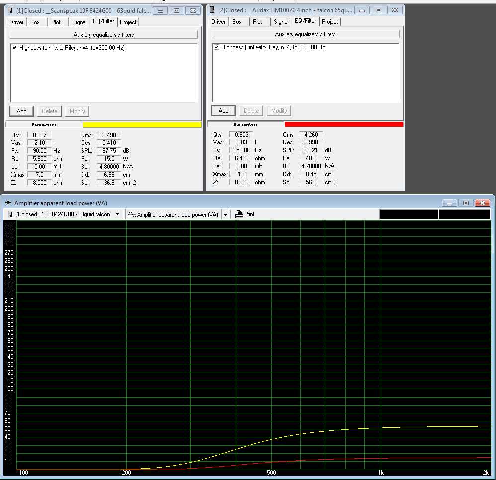

Third the power; the sensitive Audax is using 15watts out of a nominal 40w it can handle, so not at all troubled, but the F10 is using about 55W whilst it can nominally handle 15W, so a number of times beyond its rating, or nearly twice over even its peak rating.

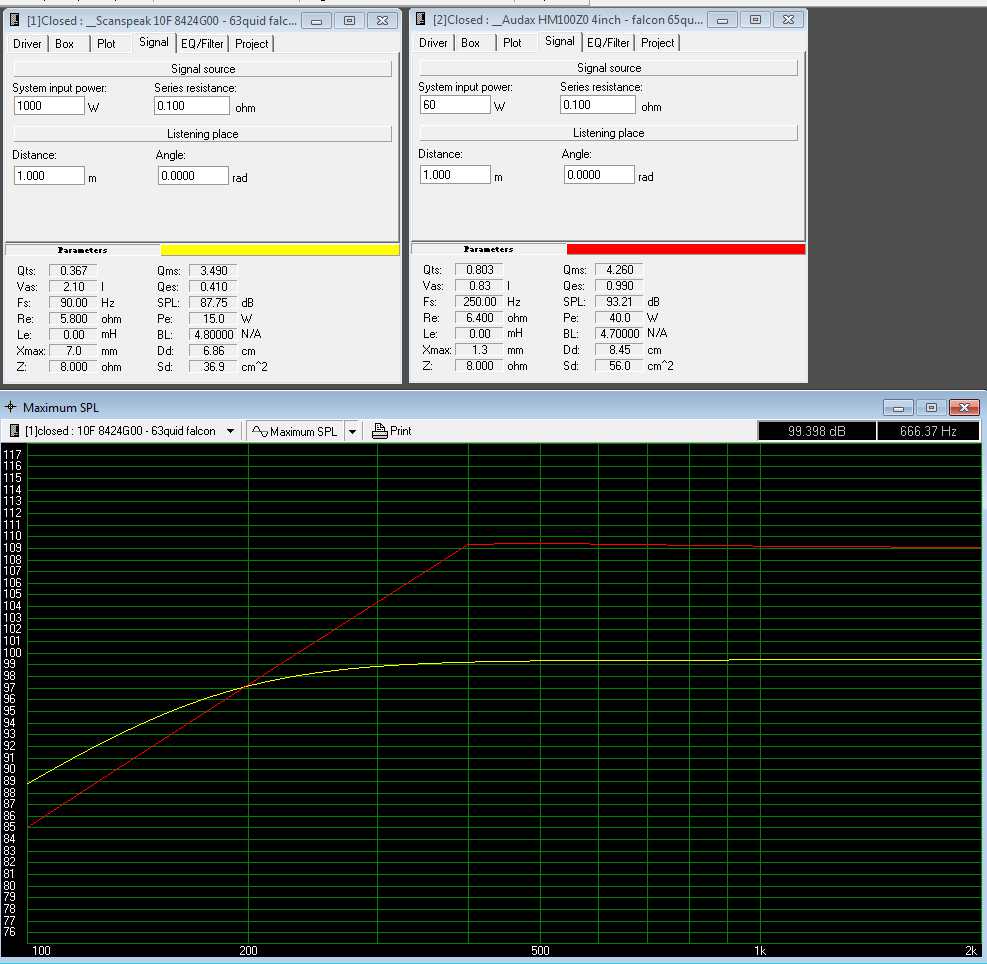

Finally the Max SPL. Note the Audax is reaching 109dB, whilst the F10 is reaching only around 99dB or so - the former is hitting its X-max, but the latter is hitting its max power far sooner (and in fact below my 105dB aspirations).
Okay so I could push the F10 beyond its power rating for transients, whereas I can't for the audax without exceeding linear travel. But the F10 would need an equivalent of 10 times its nominal power rating just to reach the same SPL as the Audax can reach fully within spec. Which is why I'm thinking that in practice the audax can reach higher SPLs even with a smaller Xmax.

I have put the two Scan-Speak drivers into WinISD and things look fairly sensible. One 5.5" driver is equivalent to two 4" drivers. Crossed at 300Hz both give an output over your target of 105dB with 0.5mm excursion at the rated power. 300 Hz is lower than typical for a 4" but you are crossing to what looks like a subwoofer. What might push you towards a 4" rather than a 5" is the performance of the yet to be specified tweeter.
OK.
The Audax is a lot bigger (the Sd parameter). If the cones are the same size they must produce the same SPL with the same displacement.
The Audax is more efficient (the SPL parameter).
If you wish to use a small inefficient hi-fi midrange then use 2 to increase both the area and the power handling. This is fairly common for DIY hi-fi designs.
